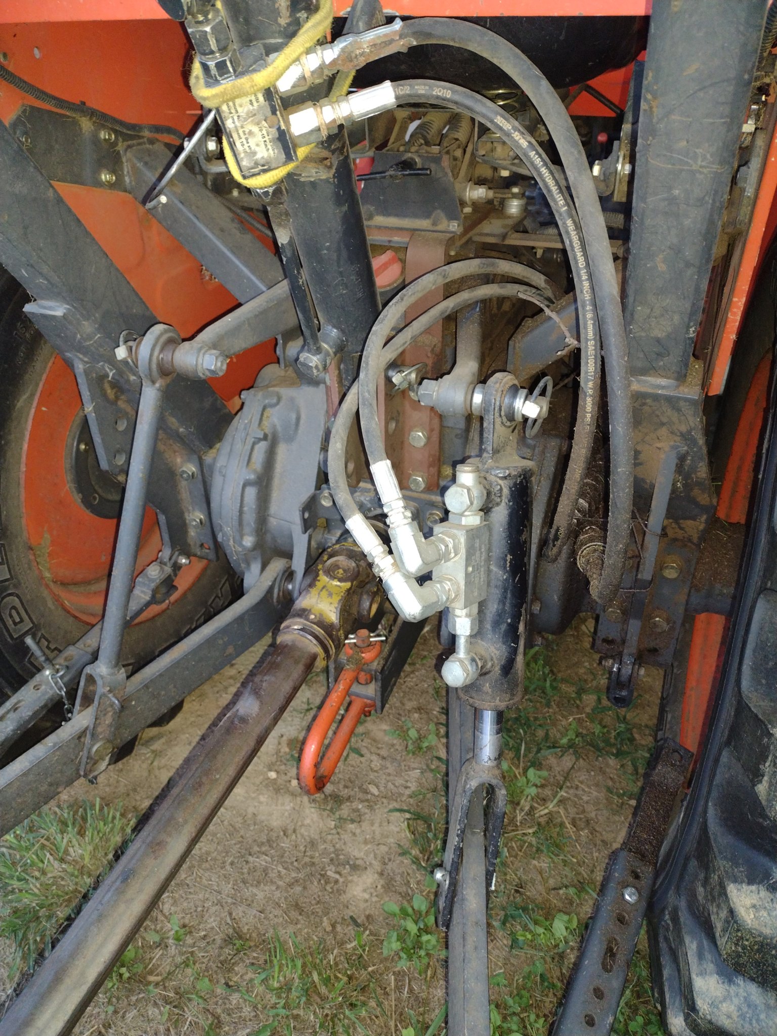

I bought a ball valve from Brian for my side link. I can reach down from the seat and open or close it.

T
That was an option; but I prefer to get it all linked. So the check valve is a cleaner configuration for me.

Yes, but that would've eliminated my float function.
well, yes, it would have. But since I don’t seem to have a use for the tilt to have a float function on my side link, I’m good!
