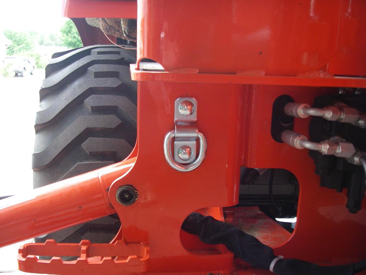

Added tie-points on my BX1870-1 ... 5000# standard bolt-on d-rings that almost perfectly fit the existing bolts over the front wheels ... only had to enlarge holes of +/- 1/16. At 6$ each can't expect better for the price ;-)
I looked these up at our local (ish) Princess Auto store. The picture shows one 1 1/2" unit exactly like yours, "5000 LBS MBS" and says 1,666 lb safe working load. 5000 lbs is breaking strength.

I believe mine are the same as the first Princess Auto link. I picked them up at Tractor Supply in Michigan. I won't be near my tractor until May so I can't help out with the measurements. I can tell you that I have the same tractor as you do and I haul it on a 16 ft car hauler. I know I have the bigger tie downs on my trailer. I installed those so the tie straps would clear the loader bucket and backhoe. All the tie downs have worked great. Way better than trying to find a hooking spot on the tractor frame or backhoe frame. I had to drill some of the holes but that is really not an issue. No difficulty there.

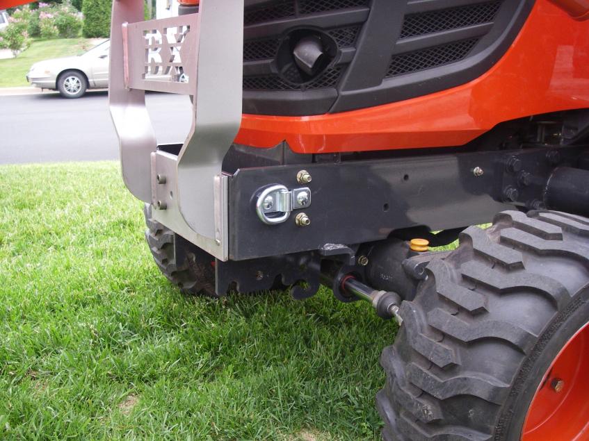

Not sure where you obtained yours, but my local TSC carried ones that fit the from front frame bolts on both my BX1870-1 and BX23S. Just had to paint them.

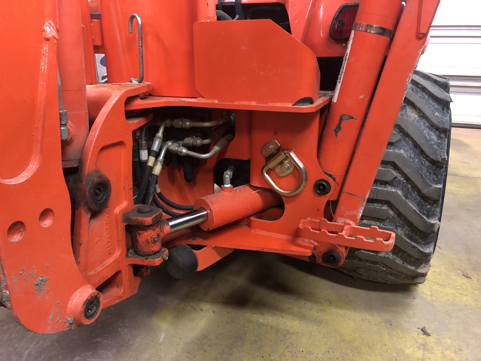

I went with the larger 10k lb D-rings for my BX. Used one existing hole on the front and drilled the other holes. Angled them so the tie downs pull squarely on them. 269045CE-43BC-4CF7-93F5-9ED9875ABEF9.jpeg 0C5796D7-F1B0-45D3-8561-77A9971990CA.jpeg
