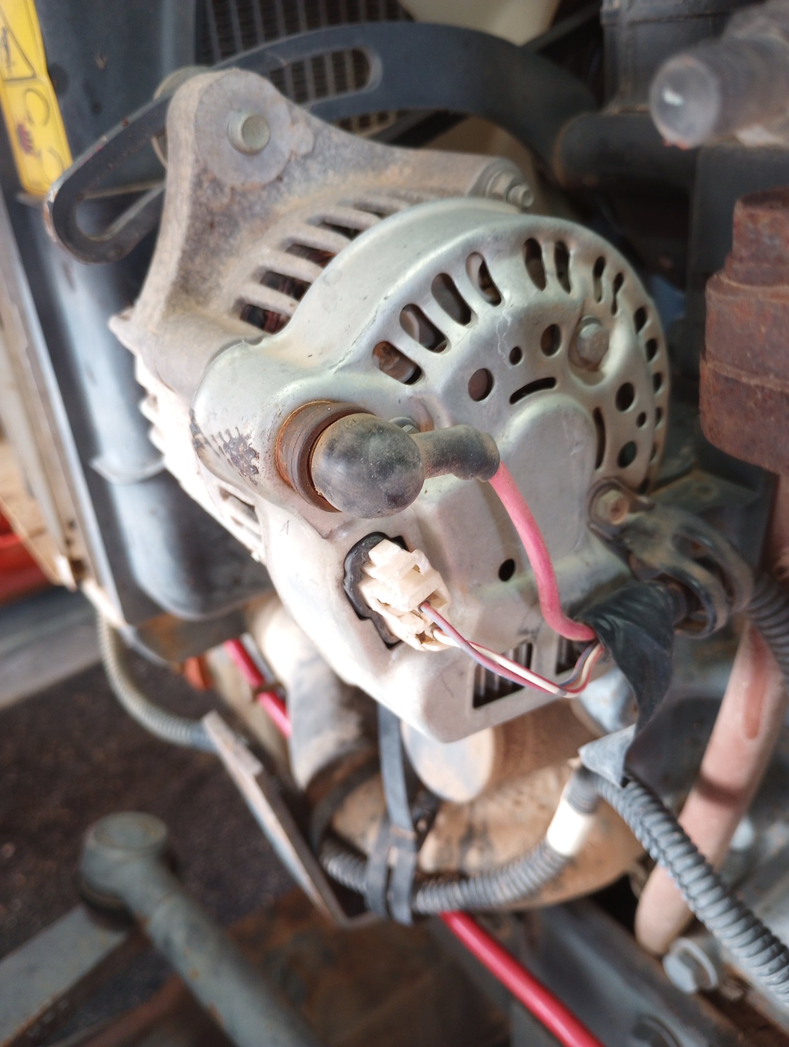

The light has to have some type of "trigger" that ONCE voltage is under "X" -
I would suspect that the "new" alternator is wired incorrectly based on the wire running to the light.
SO if the alternator's wires are run and the "light" is not connected to the proper screw - then it would read as a low voltage.
Can you take a picture of the "back" of the alternator? AND show how the wires are run to those screws?

you really need to find a good schematic ..having the light always on isn't really good !
could be a DENSO 3 wire alternator and the light isn't wired correctly. probably similar wiring to the old GM 10SI type ? LOTS of information about how those are wired.
Some DENSO are 4-5 wire , similar to GM CS130 series
Agree need to know alternator maker and model number !

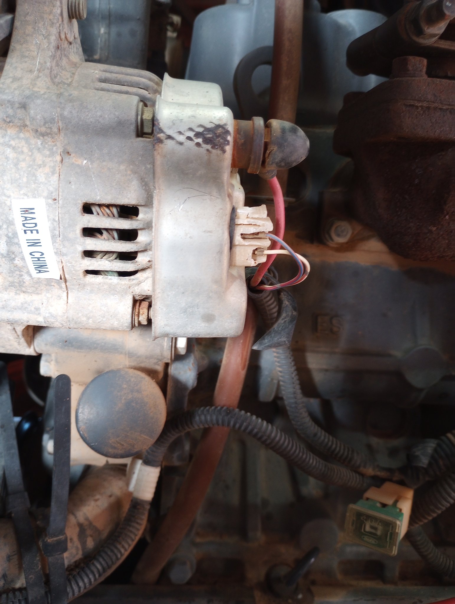

The terminal the white wire with red tracer is connected to is the light terminal. The one above and perpendicular should be connected to the ignition circuit. Remove the connector and turn on your switch to see if the light is still on.
You could always could always connect the plug to the alternator with jumper wires to double check it is still charging and remove the L wire to see if the light goes out and that the WH/R wire is in fact the light wire.
The made in China sticker makes me wonder about the alternator although I have had pretty good luck with some of the Denso copies.

A diagram of the wiring would help. Given the condition of that connector, it's possible the wires came out of the connector and someone put them back into the wrong slots.
Maybe someone has your tractor ( L2600DT) and can look and confirm which wire goes where ?
You really need the tractor wiring to confirm.

Easy enough to determine which circuit is which. Key on with connector disconnected probe both wires with a test light. Ignition circuit will be brighter, light circuit will be dimmer and the charge light will likely glow too.

if you can believe the internet....
the top, horizontal pin goes to IGN
the btm, vertical pin goes to light
one site says light wire will have +12 on it, 24/7 as it's NOT switched power.
I'm a dinosaur, I need to SEE actual wiring diagram and colour code tables.

Yes that is the way the terminals should be oriented according to Denso regulator catalogs.
The light wire had better be switched power. If not then the light would illuminate both key on and off eventually running the battery empty. Not a good scenario.
What happens when you cant tell what color the wires are? ;)
My suspicion is that the PO bought a one wire alternator and that terminal is grounded in that application.

hmm, 1 wire...
yes, really NEED to know the model of that alternator.
I've seen 1 wire's for sale and make didn't install a solid plastic cover where the 2 prong plug is ! This means you can connect the wires up BUT who KNOWS where those 2 pins go inside the alternator.
