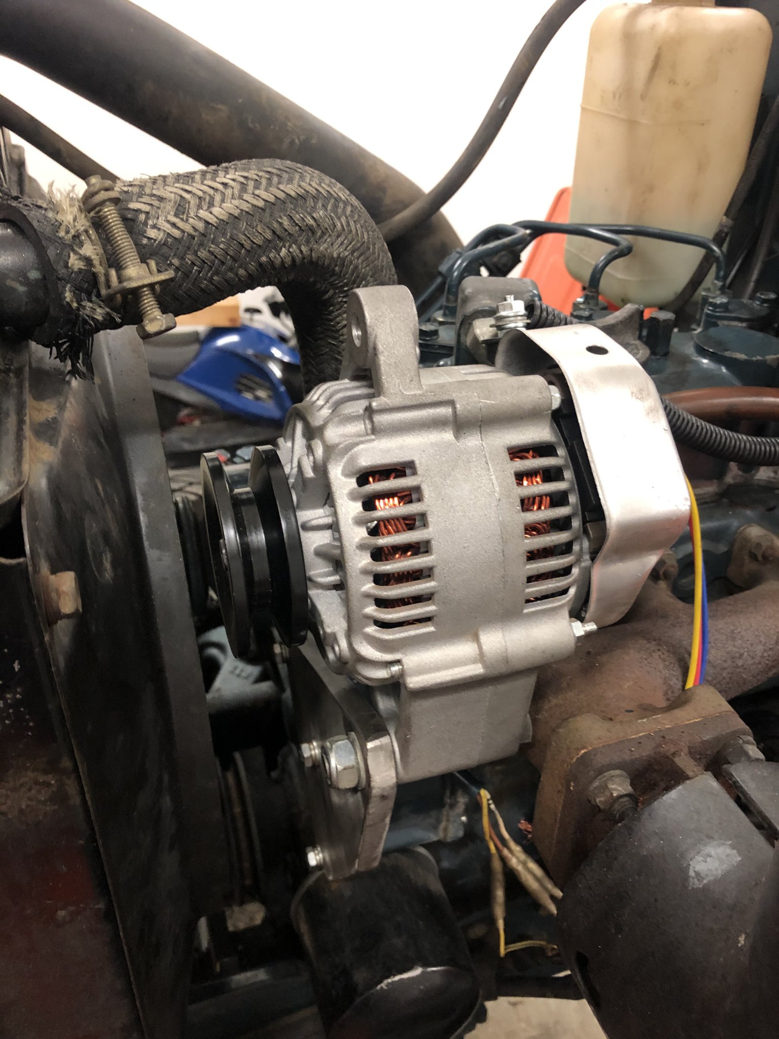

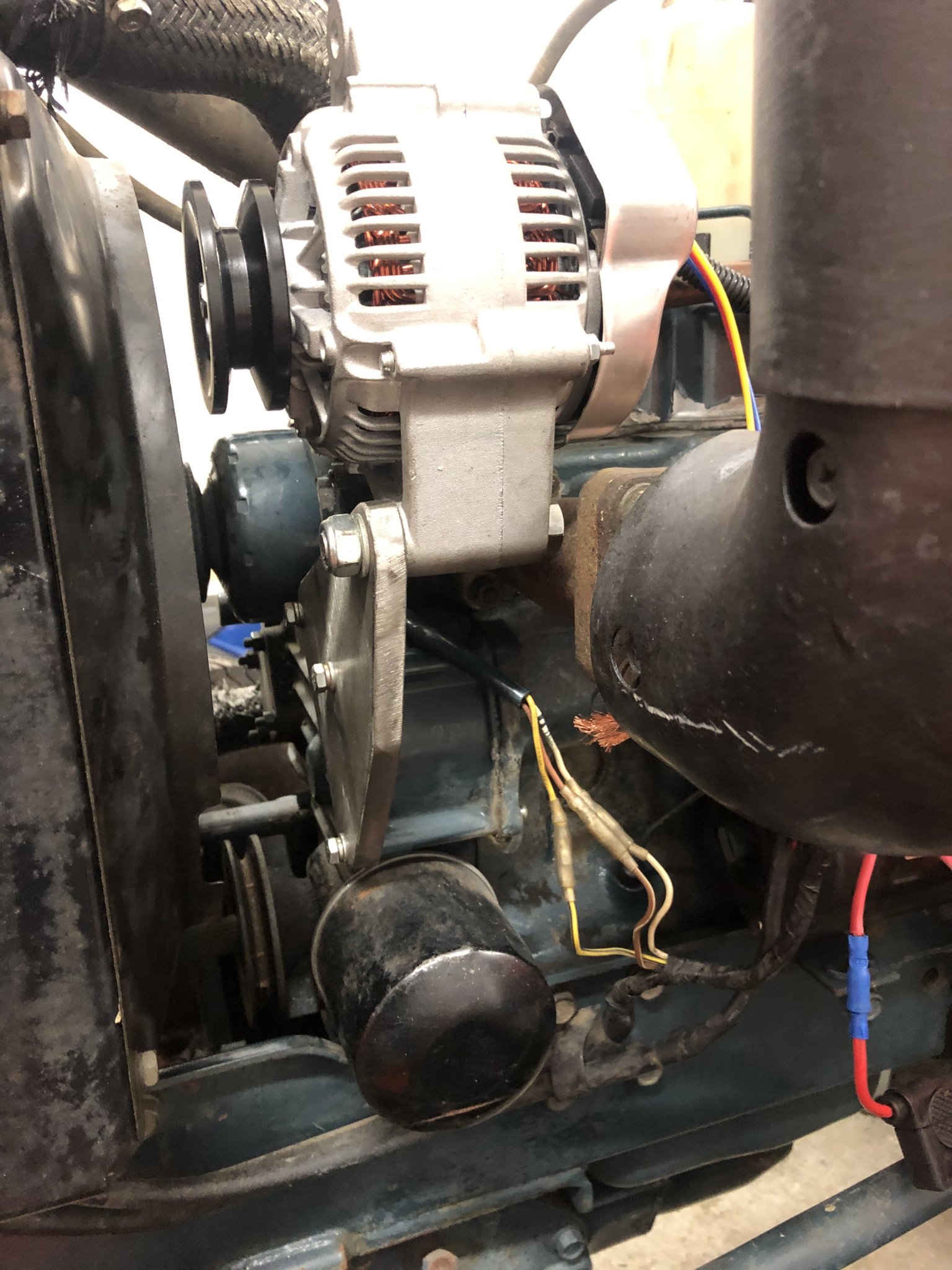

i tried with 2w and 4w bulb, no different, i checked all the cable, for me it was easier to just remove all cable and just mount a new DC-alternator, no i have correct charging and voltage is correct:)

Good job!
Just make certain the gauge or size of the wire from Alternator output is adequate for amps it will produce
