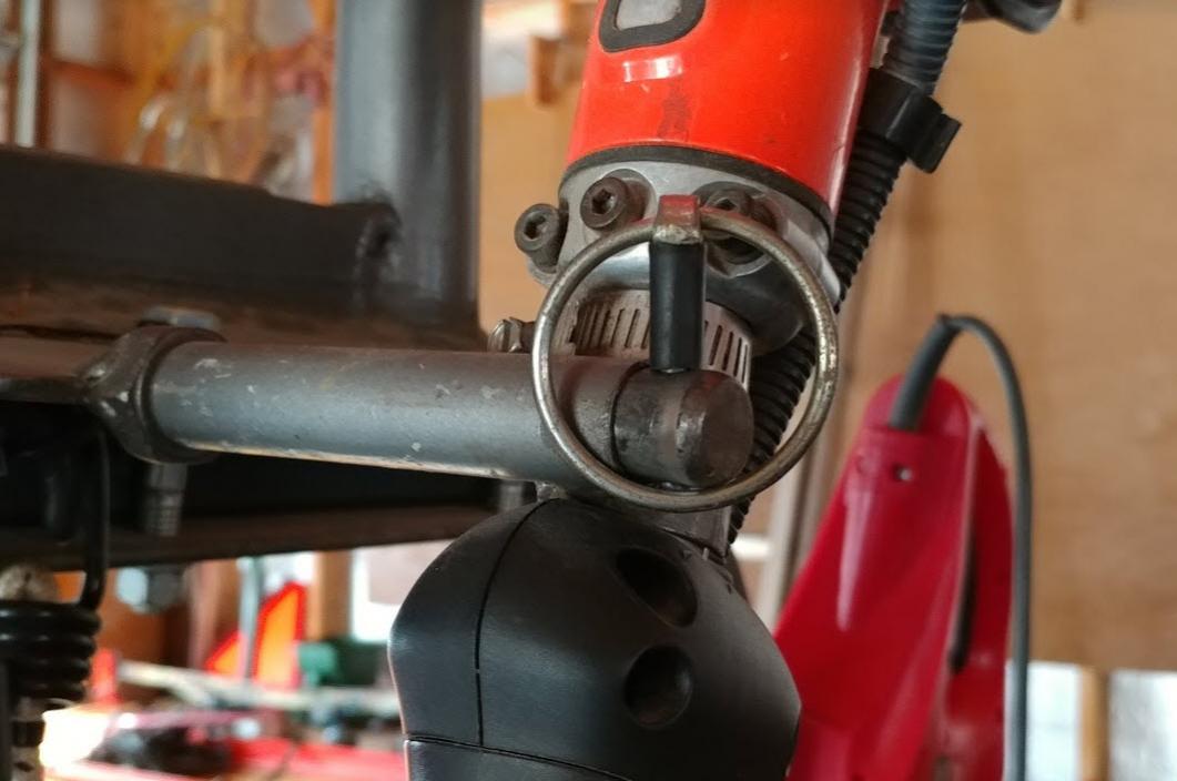

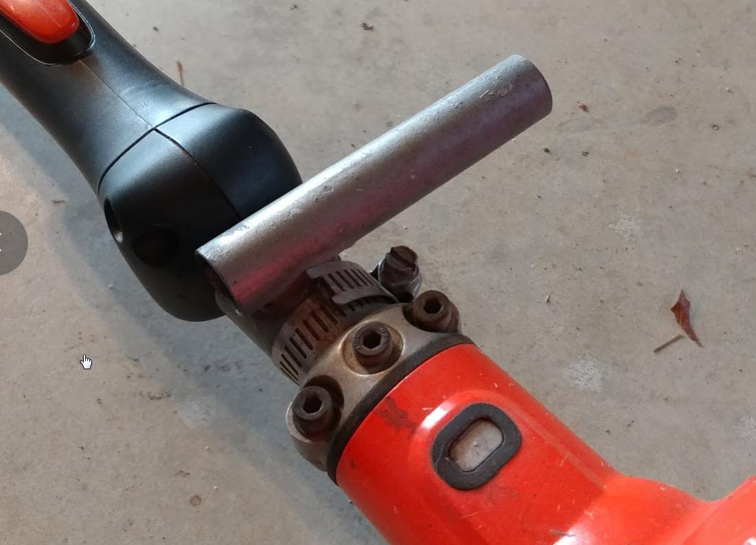

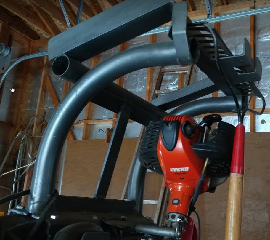

from Grouse... Hey Dandeman, what holders do you use for the string trimmer?
Sorry for the delay in answering, needed to get some more pics to show you how it is mounted. The straight shaft string trimmer is so long it needed to be hung high up, higher than the top of the ROPS.. Fearing I might forget and drive under a low hanging limb and destroy the string trimmer, I made a bolt-on (the ROPS) extension that provides the mounting point and protection for the trimmer. There's also some added steel to protect the lower end of the trimmer as I use the tractor in the woods and backing into a low stump and damaging the business end of the trimmer is a very real possibility.
The mount on the string trimmer is made from a short section of pipe (actually 1/2" EMT) welded to another short section of thin wall metal shaped to fit the trimmer shaft, and is securely held on the trimmer with a hose clamp. The EMT sides over a pin that is part of the above mentioned extension. The extension has a place to hang another long item (rake) and ladder carrier on the very top to hold the upper end of a ladder with the lower end of the ladder sitting in the FEL bucket.
Rube made me do it! and where can I put that harmonica and drum!
Hopefully the attached pics makes this all clear...
