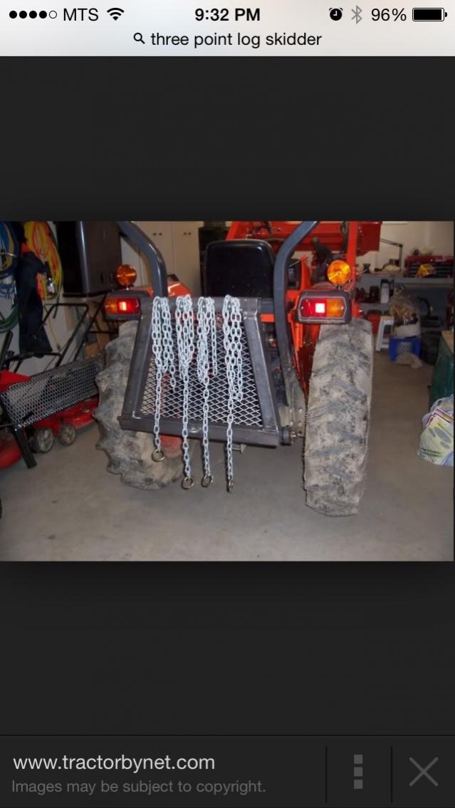

Try both. Have a skidding plate made up, will help in either situation.
14,957
4,005
What is a skidding plate? I have an idea but have never seen one,, ya got a link er sumthin?

This is what i mean, a three point attatchment to help with skidding,a shield of sorts to prevent damage to rear of tractor. There are all kinds.
