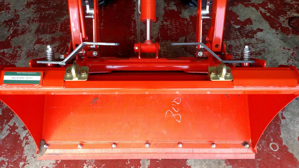

Not much more I can say that hasn't been written already (thanks everyone), that bucket has two great spots on top to weld hooks to if that is what you want to do. Here is a picture with our Bolt-On Hooks mounted just inside the QA, you can see the area just to the outside of those that you can weld to. We can provide either option as well as other accessories to compliment them.
