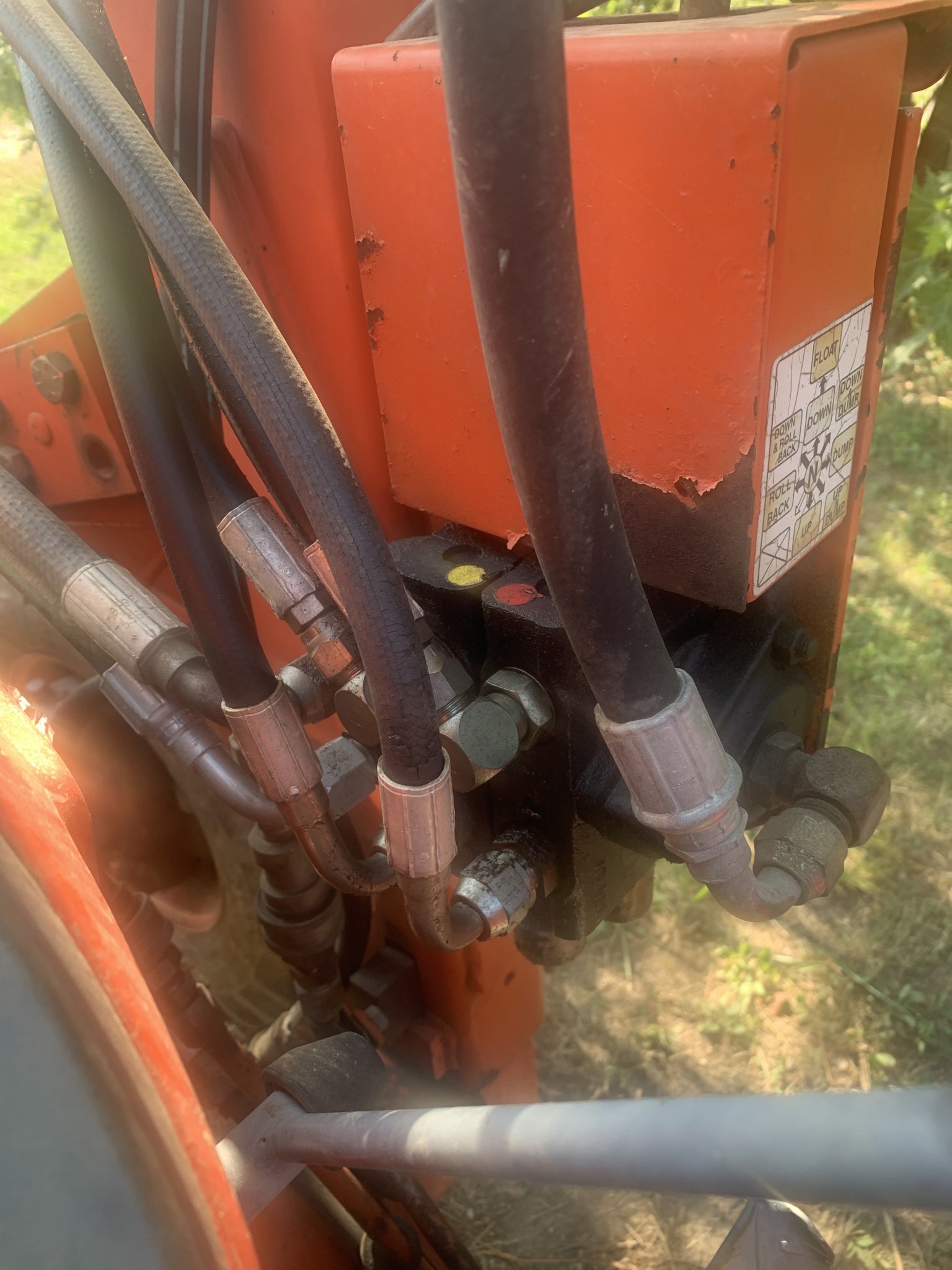

9
St Clair mo
Dave the FEL has seven hoses to it. One hose coming off the the junction block under the tractor, number four outlet port goes to a dead end male quick disconnect just hanging and not hooked to anything. Any ideas? Thanks for all your help!

Muskoka, Ont.
Please sketch out a schematic showing how and where the hoses connect.

9
St Clair mo
Ok I got it figured out, I had to turn the junction block valve to the closed position and the line coming out of port 4 (outlet) that was just blocked off and hook it into the power feed for the backhoe out of the FEL control valve to charge the outlet line to the lift arms. Thanks for everyone’s help! I hope I explained that correctly! Lol
