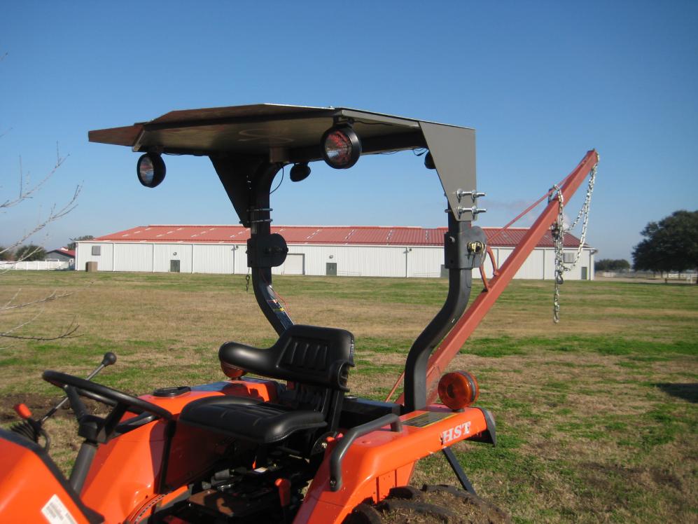

Have U considered making your own. Check out mine. I made it of 1/8" steel sheet metal for the brackets, 3/4" steel square tubing frame & 1/8" diamond plate aluminum sheet on the top. I doubt I have more than $40.00 in it.
