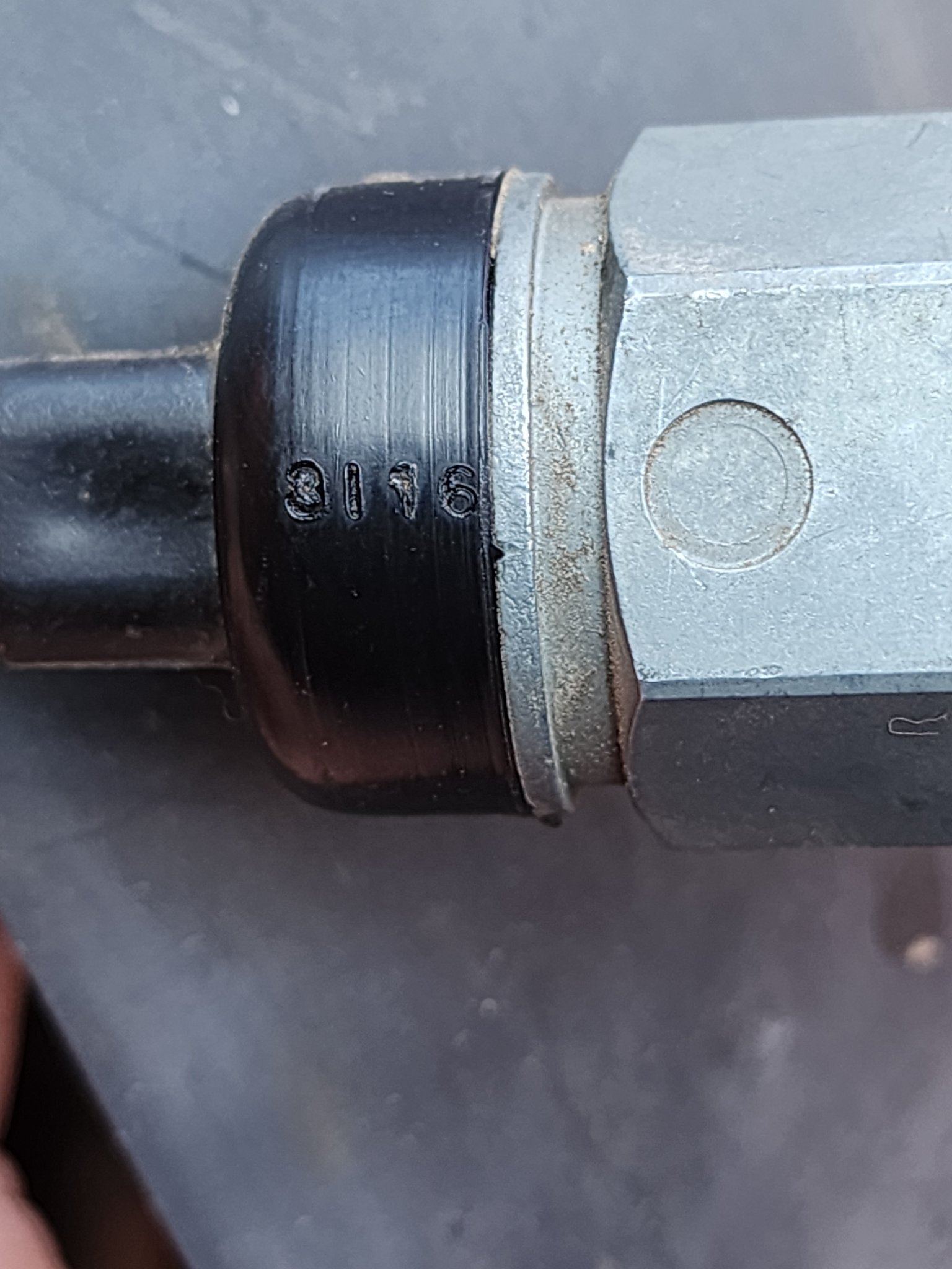

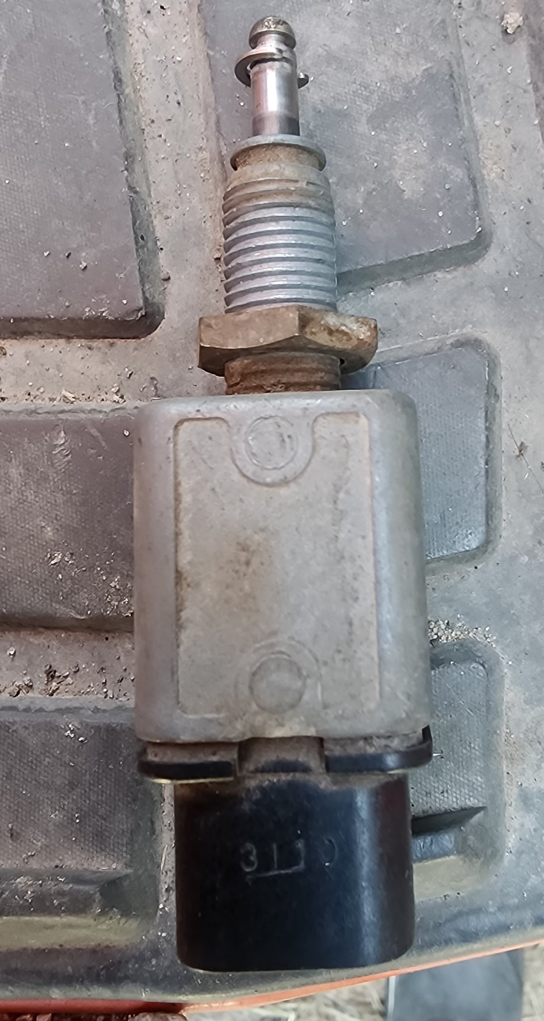

Hi, this is my very first post ever on a forum, so hope I am in the right place! My L3130 has had some random starting issues, and a friend has narrowed it down to the clutch safety switch inside left side of dash cover, part #3116? (hard to make out 3rd digit) or the HST neutral switch underneath tractor on left side, #3110. I cannot locate these parts on any Kubota site. I have found what appears to be the clutch switch on ebay but no numbers match up. Even when I called the dealer on Friday he was not sure. Do they change these part numbers in later years? My tractor is a 2003 or 04. Any help would be greatly appreciated, I need to get my tractor back on the job pushing up brush piles from the horrific ice storm we had here in northern Michigan, our community needs me! 20250420_122110.jpg 20250420_122244.jpg

Hi, this is my very first post ever on a forum, so hope I am in the right place! My L3130 has had some random starting issues, and a friend has narrowed it down to the clutch safety switch inside left side of dash cover, part #3116? (hard to make out 3rd digit) or the HST neutral switch underneath tractor on left side, #3110. I cannot locate these parts on any Kubota site. I have found what appears to be the clutch switch on ebay but no numbers match up. Even when I called the dealer on Friday he was not sure. Do they change these part numbers in later years? My tractor is a 2003 or 04. Any help would be greatly appreciated, I need to get my tractor back on the job pushing up brush piles from the horrific ice storm we had here in northern Michigan, our community needs me! View attachment 152871 View attachment 152870
The numbers on the part are not part numbers, they are production numbers and don't mean anything.
You have pictures of 2 different switches.
First pic is the HST neutral switch
Second pic is possibly the clutch switch, not a whole picture.

The HST switch is failing as it clearly has fallen apart.
