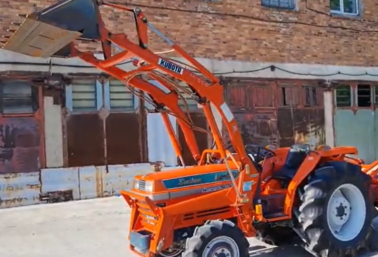

Thanks for all you feedback. I guess I should be more detailed. It is a 30HP 4wd with power steering. I know I would need ballast weight it I lifted anything very heavy. My main need is to move dirt and equipment around the shop. I dont think I would be moving anything over 1000 pounds and probably not over 500 or 600 pounds. I'm attaching some pictures that I pulled of the internet since its dark and I wouldn't be able to take any pics till morning. One shows the axle and one shows the tractor with a loader but I cant find many examples with a loader. What I'm really looking for is someone who has a kubota withe the steel tubed axle that has a loader and how much they can lsafely lift with it. I know I will have to manufacture my mounts which I dont mind doing as long as I dont end up breaking my tractor.

Its a V1512 engine, which was used on models that ranged from 26-30HP. The axle is infact steel. It has a cast pumpkin that bolts into a steel frame and the axles welded to it and then bolts to the cast knuckles for steering. As far as I can tell they only used this on the sunshine kubotas in Asia and Philipines. I haven't taken all the sheet metal off yet to look on the trans for a model but as far as I can tell from comparison on specs and pictures, it was sold as a Zennoh but is made by kubota and is an L1-285 or L1-295. It also came with the Monroematic electronic 3 point that I still haven't had time to play with yet but If I cant get it to work electronically, I'm pretty sure there is an early US kubota with a lever controlled 3 pt that will bolt on as a direct replacement based on what I've read from some other folks. Right now the main worry is how much I can safely lift with a loader on that steel axle. There are a few pics like the one I posted with a loader that looks as heavy made as most US loaders.
36,454
11,243
The amount it can lift and handle has very little to do with the front axle it has to do with the subframe and the amount of counter balance weight you put on it.
