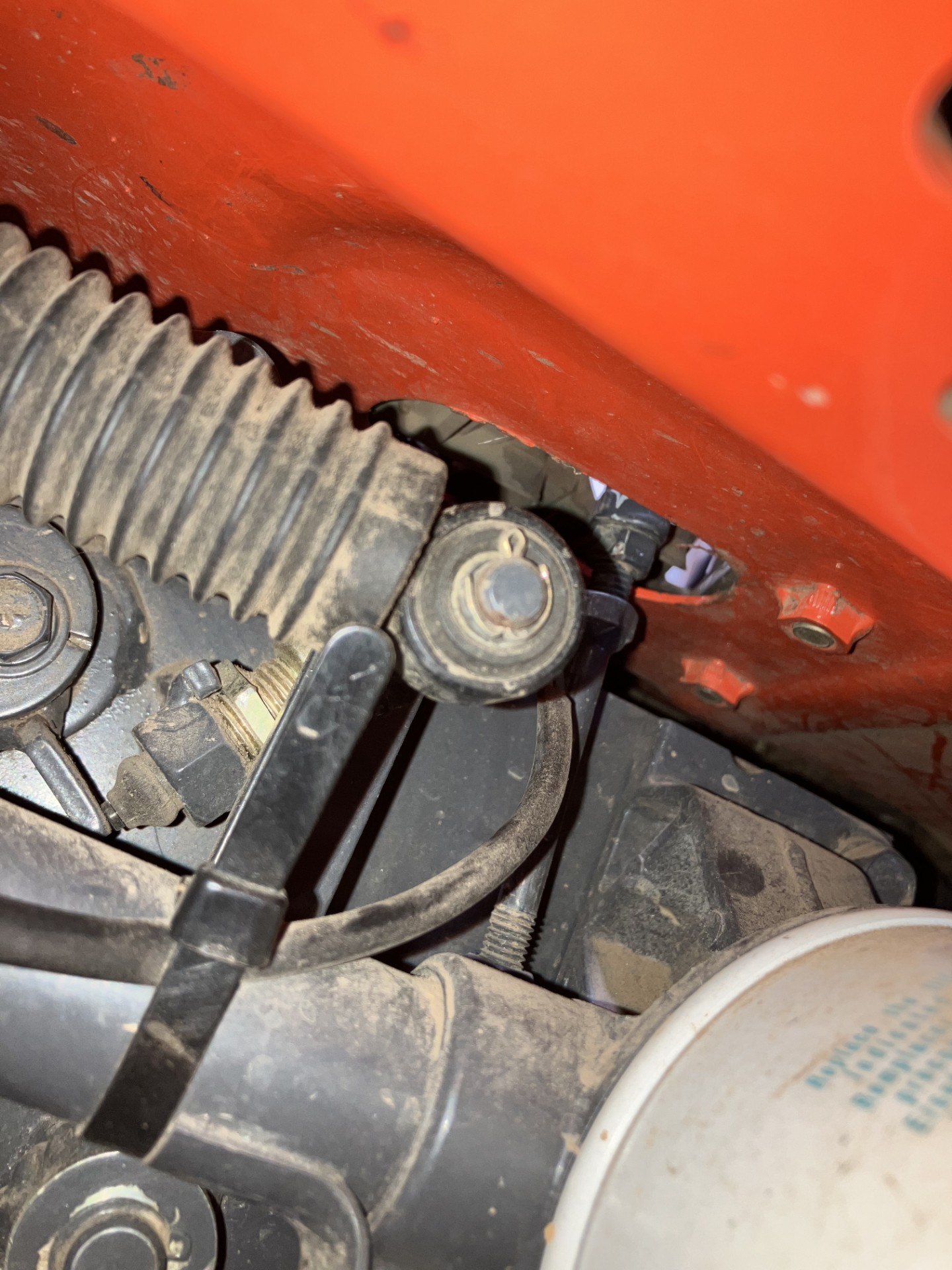

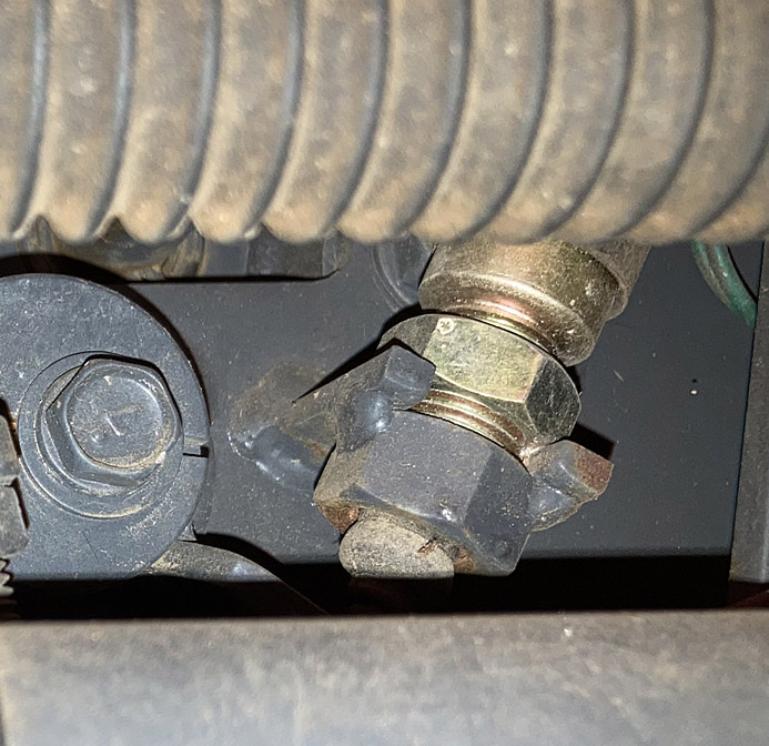

Yes, I am sure it was as L3710 Kubota. The opening with the linkage connecting to the pedal is a slot. You just remove the nut from the tie rod end at the pedal, and remove the 2 bolts that hold the pedal to the floor. This uncovers the opening.
From under the tractor using a 19mm or 3/4" wrench you break the lock nut on the switch loose.
The switch has an approx 6" long pigtail with a connector, disconnect it.
Reach into the opening through the floor to unscrew the switch. Reverse the procedure to install the new switch.
Screw the new switch in about where the old switch was, plug the wiring together, and see if the engine cranks. Keep screwing it in until the engine cranks, turn in an extra 1 1/2 turns. Lock the jam nut. Unplug the wiring and untwist it.

I was out looking at mine (the one I said never existed, ha). It does appear you can adjust the seating depth of the switch to some degree. Once you loosen the lock nut, it appears you can rotate the switch body to bring it in, or back it out. The only way to tell if it's seated at the correct depth would be to use an ohm meter. Yours is mostly likely shot and seated correctly.
Regarding the replacement switch, Messicks is saying it's dependent on serial number, so you'll need to have that handy when speaking with a parts tech. What I would do in the meantime to get you by is unplug the switch, cut the wires right where they enter the switch, splice them together, and plug it back into the harness. This will omit the switch from the starting circuit.
