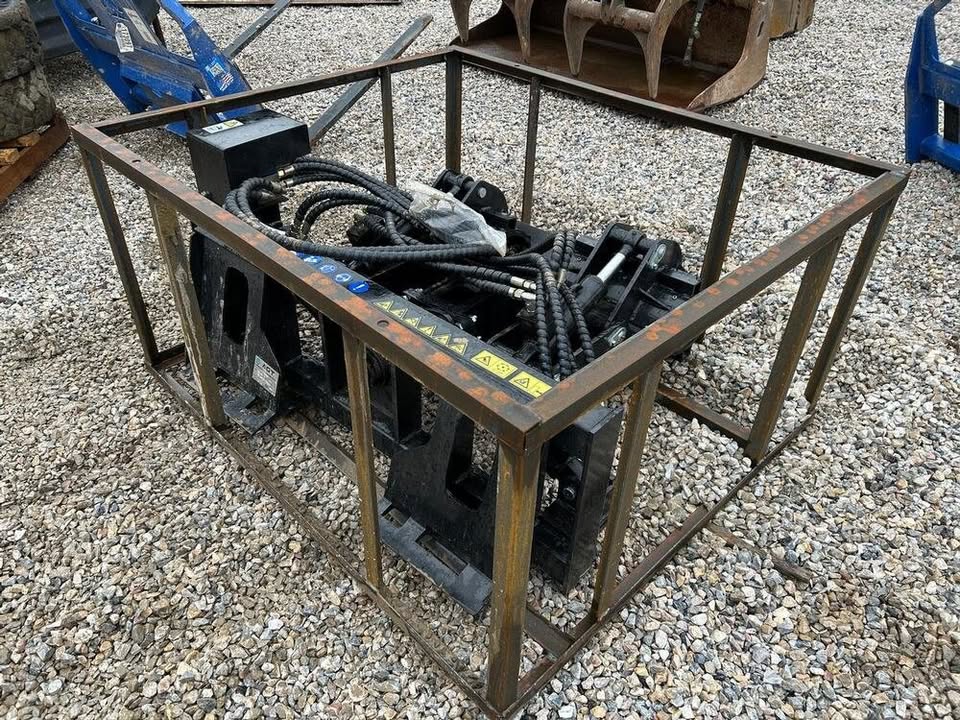

Can anyone help confirm this pole grabber will attach to my kubota b26?
Clint_J
B26
Mar 17, 2024
10
Pennsylvania
I need a pole setter. found this one online. will this attach to the front loader side when I detach the loader?
Also this pole grabber uses universal hydraulic couplings. I think I can get adaptors to solve the hydraulic coupling per my research.
pictures of the grabber below, thanks.

umm folks will need to know what vehicle your attaching to and what the model and maker of that attachment.

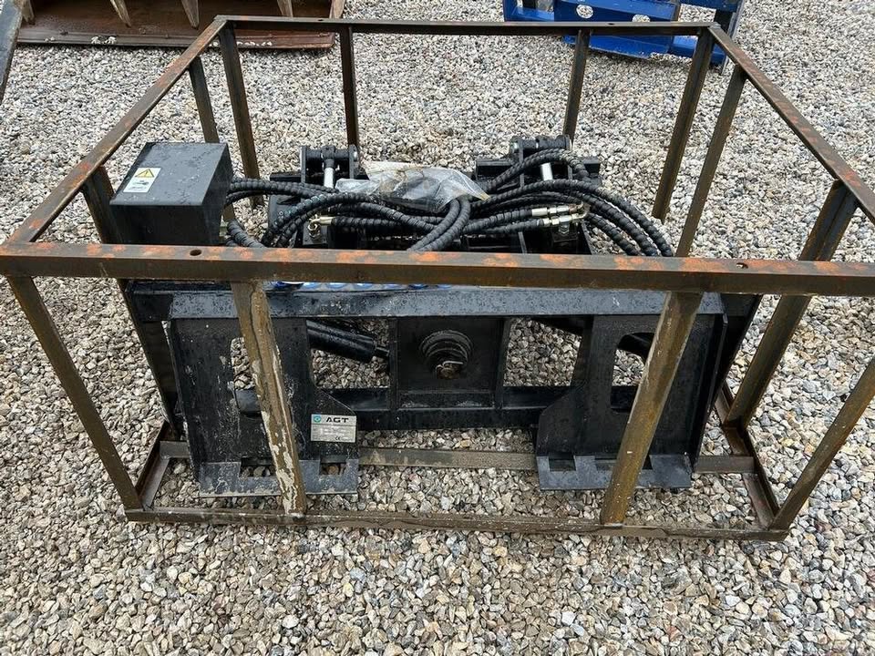

you will need third function hydraulic and that looks like a skidsteer quick attach plate.
will it fit a husqvarna lawn mower... no will it fit a bobcat skidsteer prolly but no idea of what you have or what that device actually is. kinda hard to tell
34,104
9,294
Yea it will attach if you have a SSQA adapter on the loader.
BUT... should you attach it to a B26, probably not.
Implement weight and then pole weight will quickly out do what the b26 should handle.
