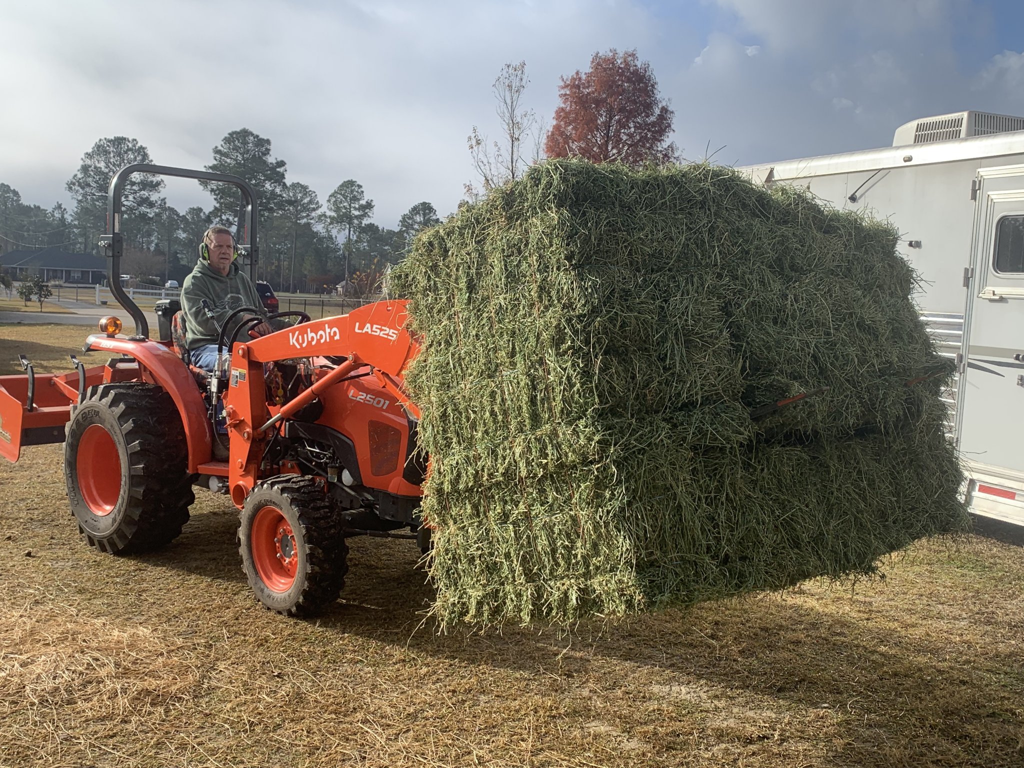

Hay Goz63..
gotta ask, did you defeat the seat switch ?? cause HOW do you see 'over' the load ! My luck, engine would shut off EVERY time I'd get up to make sure the way is clear.
also , are those a bunch of small squares ? maybe 12 ??
Yes that is 21 bales bound together in a cube. Each bale is 65lbs. I have my wife guiding me. Yeah can’t see over that. Can’t see over the round bales either. We do the 4x5 rounds.

Well this was my post then, this is now. No sweat. View attachment 72751
Surprised as today I got lots of notifications from this 6 month old thread. I am glad that you posted this picture though just to prove my point in this thread from 6 months ago. 21 Square bales at 65lbs each is approx. 1365lbs. And you are up well above 6 inches of height here. Some people just really underestimate these tractors. I still hate to see people on the forums constantly telling people that they cant do a task with their $20,000 tractor, like move hay. I don't know why so many have such flawed logic, and I find most of the time its from long time tractor users who seem to go on some flawed internal thinking process rather than just thinking practical. Just a couple of posts above this one we have a post form TX Jim mocking me for saying you can lift 2,000lbs off the ground with the L2501....which you can, and which I do all the time. Sigh....
Thanks for posting the picture though Goz. I suspect your picture still wont change minds though. Lot of hard heads on here lol
