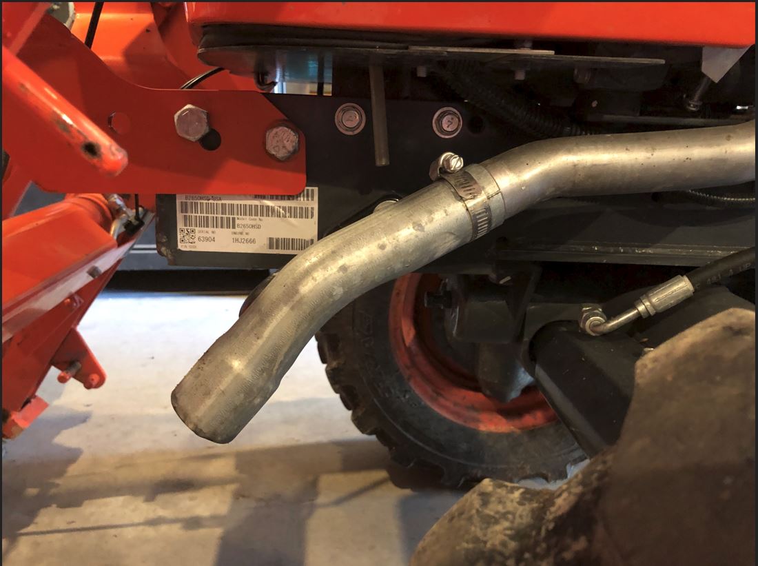

Maybe this will help. Here's mine on B2650. I put a little slit in the pipe and used a hose clamp. Hasn't budged at all.

That does help, thanks! I'm going to attach by the other end instead (y)

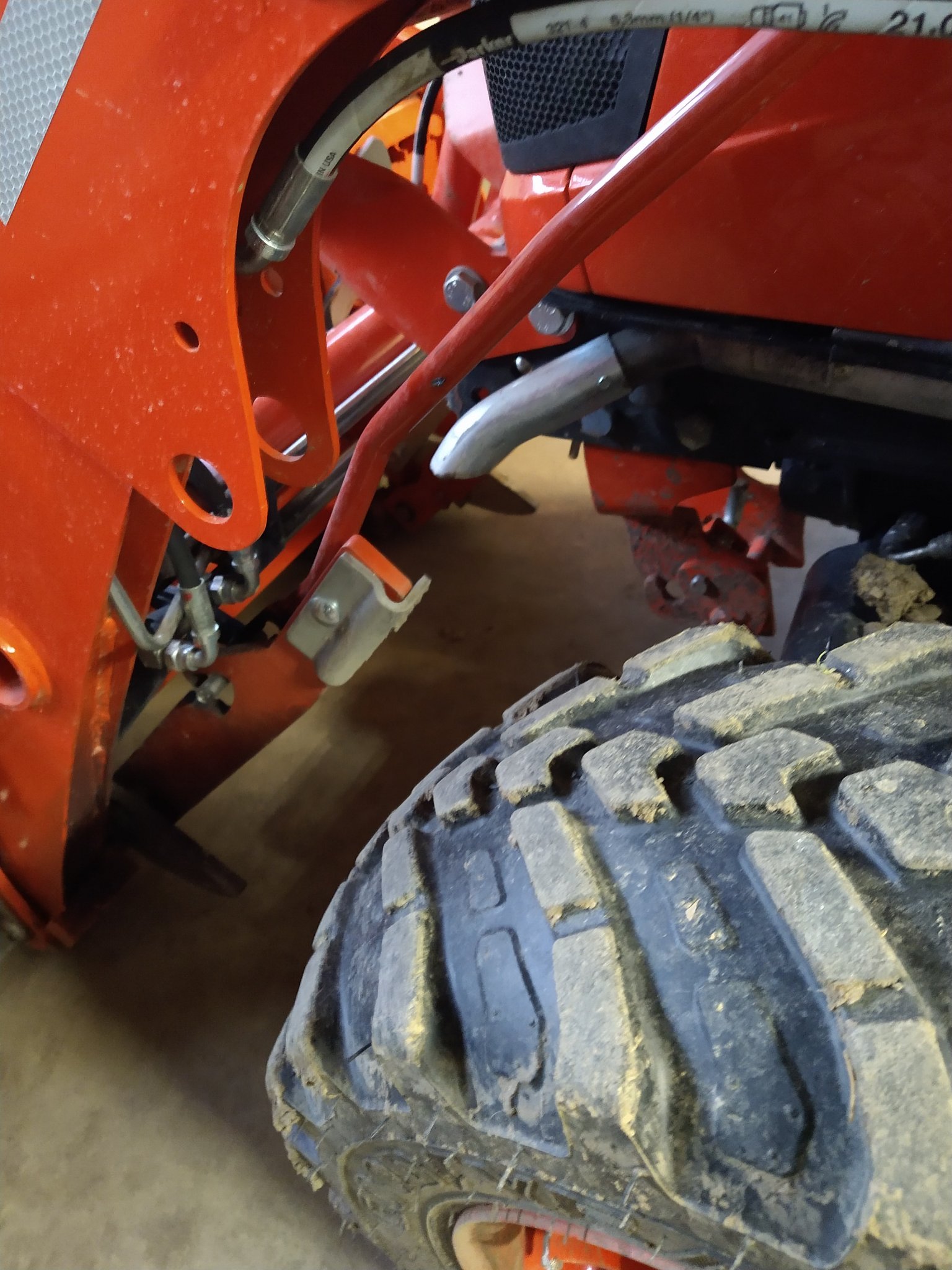

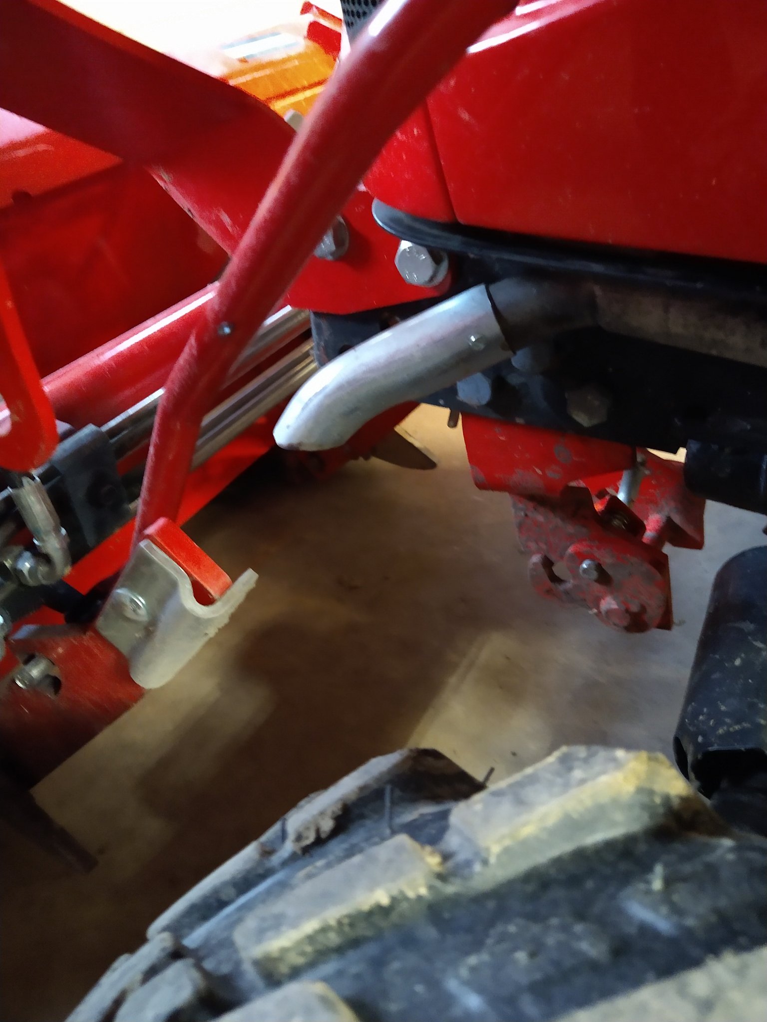

I put an extension on the exhaust on my BX, drilled a small hole and put in a short sheet metal screw so it wouldn't fall off. Next time I had to pull the bonnet off, the screw was gone, but I really had to twist and pull to get it off. When I put it back on, I put another screw in it, which was also gone the next time I looked. So I gave up and just shove it back on now, and it's always tight when I have to remove it.
Don't ask me why....
