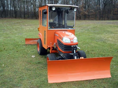

I'd have to go measure but I'd bet our heaters are the same size. I did make the cab as wide as the outside of the rear fenders instead of following the floor pan where it tapers in at the front. That would amount to roughly an extra foot in width for the front of the cab. The cab frame includes some triangle-shaped framing that extends from the side framing to the existing floor and fills in the floor area. The photo below was taken a while back to show someone how I used Lexan to go around the hood. You can see how the side of the cab runs straight forward from the outside of the fender.
The way my heater is mounted in the cab it blows hot air up and that little round chromed plastic diffuser can be rotated to hit te windshield. It takes no time at all till there's enough heat for me and the windows. After the first 10 minutes of running the heater fan provides plenty of heat on low, and if it isn't really cold outside I often need to turn it off.
