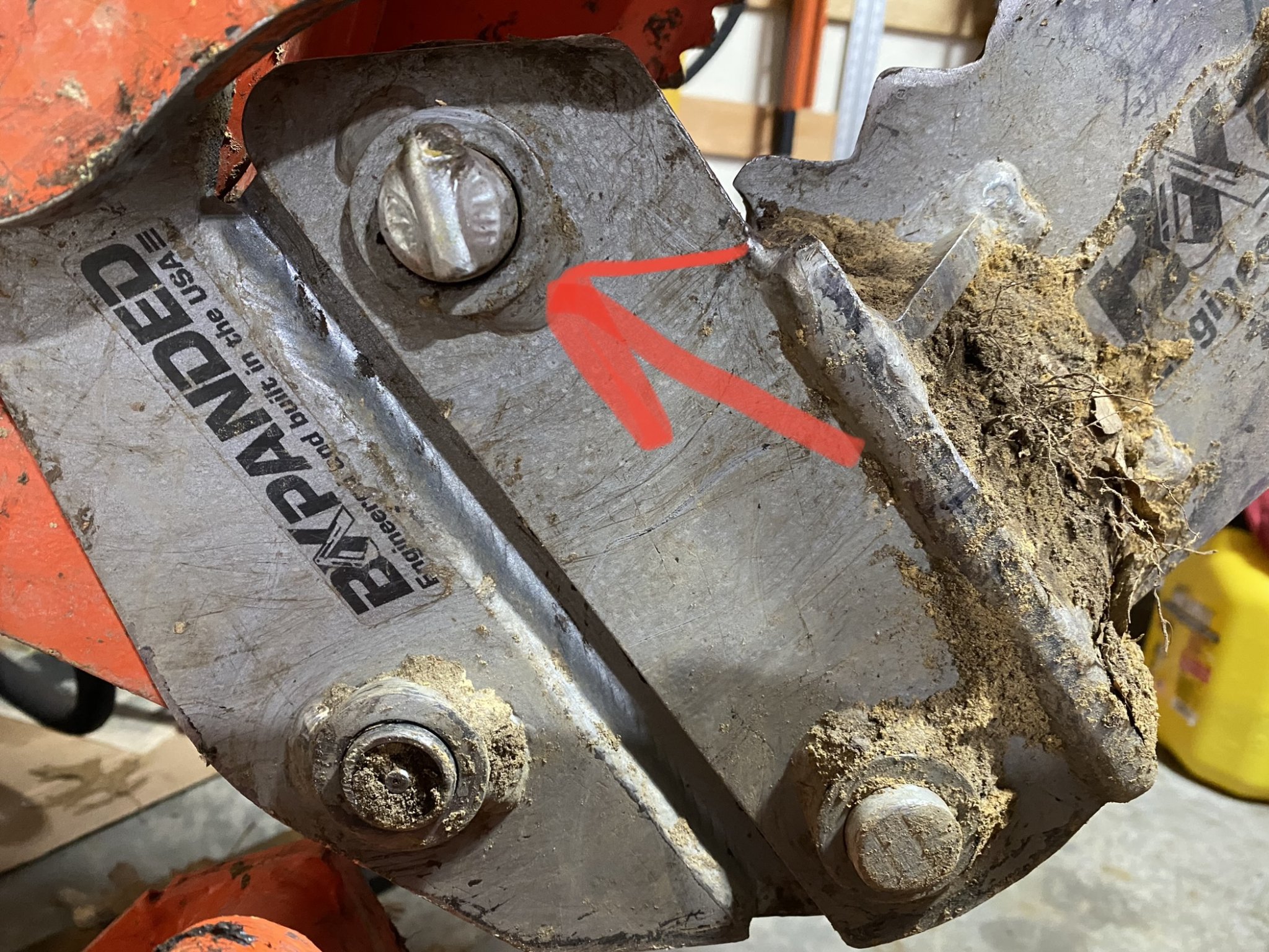

At least they welded your ears on properly. They did such a lousy job with mine, the pin wouldn't fit through! I had to take it to local machine shop to hone out. My experiecne with BX was also lousy, but it was during the height of corona madness, so maybe that had something to do with it.

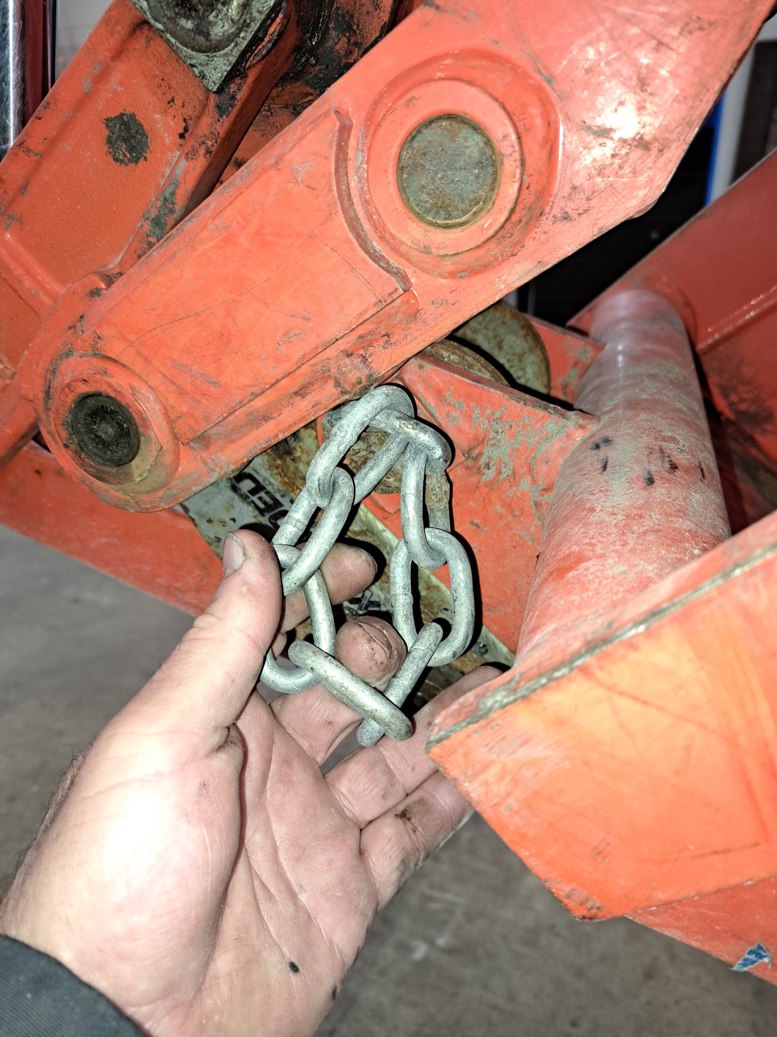

I did the same as well based off advice given on here. My problem was the little "grab handle" snapped which you use to pull the pin out with.
Mine did the same. I welded some chain on instead of another bar figuring it too would just get snapped off again.
About 4 links, I think.
Just enough to grab onto and be able to pull and twist to remove. Haven't had a problem since.
Good idea with the chain.

Here's a pic of my "Chain Mod" for the BXpanded pin. It appears I made a small loop out of the chain, not just a straight piece of chain (must have forgotten about it when I posted previously.)
