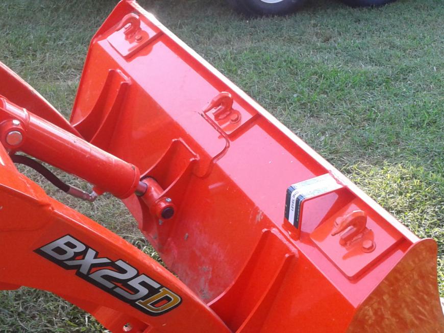

I don't have a picture of them directly, but you can see Bolt on Hooks on the loader;
I really like my them. Have had no problem and have lifted a couple of pretty good loads. Don't see any need to have welded hooks. (I do have a pair welded onto my older Kubota and they have been fine as well).
I do like the idea of mounting them where the loader attached to the bucket. The metal is thicker there. One recommendation that he makes on the installation video is to use the bullet point bits. DANG they worked great. Drilled a lot of holes (mounted several hooks on 2 different tractors). Still sharp and ready to go.

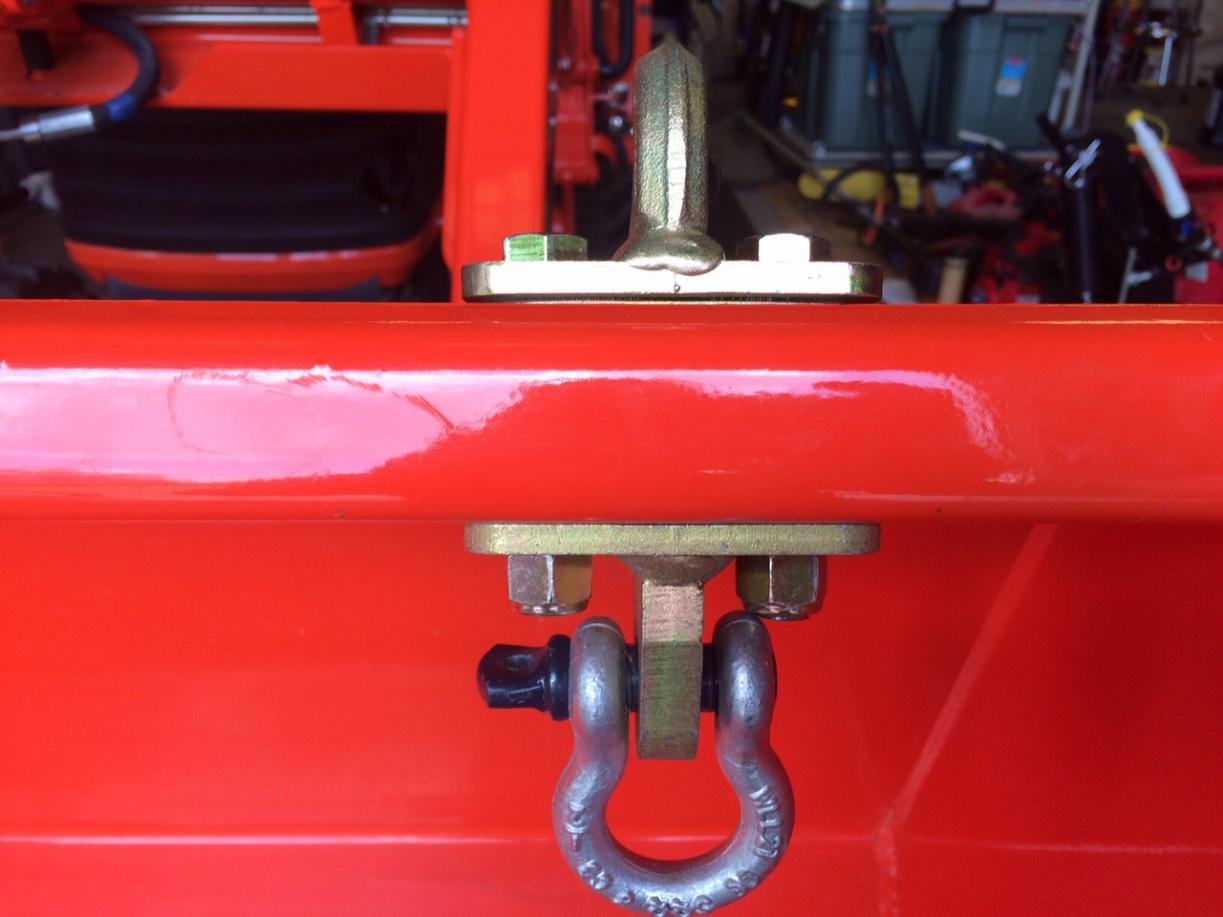

I got the ones from Bxpanded and have found them to be very well designed. One thing I really like about them is that I can position them any place along the bucket at any time and not worry about drilling any holes in the bucket.
Hope this helps.

Can you show a photo of just the hook assembly?

I have been using the bxpanded ones as I wanted to be able to move them where it was convenient. I have moved them a couple times, when I was pulling T posts with the bucket, then while moving some cumbersome bulky tools by myself. Haven't had a problem with their strength.
