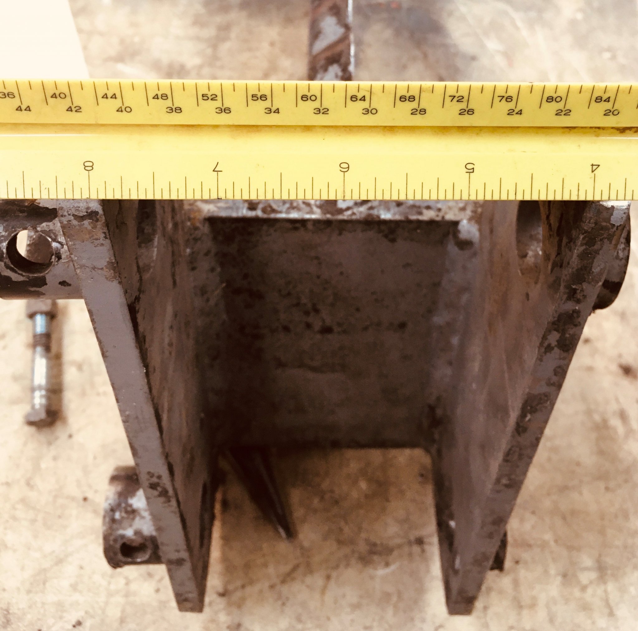

Does anyone have one of these Ripper Tooth attachments from BXpanded?
I'm trying to figure out exactly what comes with it.
A pic of the uninstalled tooth & parts, or an installation diagram might be helpful.
I have been in contact with BXpanded trying to find out if one of their teeth will fit (or can be easily adapted) to my B670BH. They have been somewhat helpful, but seem unwilling to commit to very much. (liability I'm sure)
Thanks in advance.
Bill

I have one, Bill. If I can find it in the shed, I'll take some pics and measurements for you. I purchased it together with their quick attach adapter. I "think" the tooth came with one pin. the QA adapter came with 2 pins? If I forget....send me a reminder and I"ll get on it. The wife gave me a few errands to run for the Easter weekend.

Edit: Mine was ordered to fit the B2650

Here ya go, my friend:
1" bushings spaced 6.5" on center
Side mount plates: 9.5" OAL, 2.875" Tall, .375" Thick
4" inside clearance between the side plates
6" to outside edges of pin bushings
Inside edge of pin bushings flush with inside edge of side plates.
OA Height: 18" from bottom of tooth bar to top edge of side mounting plates
The pins have one hole in them to line up with the hole in the one bushing for a bolt or lynch pin.
Hope this helps with your plans. Let me know if you'd like more data.

Thanks, that helps a lot!
