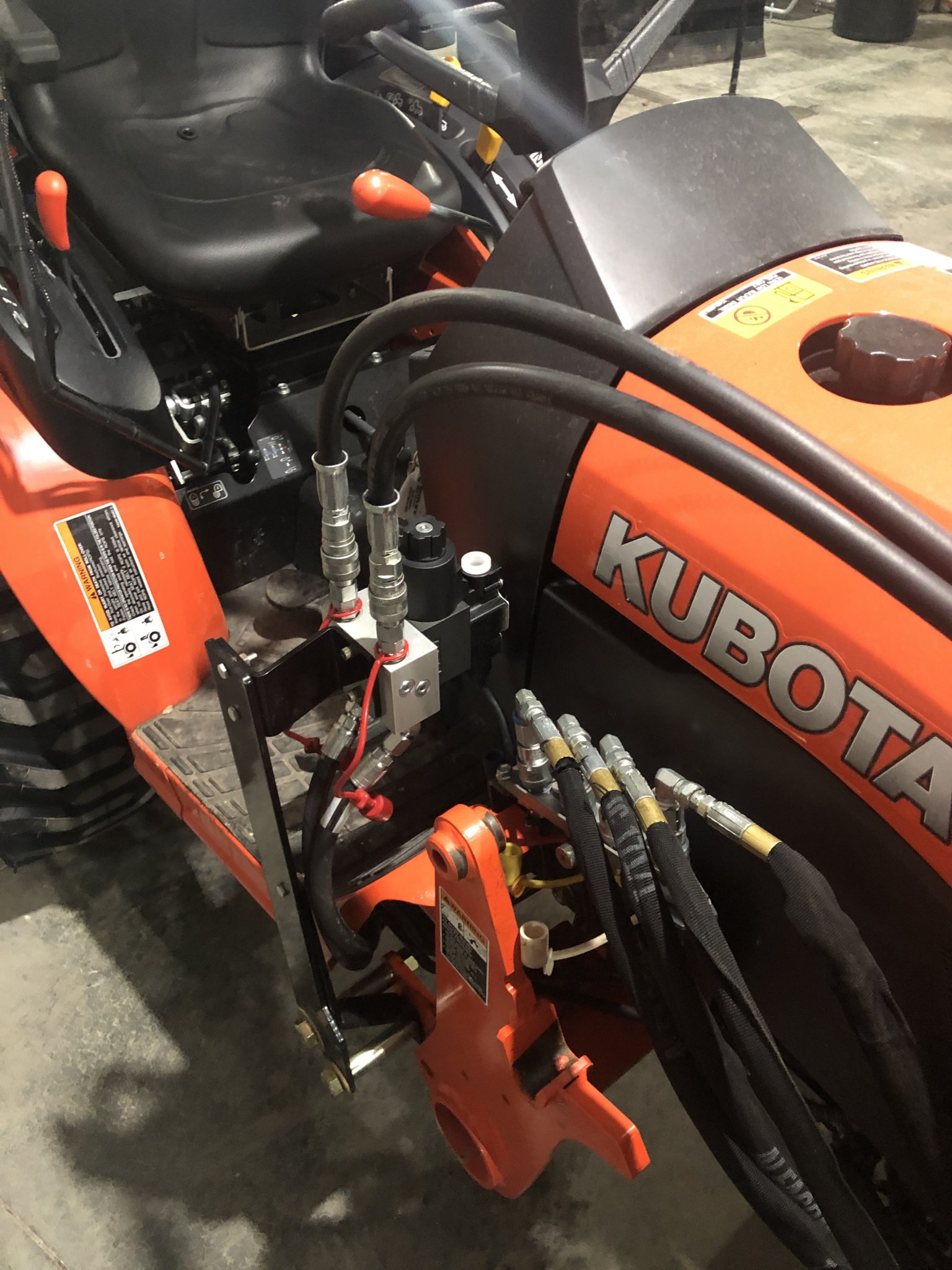

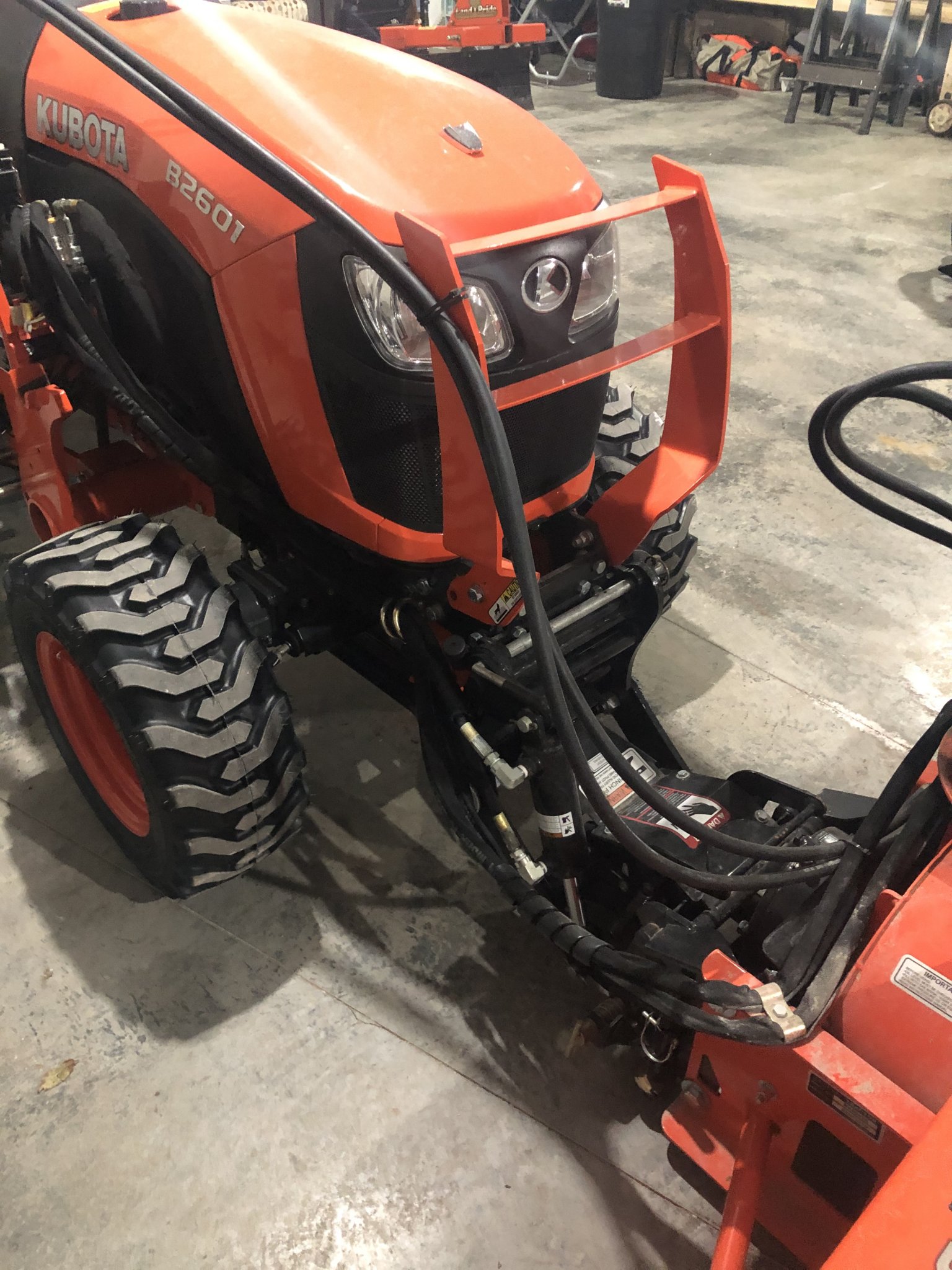

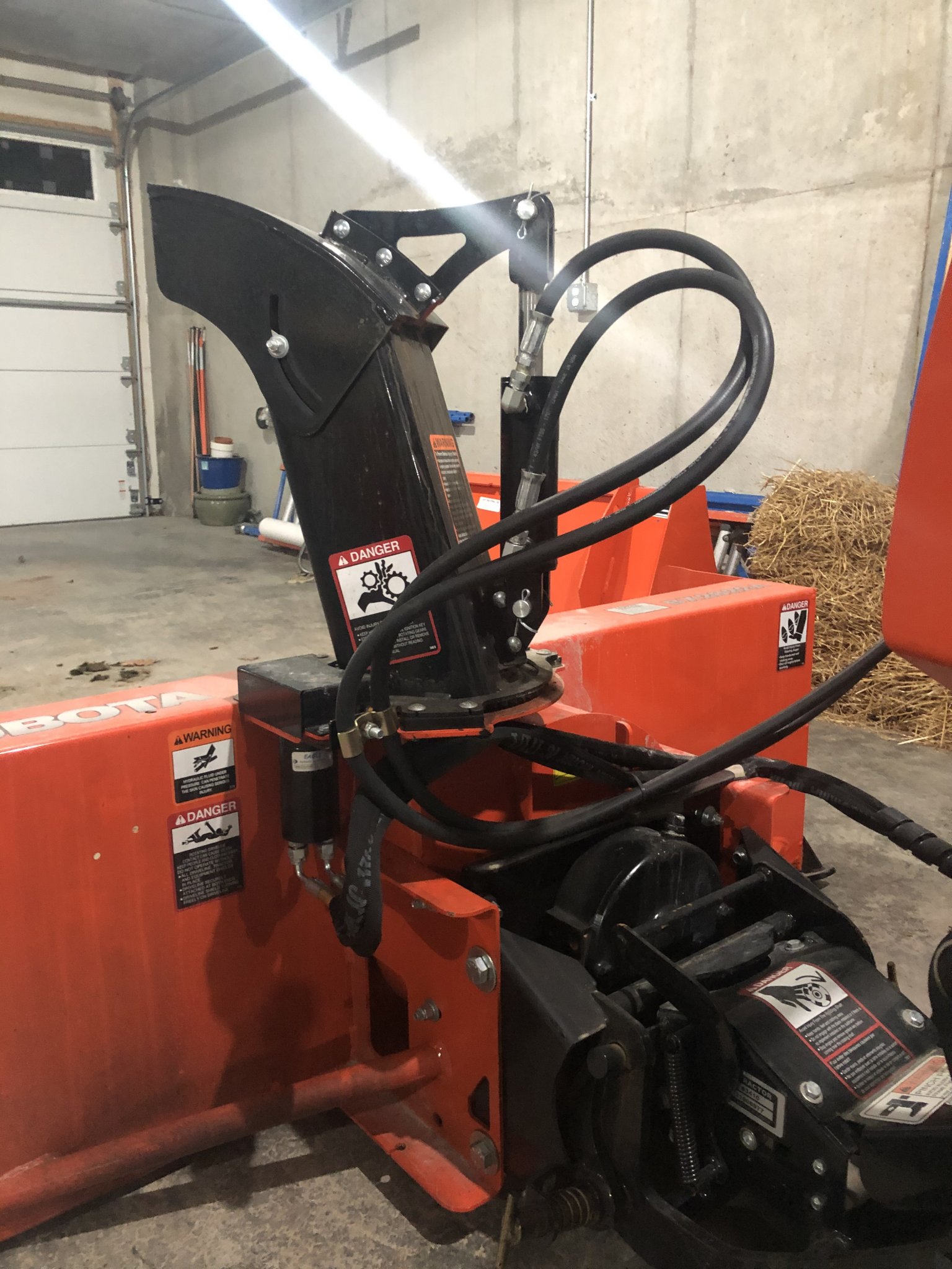

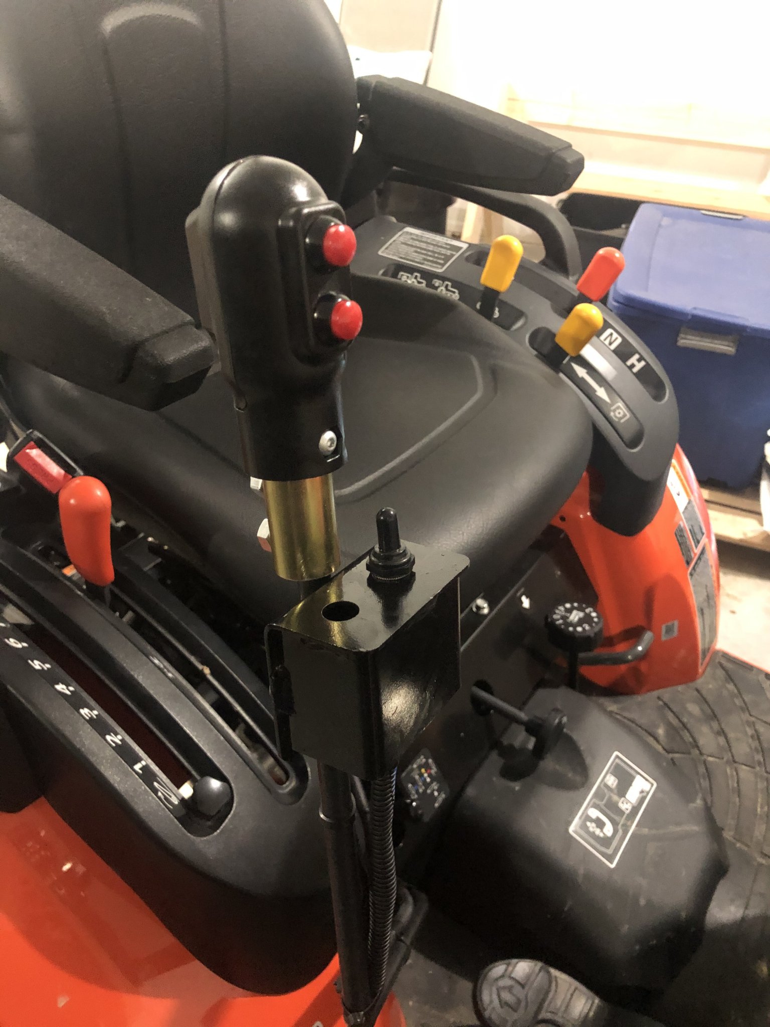

So I ended up going a B2601 with a third function valve and I ordered a new BX2822 with hydraulic rotation and chute deflection. When my tractor arrived a month ago, the dealer didn’t have the hydraulic deflector installed as they missed this when ordering the tractor. Today they came to install it and the installation is much different than I expected. I thought it would be a hydraulic piston with 2 hoses that would connect to my third function valve, but they installed another diver and another switch on the FEL control. Is this correct? I don’t want it like this, I wanted it to be controlled thru the third function control.

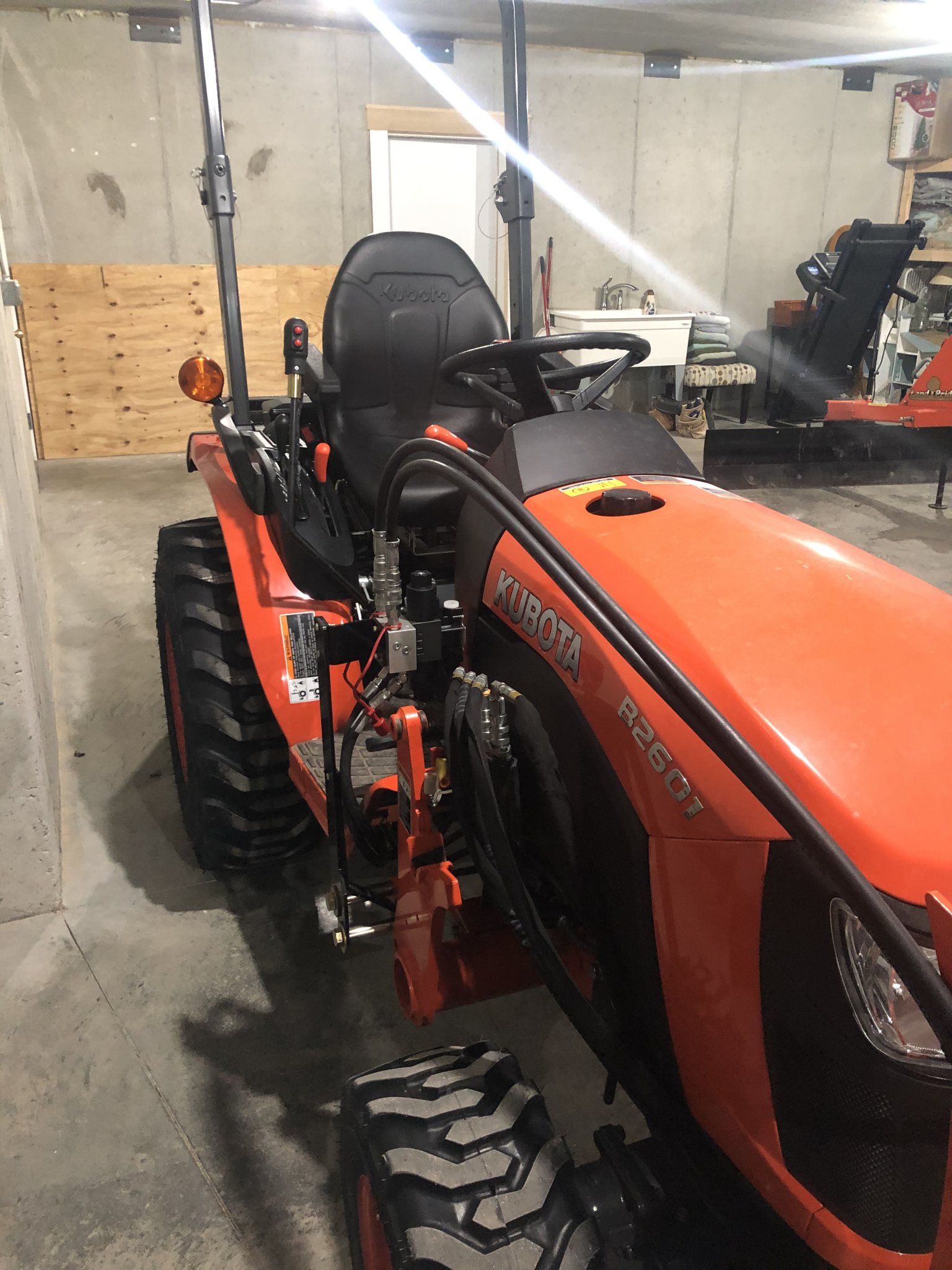

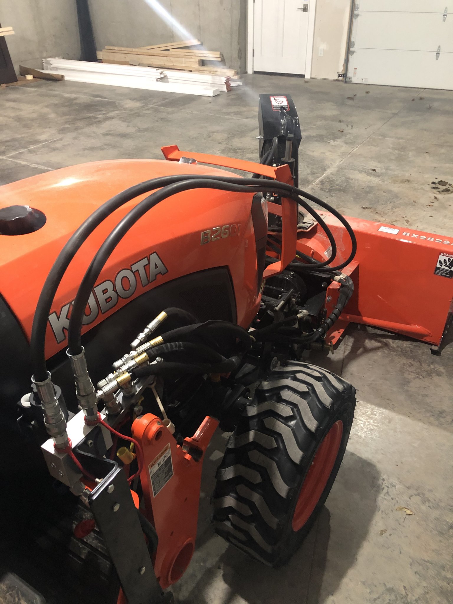

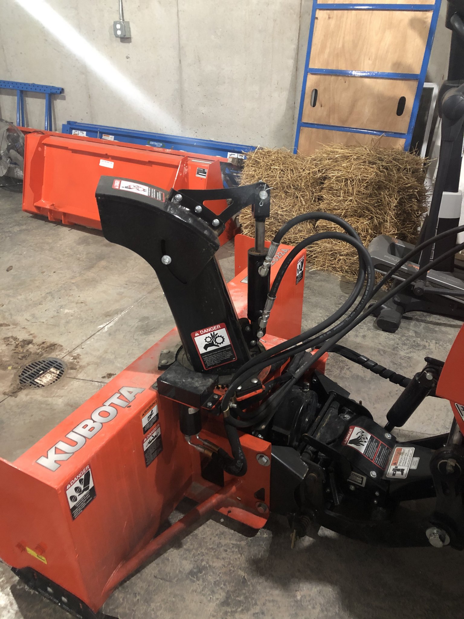

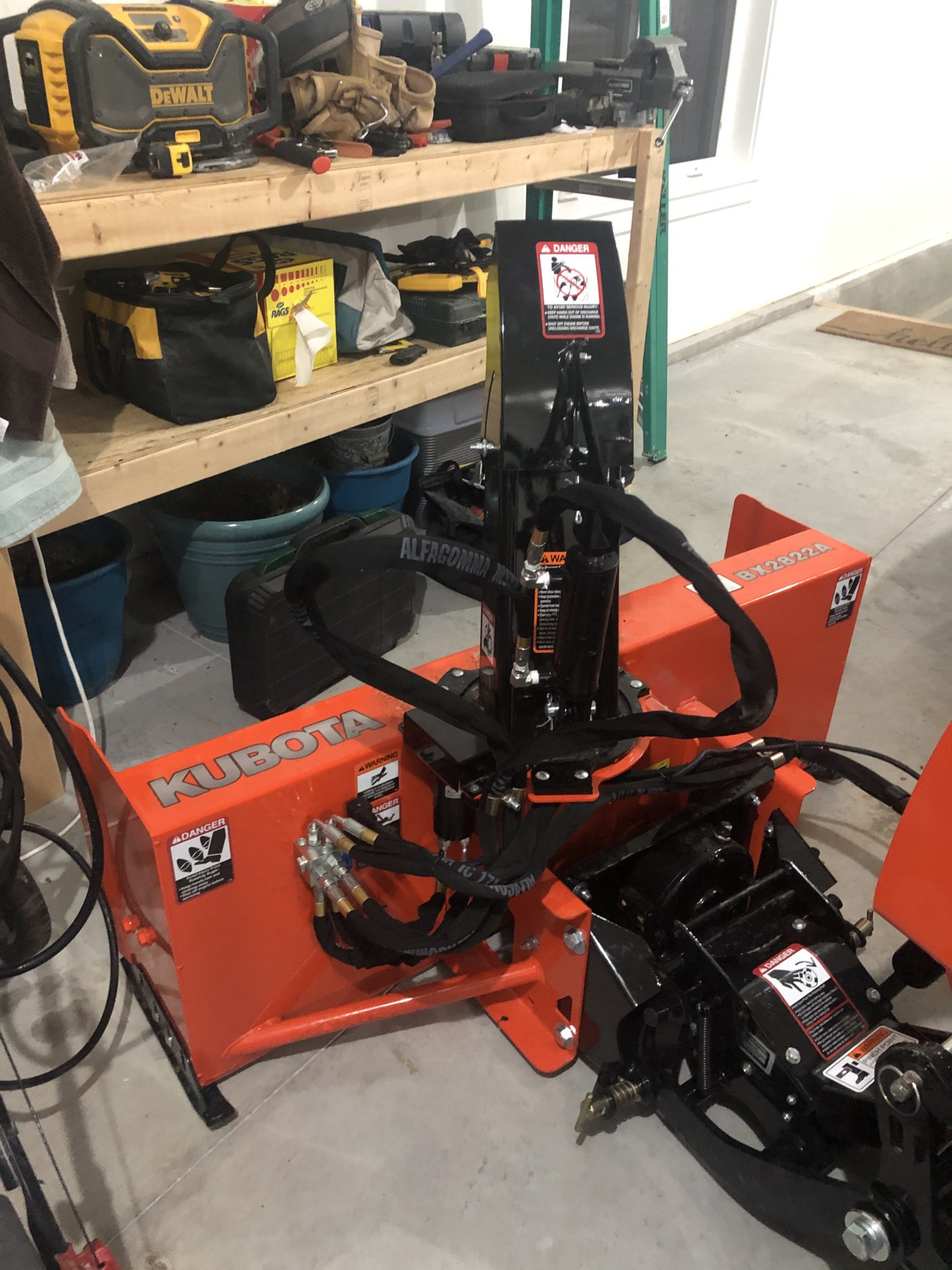

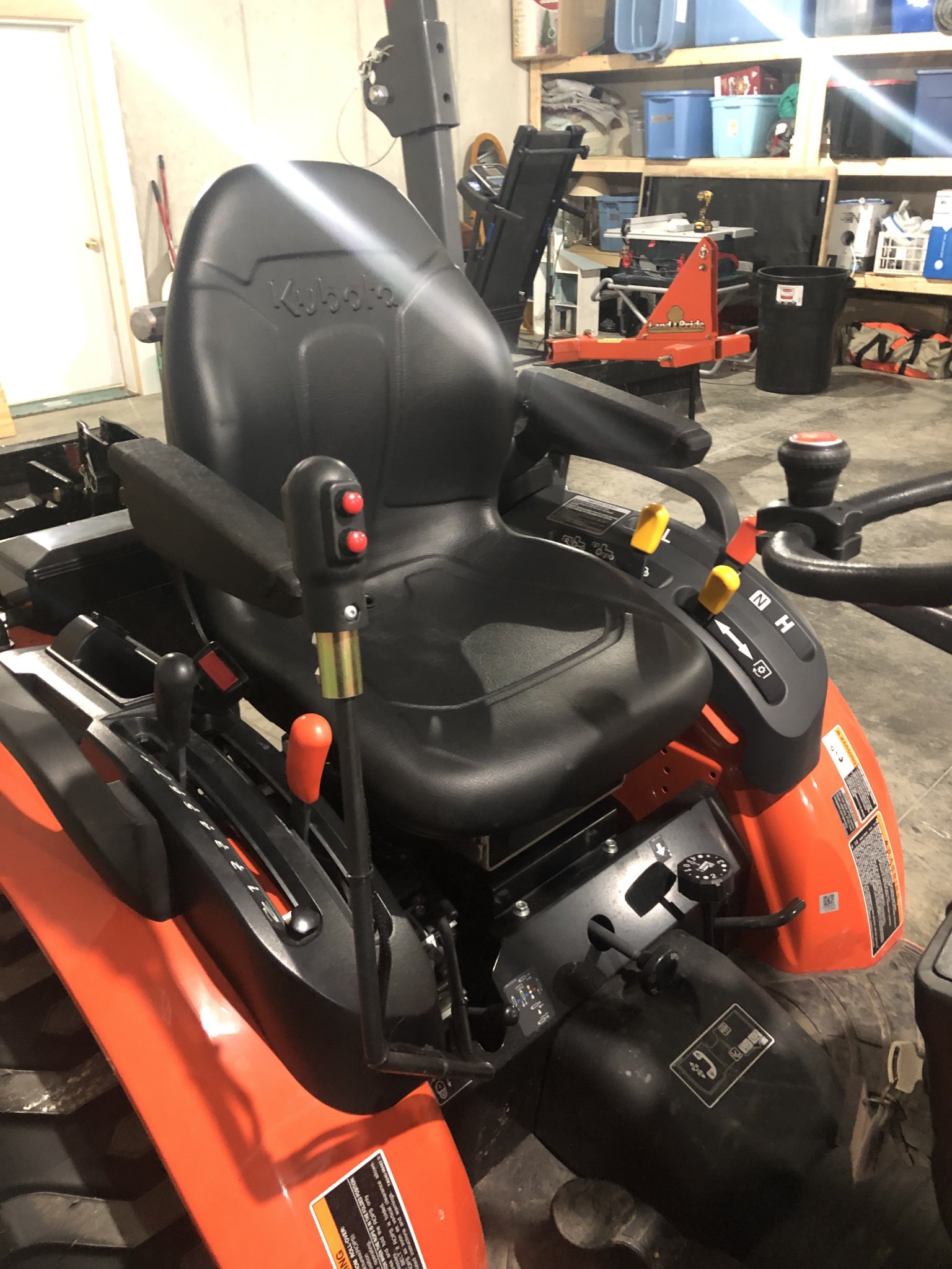

I called the dealership after this and they came back and removed the extra diverter, hoses and second control switch and ran two hoses from the hydraulic piston directly to the third function valve. Its much cleaner looking only having the two hoses and works great with the third function control.

I
Would love to see some pictures of your setup. The more the better. Problem is you paid for a bunch of parts you did not need.

THESE ARE AWESOME PICS. I really appreciate this!!!!!!!
I apologize for pointing out the extra parts you may have paid for....it's just my gripe about the hydraulic snowblower deflector kit setup.
I have to spend $1079 for the hydraulic chute DIVERTER, AND $1000 for the third function.
Somewhere, someone was telling me to just hook up the hydraulic actuator myself for like $200. Can't remember on which thread someone said this to me.
Like super nice of you to post these!!!!

Those pictures were PERFECT. Now I get to show my dealer how I want it configured.
