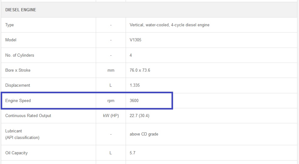

The following is a 2 pole Kubota V1305 powered generator running at 3,600 rpm.

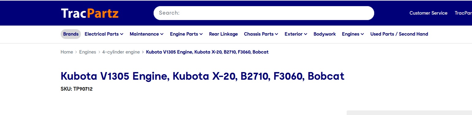

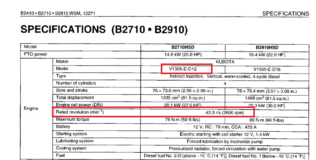

The same V1305, but a different version, is used to power these tractors which run the engine at a slower speed than 3,600:

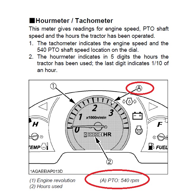

A F2690 (front mount commercial mower) I took delivery of last month is the first Kubota product I have owned. So far I have operated it for a couple of hours mostly chopping up some late falling leaves to give it a light break-in and I am happy with it. But compared to the owner's manual for my Deere compact utility tractor (a 955), the Kubota owner's manual is poorly written and lacking in detail. The manual is silent on operating RPM and with the digital display there is no rated RPM mark. The separate manual for its 72" mower deck simply states to operate the engine at full throttle.
So I am following the same basic method I have used for years with my Deere 955 compact with its 72" midmount finish mower and engaging the PTO at slightly off base idle speed and then increasing speed to near governed RPM for mowing and then dropping back to idle before disengaging. I will adjust as needed once I get some mowing time in with it this spring.

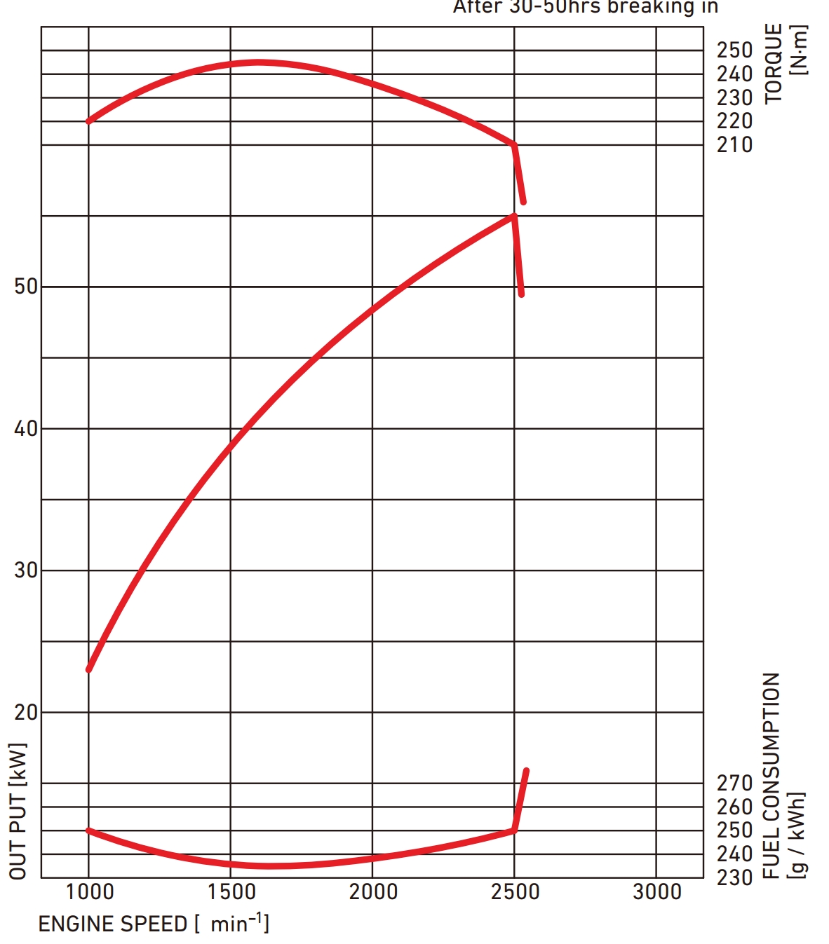

And on edit, this is the fuel consumption chart for the Mitsubishi diesel in my standby generator that shows how operating efficiency falls off when it is outside of the optimal operating range.
Rodger
