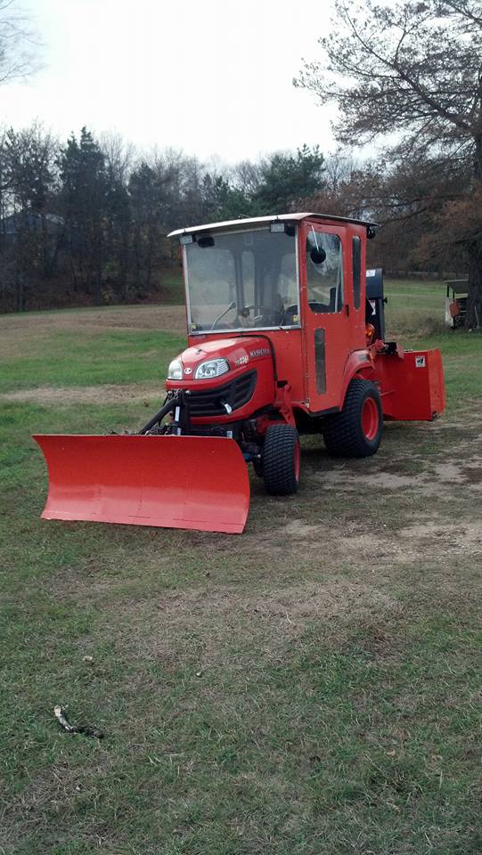

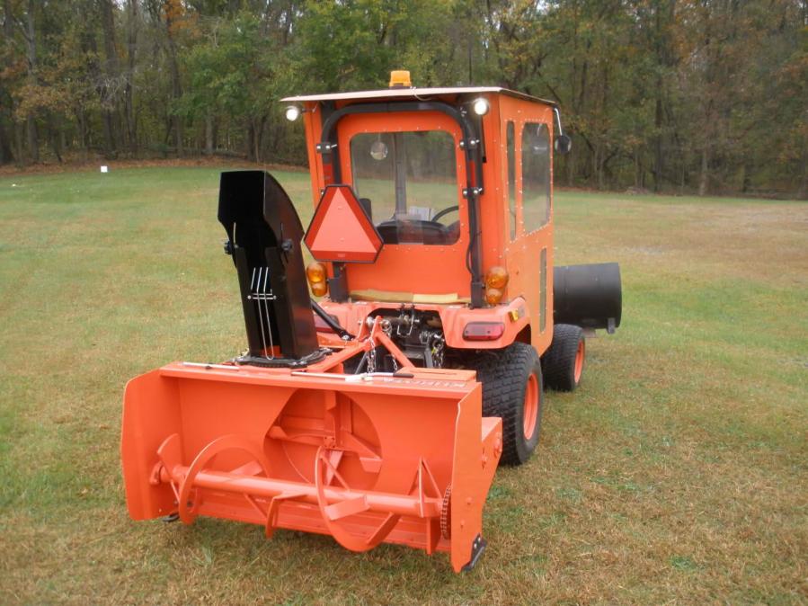

Hi,
I have a bx1860 with bx2750d blower. I am thinking of buying a blade to deal with slush removal (or for a quick pass at light snow removal). I was going to get an landpride RB05 5' rear blade to use in conjunction with the blower, but I also have the option to buy a use bx2763a front blade at a great price. I am trying to decide on the rear blade v. the bx2763a front blade. Any suggestions?
thanks!

I have all 3. Gravel drive is 300'-400'. The house garage is too low for the rops and canopy so I sneak the rear blade in it and pull the snow out. Bought the snow blower last year and worked like a champ till I hit some rocks and had to rebuild the central fan. One of those snow melted, base gone, snowed again and found a pile of rocks. :eek:
Bought the front blade this spring used. Tore apart and repainted it and with new hoses. Used for first time the other day, awesome. I figure I'll use the front blade till I get a good base then use the blower after that. Not too bad to switch between the front blade or blower with quick hitch.

went with the BX2763a - have used it a number of times this winter and it is faster than using the blower. The swap over is not too bad if I do need to use the blower.
