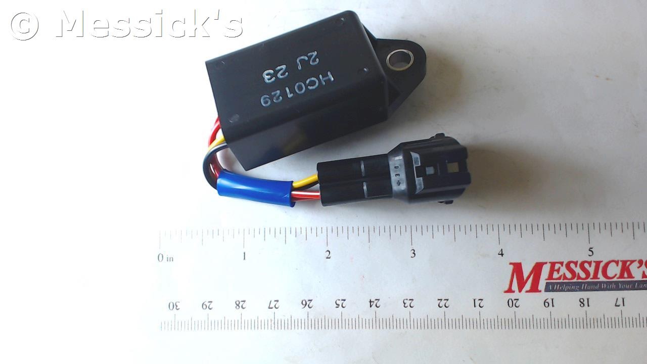

My BX 2680 starts and Idles but when you push on the peddle it stalls. I have drained the tank. fresh fuel and replaced the filters, still the same problem. Don't know what to do.
If you sense a 1 second delay before the engine stalls, then the Operator Presence Controller( OPC) is taking charge and having the OPC timer send power to the engine stop solenoid which stops the engine. The OPC timer is a one second device.
In your situation, you sense the stall as you push on the HST pedal.
I suspect the seat switch is making the OPC think you are not in the seat and the tractor is being moved.
If there is a tiny delay between pushing the pedal and the stall, then I think my diagnosis is correct.
Many owners, when they closely examine the seat switch wiring, find damage to either the wiring or switch.
The engine is stopped by applying power to the engine stop solenoid. If you disconnect its wire, then the various safety devices cannot stop the engine as I am suggesting might be happening
Dave

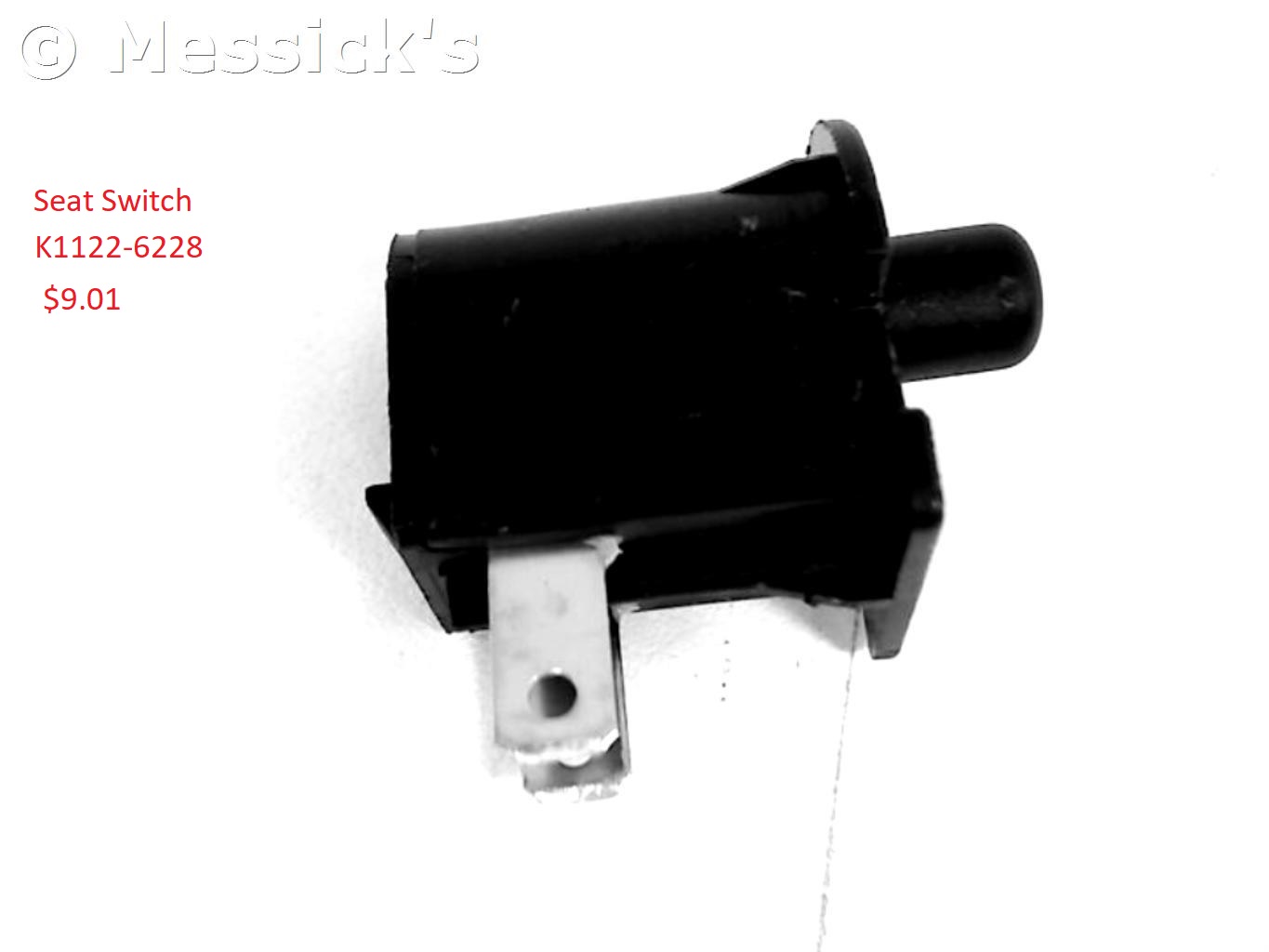

Let me make my point a bit clearer.
If your tractor is shutting down in approx 1 second then the OPC system is working as it should.
The problem will be in a safety switch which is providing info to the OPC timer/relay which is shown in the following photo.
The most common safety switch to give problems is the seat switch.
Because the shut down happens when you push the HST pedal that tells me the HST switch is working properly.
I do not know your specific tractor so the following is a best guess.
Instead of touching the HST pedal, try engaging the pto to see if the shut down also occurs.
Check the seat switch wiring. On some models the switch wiring has become chaffed and even disconnected from the switch.
Now the OPC system thinks you have fallen off the tractor and shuts the engine down rather than letting it move or power a pto driven implement..
Check carefully for signs of mouse or other rodents building nests and damaging wiring,

mine turned out to be the actual seat switch. I finally got out of the weather enough to test it properly. I did get the turn-over seat switch replaced and then removed the actual seat connector and jumped it and tested it and the engine dies about 1 sec after engaging HST if that harness isn't jumped. I'm not 100% sure both switches weren't bad. I will check the old turn-over switch and update you. if both were bad that would explain why I got turned around when trying to isolate which switch. but I will say it was like 10 degrees and mentally I wasn't exactly my best!!!
bryonh
bx2680
Feb 16, 2021
9
kentucky
ok so mine is fixed. there are two "seat" switches and its confusing because in the parts description they both say seat switch. The One pictured in this thread by another user is actually the tip-over switch, it is actually in the hinge are of the seat driver's left hand if behind the tractor, the seat has to be raised all the way up and then its activated, dealer told me it also had something to do with the back hoe option. the other seat switch is embedded in the center of the seat. In my case once I got out of the crazy single digit weather was able to troubleshoot and discovered the switch in the seat was bad. part number for the this switch is K1122-62280. Believe it or not, if you short this to ground (not the best advice) it will blow the fuse and kill the engine, you then can restart the tractor and run all day. keep in mind you OPC is disabled and not advisable. you will not be able to turn the engine off until you replace the fuse blown and you will have to pull the ignition stop fuse 15A blue fuse next to the OPC 10A fuse
The seat switch, which is what I would call the real seat switch, (the other switch is related and is in line with this switch but I would call it a "seat position" switch, if this switch is activated you are already way off the tractor! The part number for the actual "inside" the seat switch that detects you ar sitting in the seat is 32771-47840. There is a harness connector under the seat that can be disconnected, you can bypass it with to female narrow terminal connectors and 16 ga wire without ruining it. this is what I did while I wait on the part to come in this week. probelme solved. there is another switch related to the OPC its on the opposite of the pedal. Basically they work in away that if you are pushing the HST pedal or running the PTO and the operator cannot be detected then this kicks the timer relay which sends power to the stop ignition circuit killing the engine.
