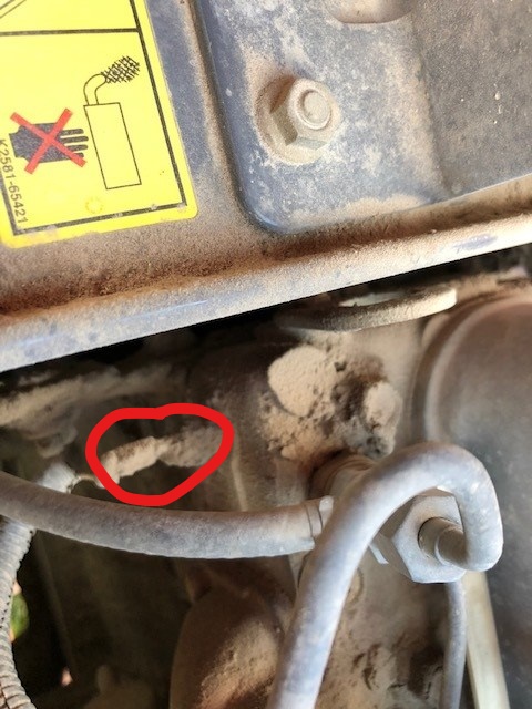

I still have not fixed this issue, but the engine has not run hot either. I want to pull the sensor out of the engine to test it, but I am not sure where it is. Is it on the front, left side of the engine block? See picture attached with red circle around the object.

You don't need to pull the sensor to test it, just use an ohm meter.
