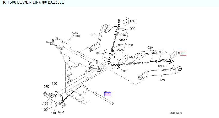

I recently got a BX25D and am learning how to use it. I am attempting to put on the 3pt system that came along with it, but it looks like it is missing a piece.
I have attempted to google and figure out what it is called and where I could find one. Anyone able to help?

Is the missing part the bar that holds the 3 point hitch arms to the tractor ? If so probably K2581-
38140
You can double check on the messicks website

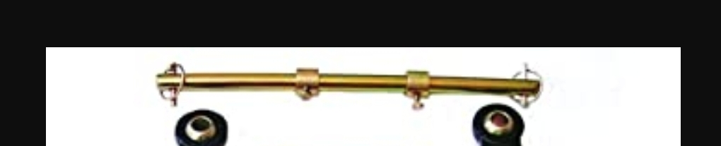

Thank you
That looks like a spreader bar to me. It's not something that you really need at all.
