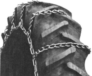

I always prefer a visual. - differences in chain types:
I'm either going to have to tie the cross links together, or invest in V-bar chains.
thirdroc, I'm thinking you would be better with them cross linked. V-Bar will get you a higher profile, but may still be dropping into the valleys more than you will like.
The one on the left wins every time hands down... Duo-Grip chain on R4 tire
The chain in the middle is an example of a 4 link, ladder chain on an AG tire.
The chain on the right is a 2 link, ladder chain on an R4 tire
Although, if it we me, with the chain on the left, I would have either cut off the extra chain or tie wrapped to the side of the chain on the sidewalls. :D
