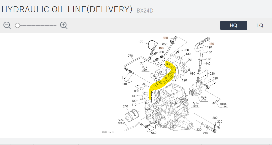

Finally got around to getting it back to level. Still has a leak, but has noticeably slowed.
Mentioned it to my local dealer when I stopped in for some mower parts and they printed the same picture that @North Idaho Wolfman posted and said it was likely the culprit.

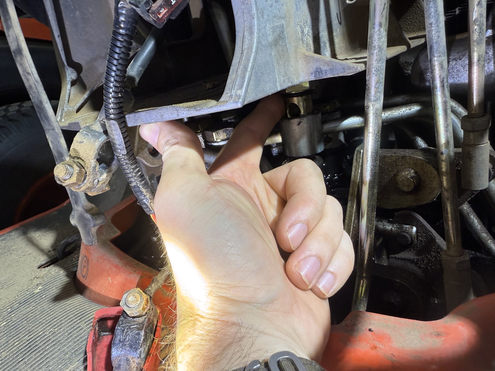

Found the leaky fitting. After cleaning it up there was some o ring visibly blown out. I did snug the fitting up a touch which slowed the leak. Looks to be the line that articulates the bucket.
I’ll order up replacements tomorrow. Since I’m this far in, should I just replace all of the o rings in the manifold/controller? One other looked to have o ring blowout but no leak yet.

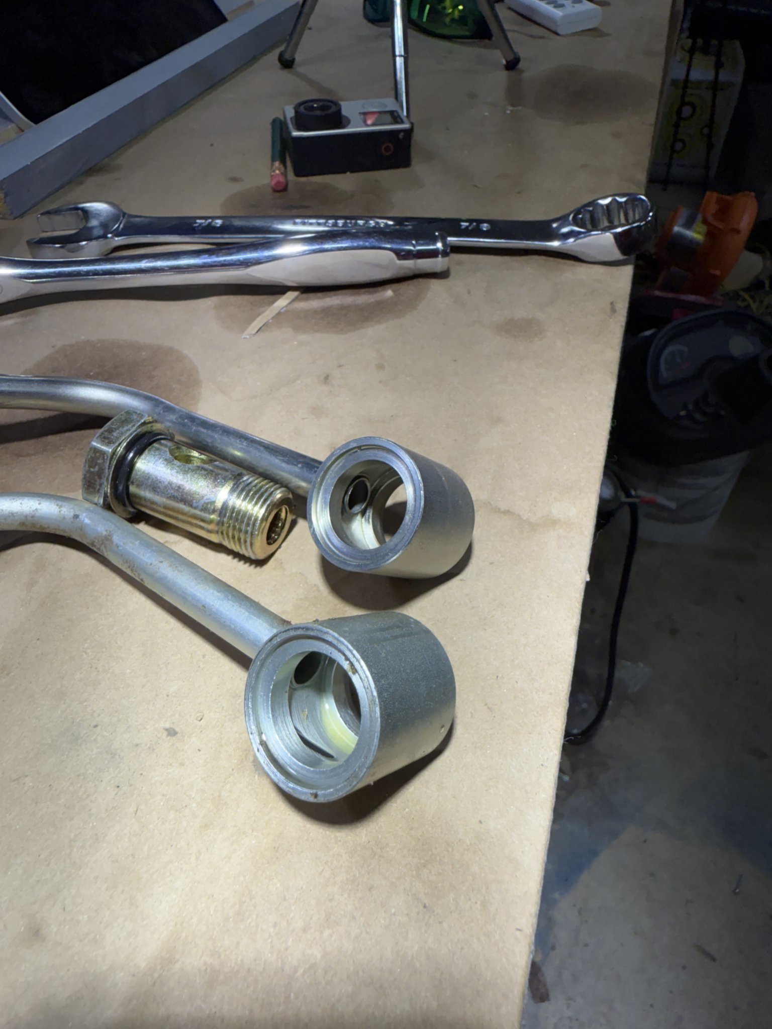

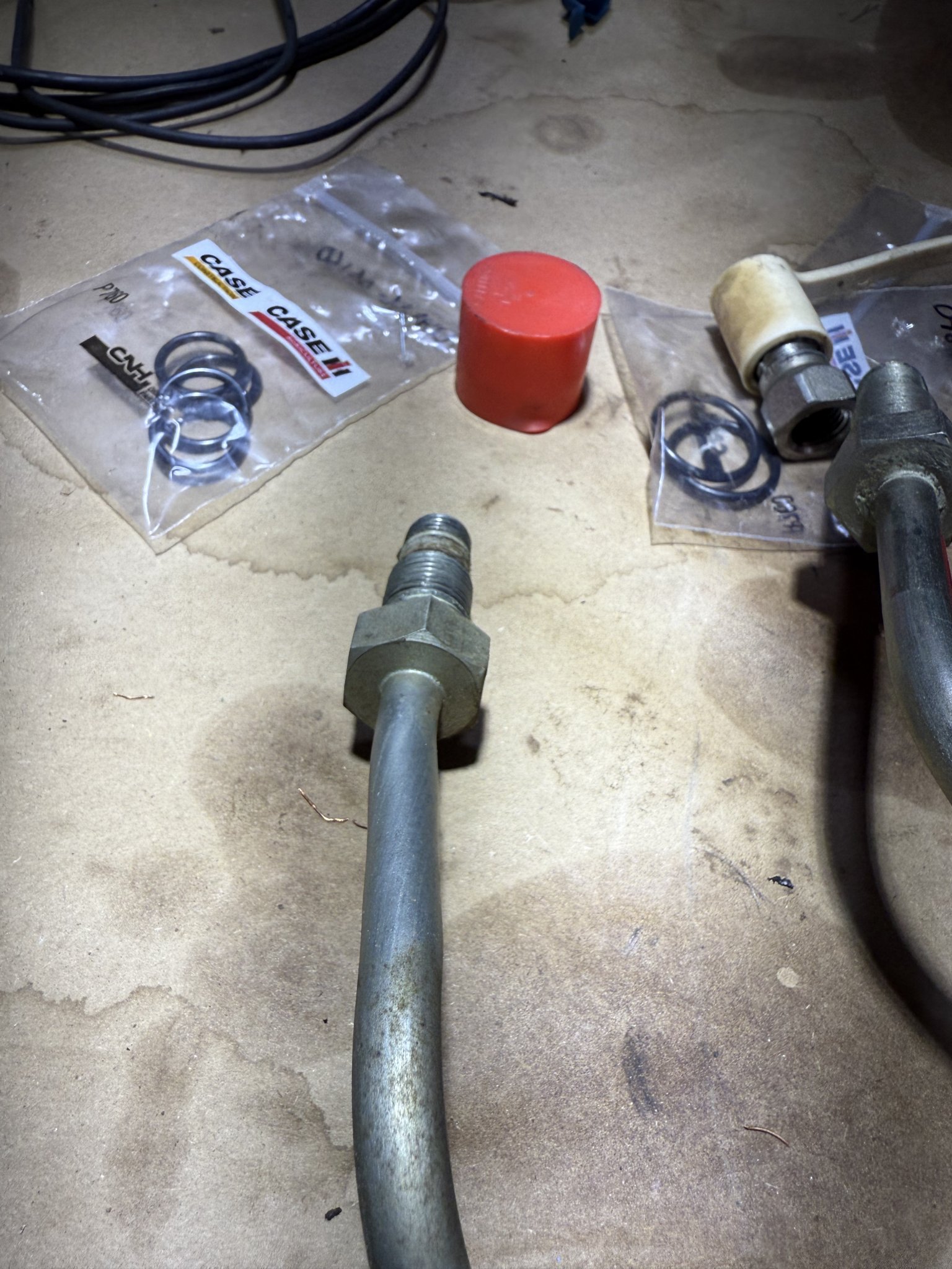

Made some progress. Another rainy week here in PA, so at least I’m not missing time on the tractor.
When removing the hard lines to the loader, one of them twisted while i was wrenching on it (pictured below).
Thought I’d do the right thing and get a genuine replacement from Kubota but the part that arrived looks awfully sloppy (top of the two lines pictured)
Any thoughts on if that’s enough clearance on the banjo bolt? Order up another? Stick with the original?
