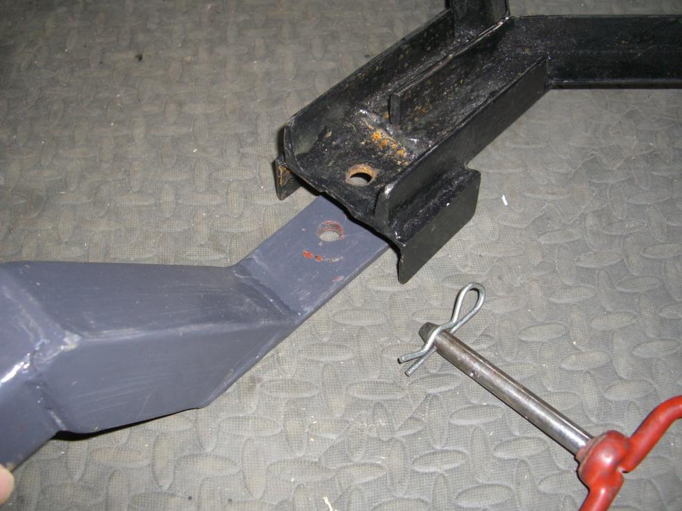

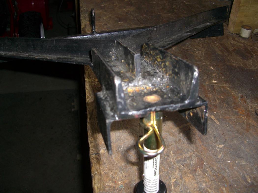

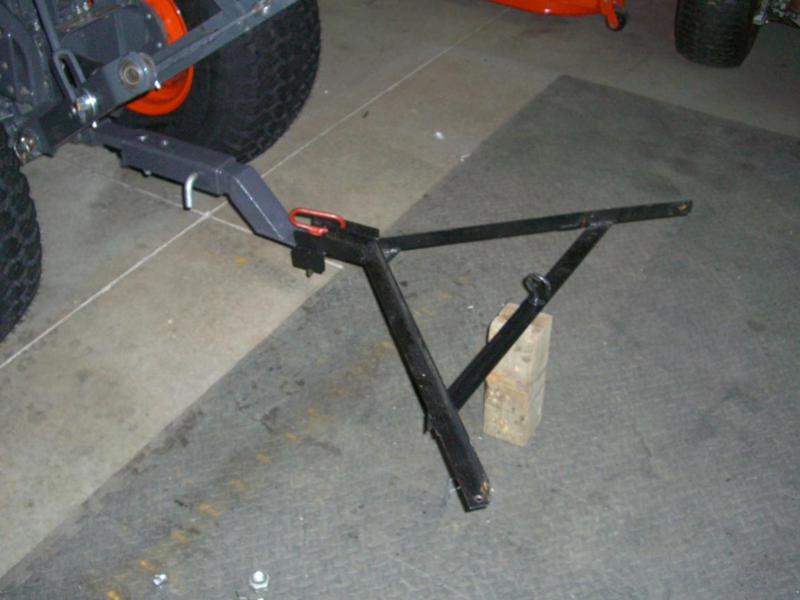

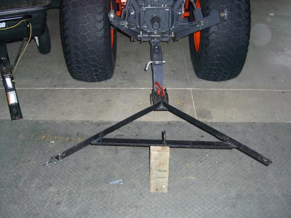

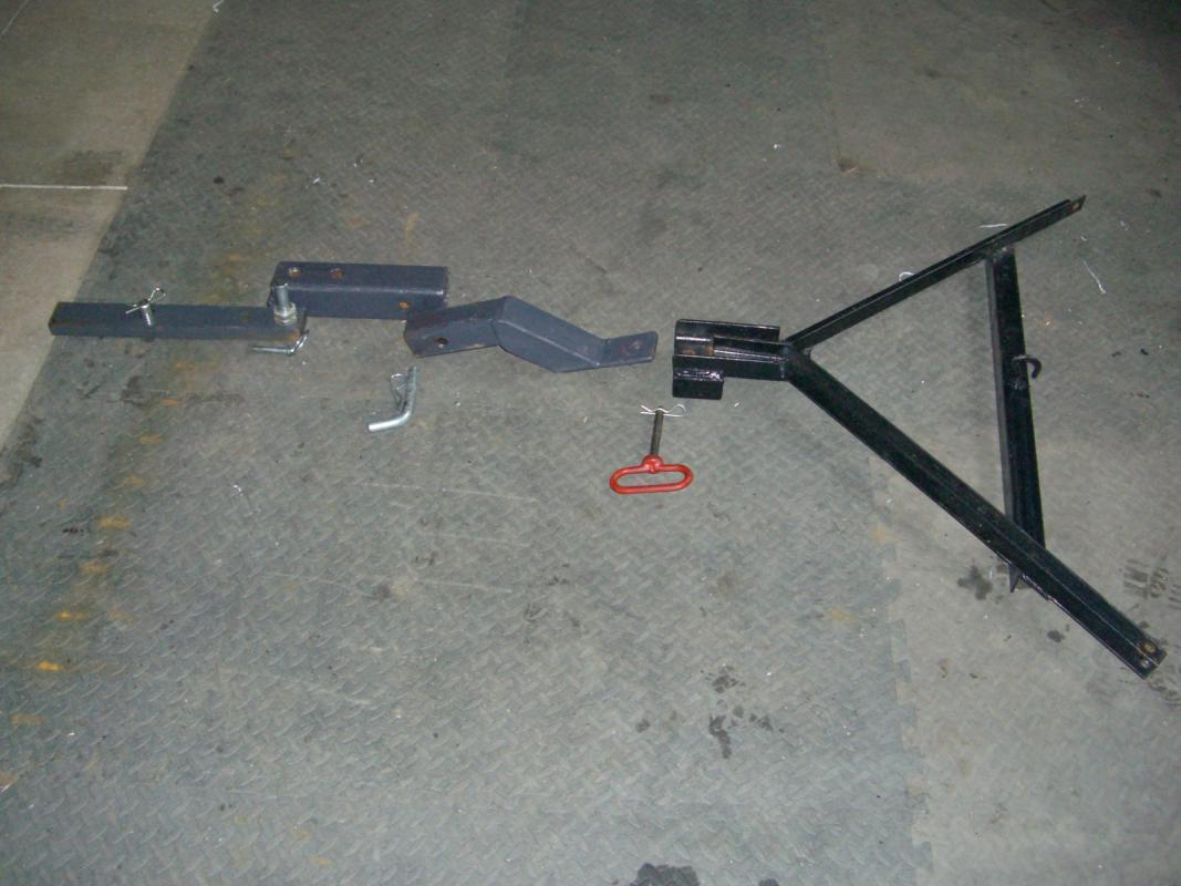

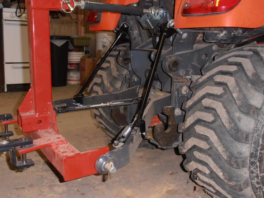

Following on from the drawbar extension and forgetting that the Cyclone has a set of caster wheels and need a rigid bar mount I have taken some pictures of a unit I made to stop my stone rake slewing from side to side.
I just constructed a triangle to attach to the unit, then where it mounted I used some angle steel to form a left and right stop. I could have made it exact size of the pin attachment but that meant cutting and rewelding so I went with what I had to hand.
Items of the total assembly shown.
Hope this is of some use.
