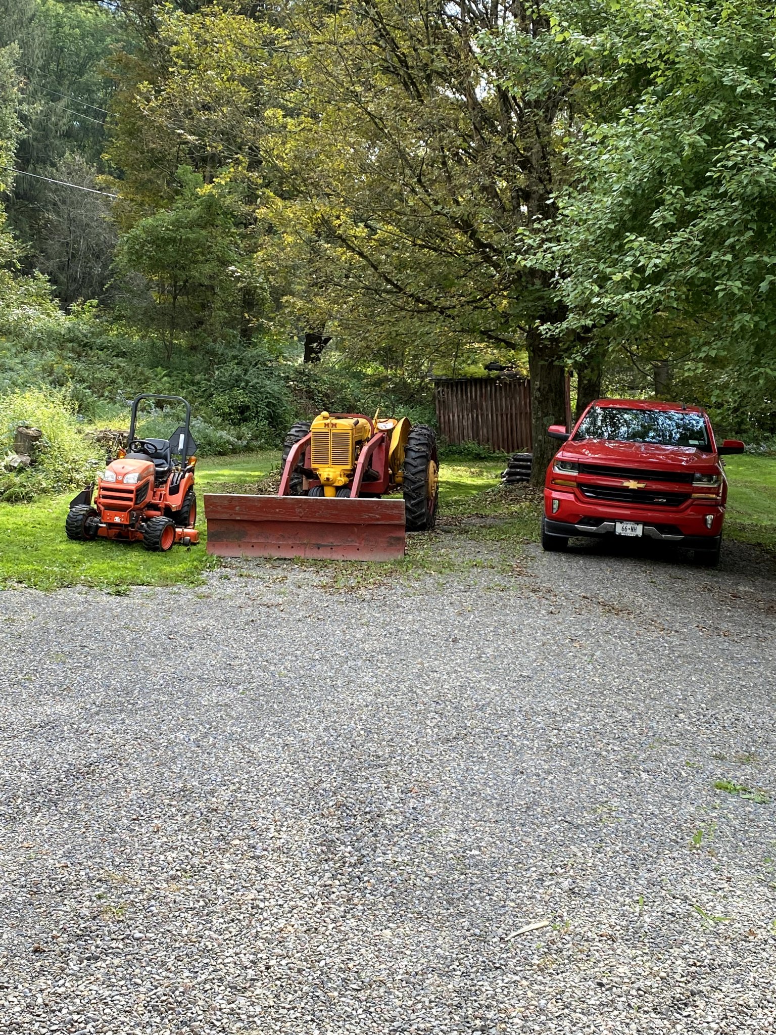

My BX2360 was a leftover model. '70 series were out. Friend was a salesman. Told him what I wanted, and literally never laid eyes on it until it was delivered. Got a great deal. Had been on both BX and B tractors while shopping.
Paid my 0%/60 month Kubota loan in 25 months, easily.
I should have bought a B then.....coulda/woulda/shoulda...🤓
I love my BX. Gotten a lot of work out of it. Betting it's saved me $7-10,000 in work I would have had to hire out without it.
But have shopped B's couple times over 9 years. I also have a front-mount snowblower, which adds considerable $$ to the transition, although my BX2750D will go on a B with proper front hitch.
Last priced a trade-in deal was about 5 years ago.
Keeping just my blower, and getting a new B2601 with MMM/FEL and front hitch left about $17,000 in difference. I couldn't justify it for the slight increase in capability.
That said, early-2020, I could get a "bare" B2601 w/ FEL for ~$20k, or B2601 TLB for ~$27k. Keep the BX for mowing/blowing. The TLB option actually had some attraction. Could add 3PH blower or mower if/when needed.
Can't have too many tractors, and my old '53 MM isn't mowing, blowing, or pushing snow at this place..... ;)
Skeets did a similar thing while back, and he has a BX2360 like me. Think it made sense for him, and might for me too. Just not right away....
