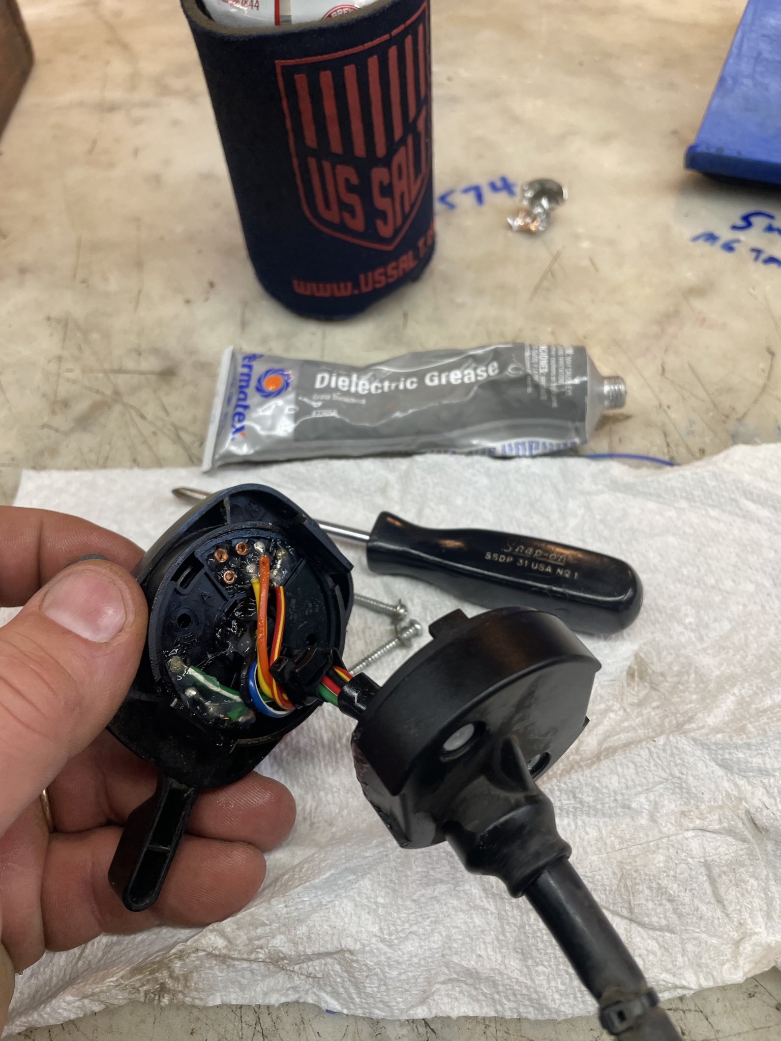

Finally had a minute to remove the switch and inspect it.
Seems the problem was just a sticky switch/button....
I cleaned everything up and lubed up the moving parts with dielectric grease.... everything seems to be working fine again.
