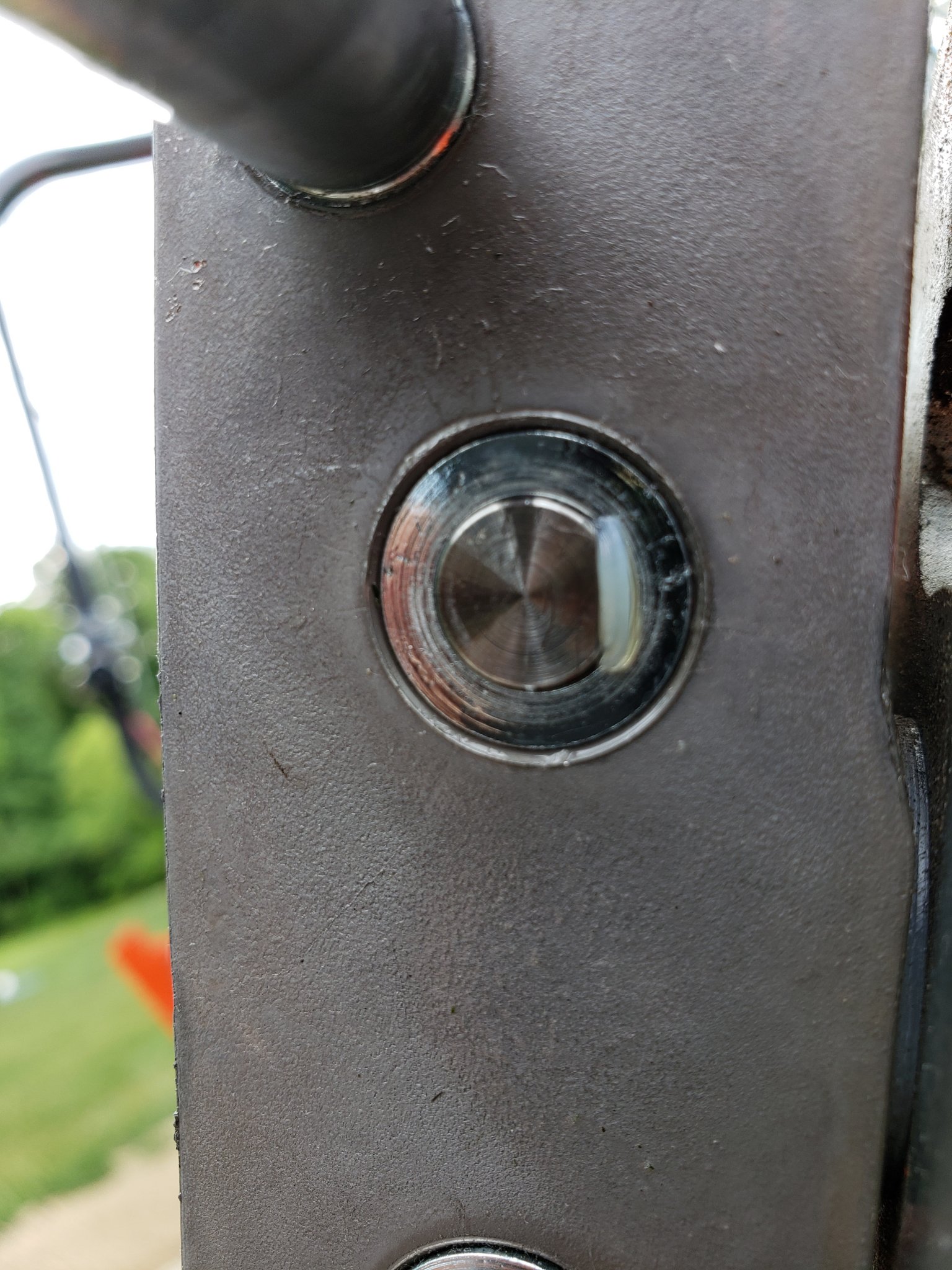

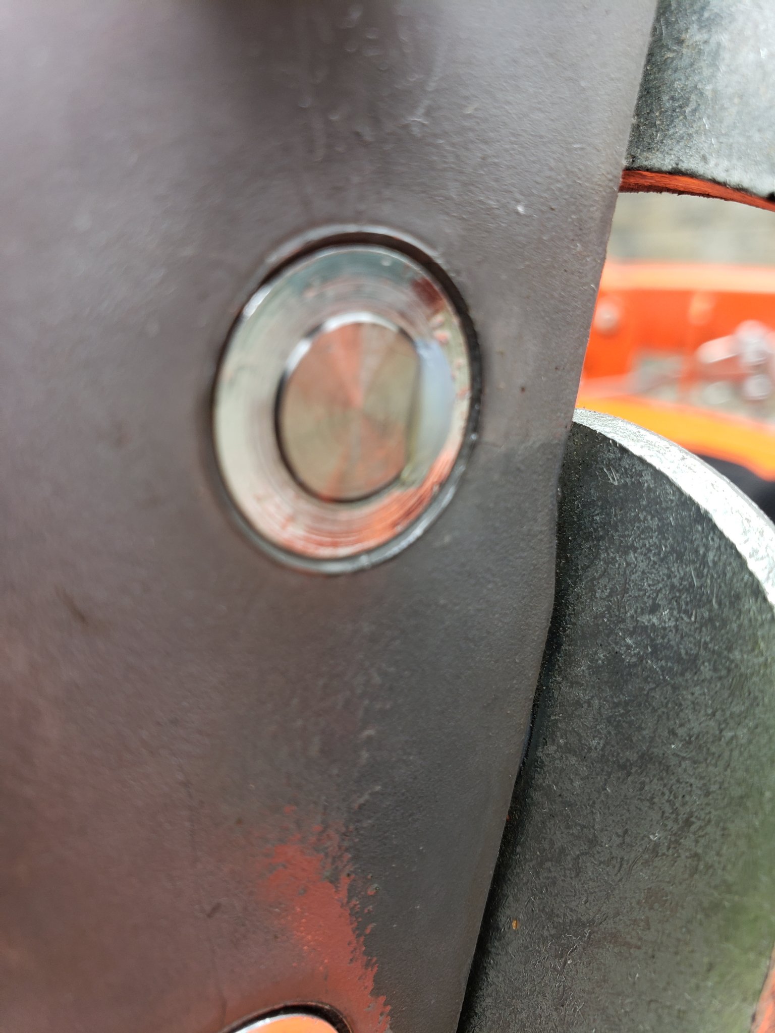

I lined up and tried to connect the hydraulics via the quick connect manifold. No dice. After two more position adjustments, the quick connect still wouldn't properly engage or lock. It was stuck about halfway down. I inspected the upper part of the manifold and found a piece of plastic or nylon stuck in the valve opening. See pic.
A quick call to the dealership service folks, and they advised me to remove the object and try again. I did remove the object, but it shot out of the valve and into the landscape. Couldn't find it. This time the manifold engaged and locked and we thought we'd fixed the issue, until the right side arm wouldn't lock onto the frame. I tried a few more times and remembering my lesson learned from years ago on my BX2380, disconnected everything and walked away. Service will be back out sometime soon to pick it up a third time.
Aside the normal gripes about having no machine, and being unable to do the work I bought the machine to do, am I crazy to think I bought a defective unit? This unit now has 17 hours on it, and I found the initial FEL / BH issue at 3.5 hours. What does everyone suspect was the plastic piece in the picture? Valve seal? Piece of broken hydraulic pump? My hobby is using the machines to get work done, not becoming a service tech. Any thoughts? I'm beyond disappointed and frustrated at this point. Looks like no corn for me again this year.

The pics I posted show the upper (movable) part of the FEL hydraulics quick connect manifold. The port is jammed with a piece of plastic or nylon material from somewhere in the hydraulic system. This is on the red port. I agree with you about getting troubles fixed and keeping the machine. I'd hate to go through this again, or see anyone else do the same.
