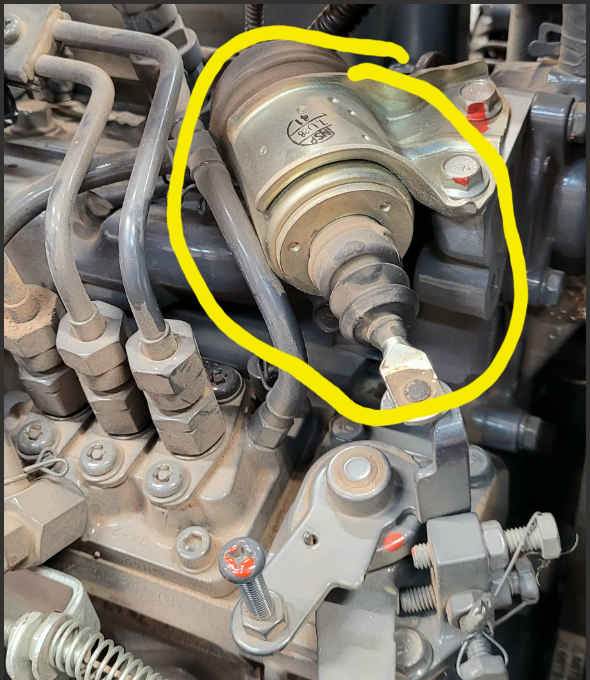

That's the solenoid that kill the fuel to the injector pump. When you turn the key off, it'll move that 'rod and arm' stuff a bit for a few seconds, then return. If it ever fails, you just manually move the arm and engine stops.....
Of course, it is a diesel. Duh ... on my part. I thought maybe it was some pollution control nonsense. Did you happen to take a peek at the video in my last post re fuel flow? I'm looking for any feedback as I have no idea what's "normal" for fuel pump flow.

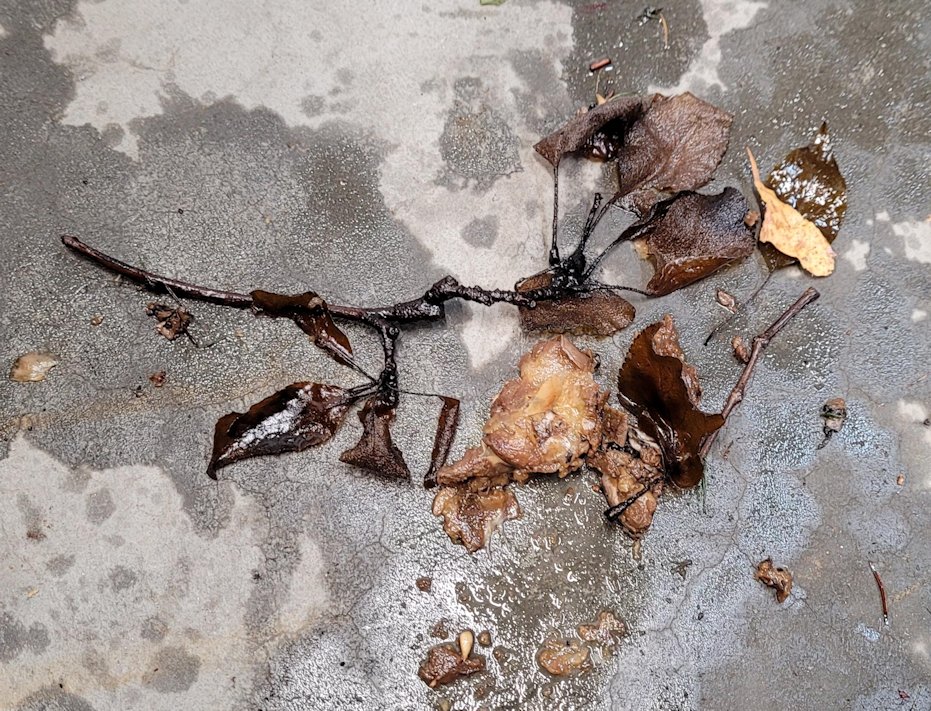

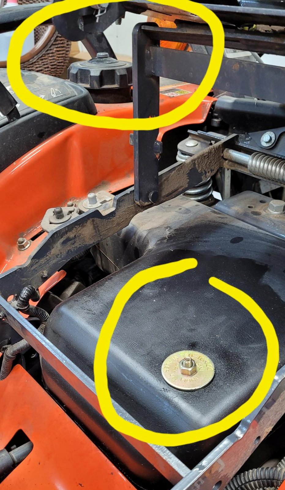

Well, I found the problem and I'm guessing this is probably a first for most of you.
Knowing the tank was plugged, I cut an inspection/clean-out port just over the fuel sump. This involved carefully cutting a 1-1/2" hole with an exacto, which took a while. The following pic (after debris removal) is the hole plugged with rubber compression plug found at Menards for ~$3.00. After filling, it doesn't leak at all, so this is a good alternative to the 8 hours+ or so it would take to pull the tank.
Early last summer, I made a couple passes around the yard after refueling and forgetting to put on the fuel cap. Apparently, I must have brushed by the pear tree as the following pic shows what I found inside. Of all the damned places for a pear/branch to fall, where does it go? A swish shot right into the tank that would have impressed Michael Jordan. No surprise, however, as I've known for years where I fall on the bell curve of fate.
Anyway, after pumping the tank nearly dry, I was able to suction all this crap out of the tank with pump and various grabby tools. Refilled with about 1/2 gallon of diesel and repeated the suction. Small pen light showed nothing of any concern left in the sump, though I fully expect to have to replace the first fuel filter again. Not a big deal as I now know how to do that quickly.
I'm sure when I mowed without the cap, I was filling the tank got waylaid with someone else's problem for an hour or so and forgot the cap, as I have never done that before. While this remedy was certainly faster than pulling the tank, I have learned that from now on, I don't care if the house is on fire ... I will not stop the refuel until the cap is back on.
Also probably wouldn't hurt to make some sort of micro-filter insert for the filler hole in the tanks as well.
