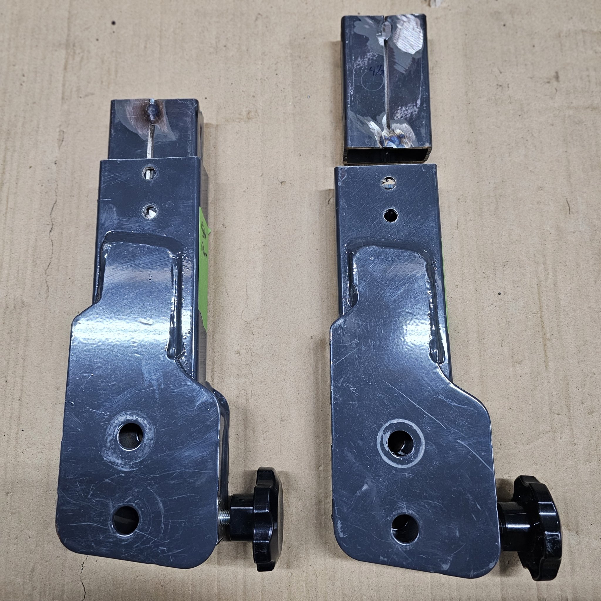

BX23s - CHOP THE ROP

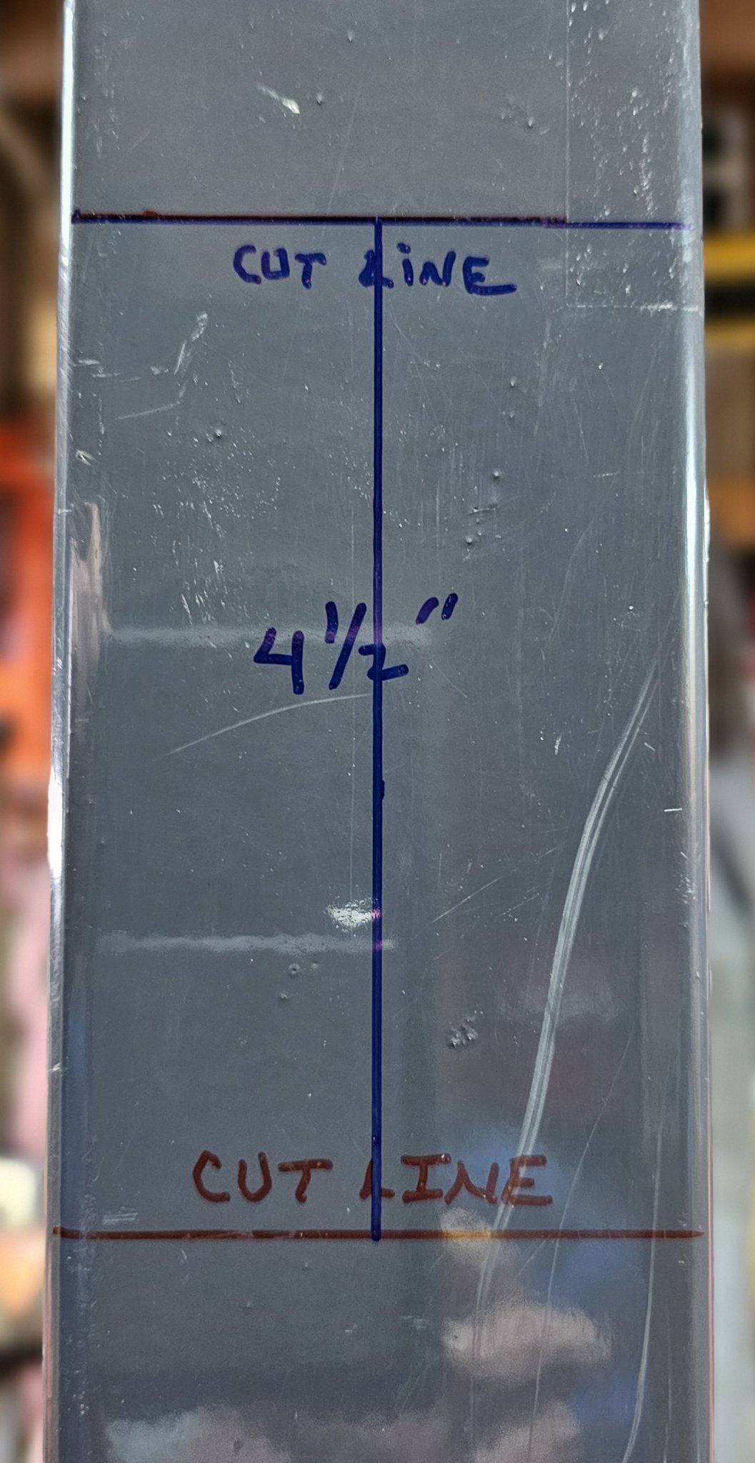

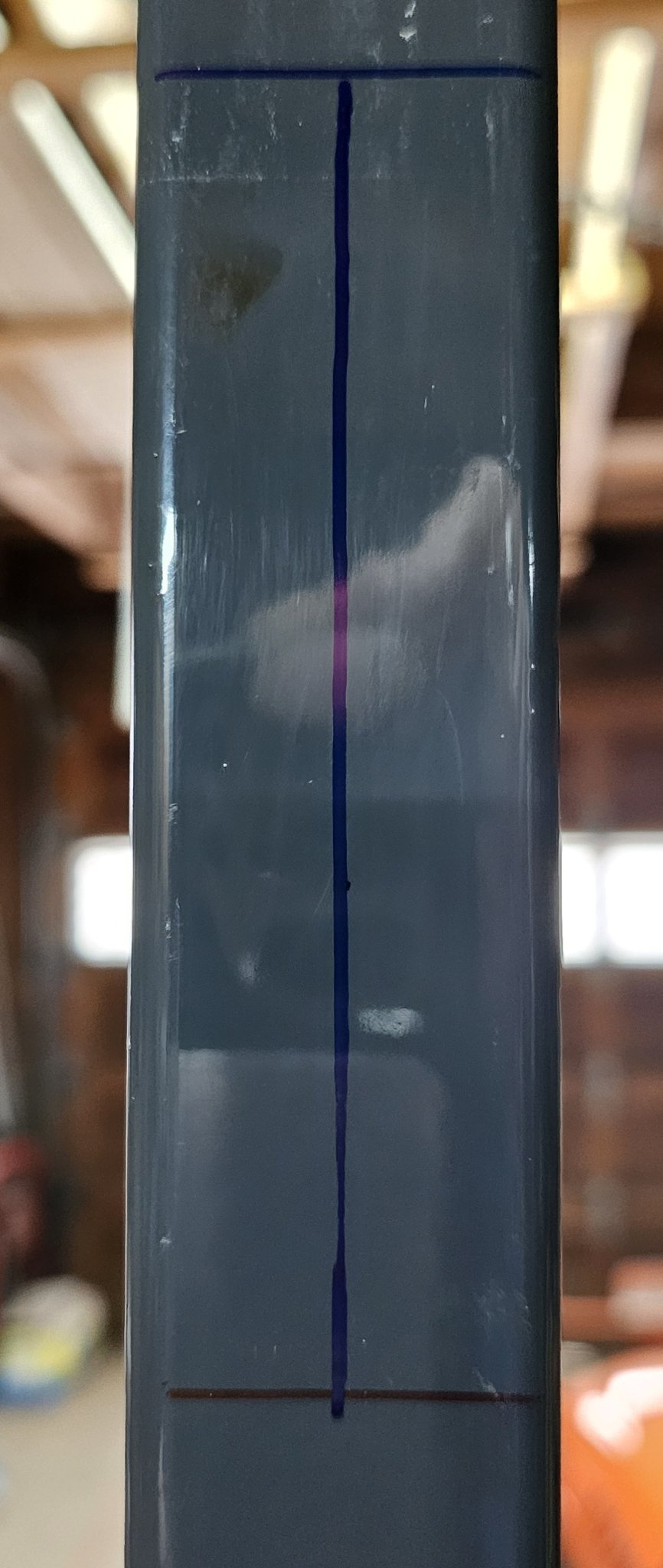

Height shortened 4-1/2"

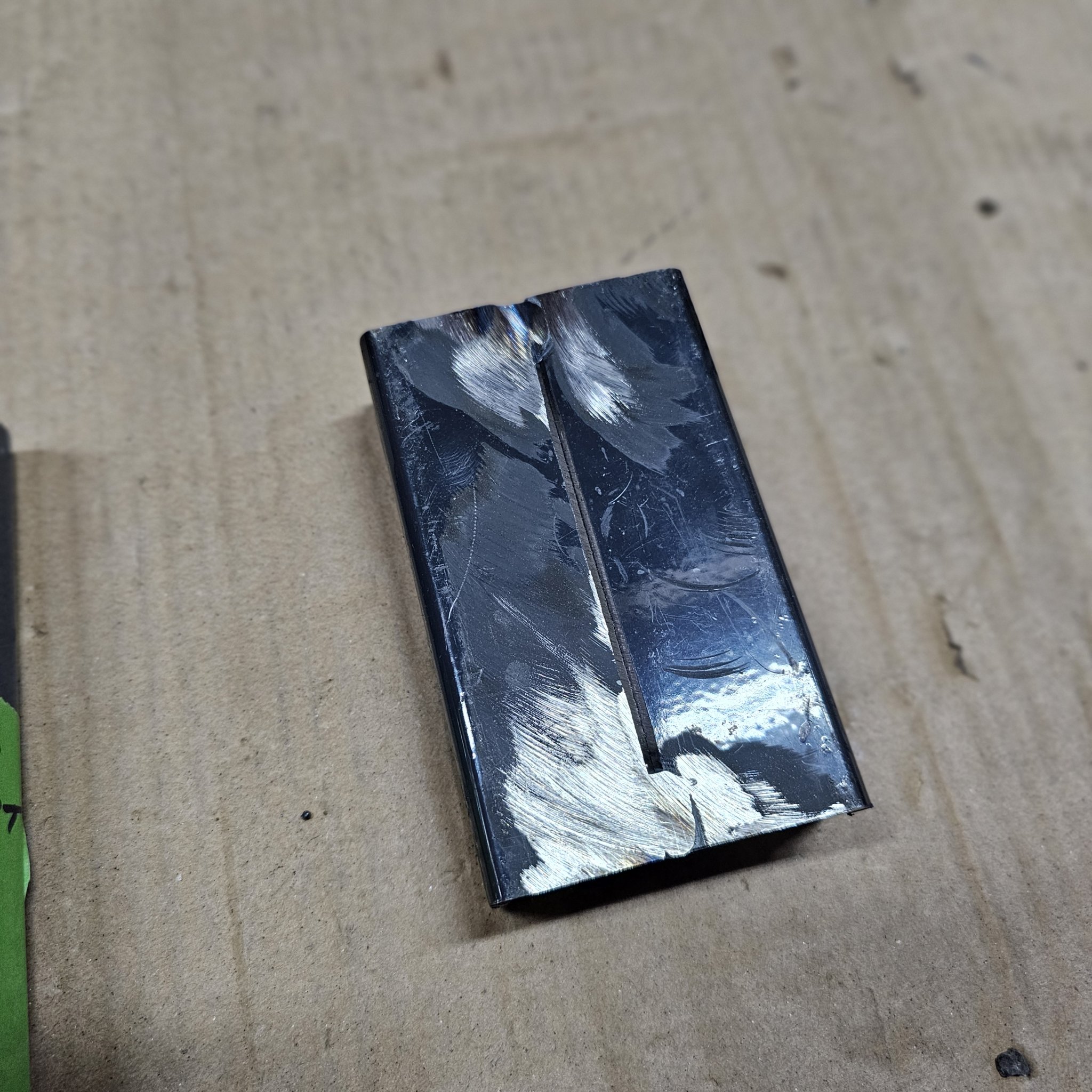

Drilled and sleeved (from the piece removed.
Thought I'd share.
Halved in all directions. I used the piece I removed, to make an internal sleeve.
Drilled a few holes so I can weld the sleeve to the bar, top and bottom.
I'll post more pics after I get it done.

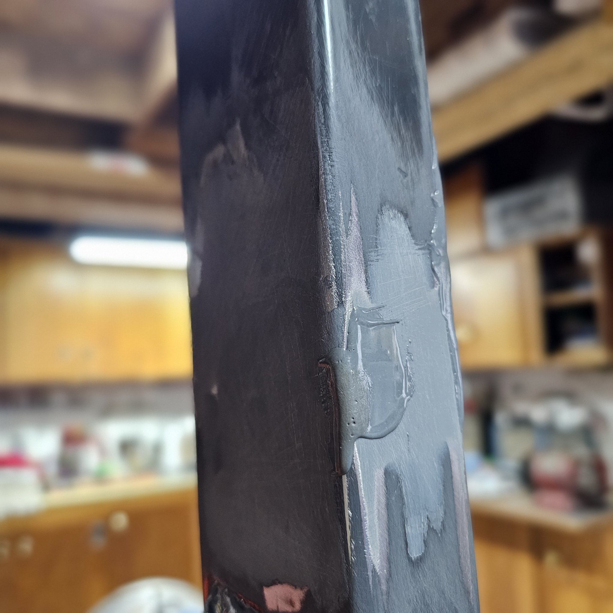

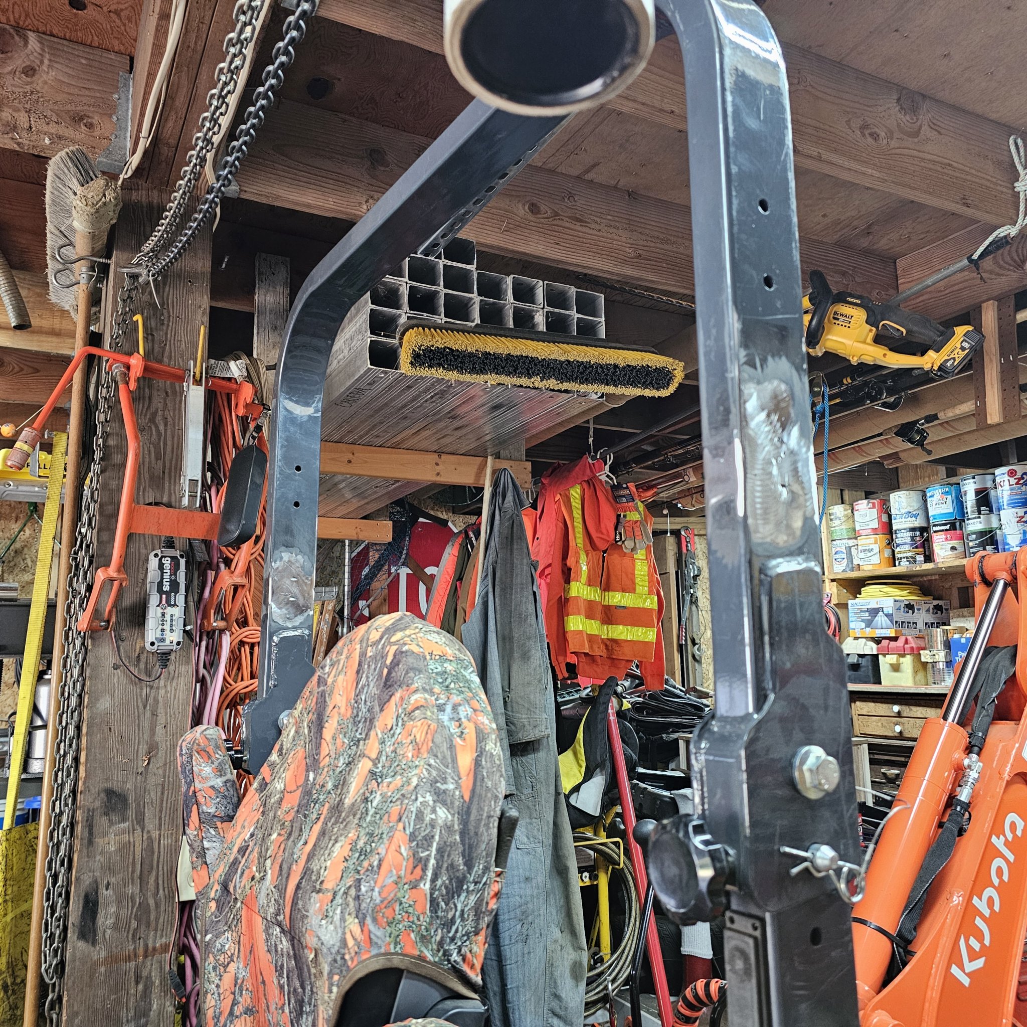

The ROP Bar is done. Now I can leave it up!!
There are a few low spots that I'll get some auto body finish putty for. Gotta be smooth before I prime and paint.

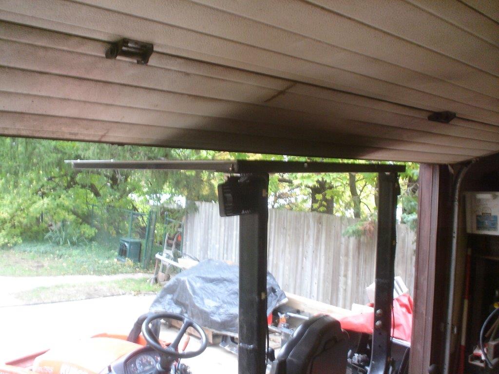

OK, finally found the one picture I have of my ROPS mod101
I recall seeing that image. It's not very clear, but it works for visuals.
I painted all the structures on my property this Summer. When I backed into the header after, it wasn't a good feeling. It bothered me so much, I made a sign on white plastic cardboard. It looked good, but never worked. I hit the header again within days. After another half dozen occurrences, that was enough.

The ROP Bar, I expected it to be a minimum of 3/16" thick, it was 1/8". Making the plugs was somewhat tricky. Once inserted, I used a small piece of 1/4" for a spacer at the joints, then placed narrow pieces of flat bar on the sides and face to hold flush, (with the areas at the corners open for spot welds) then clamped the snot out everything. It was a bar clamp maze...hehe. Once everything was spot welded at the corners, the clamps all went away for fitment to the lower half. All in all, it went pretty smoothly.

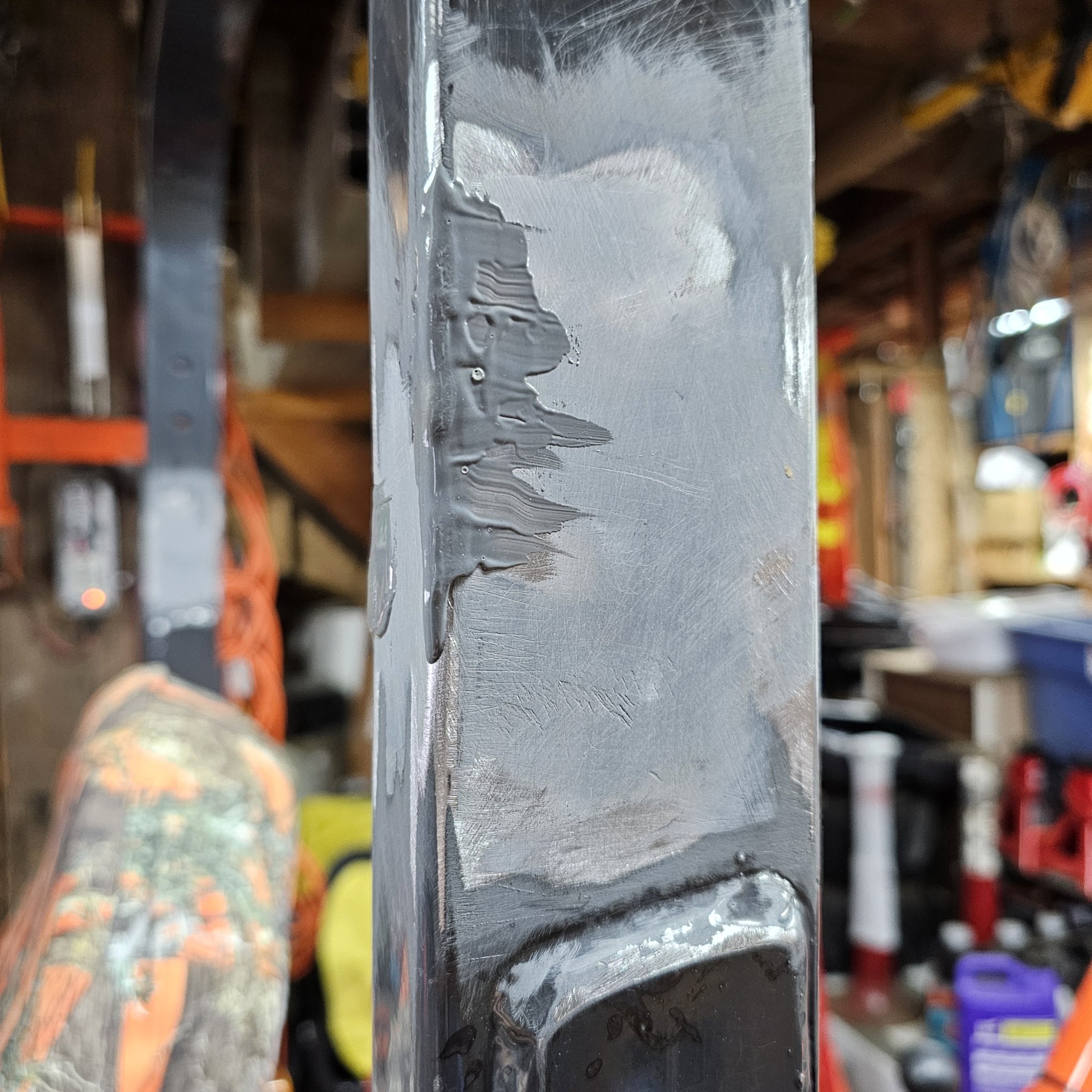

JB Weld worked GREAT to skim coat. It block sands nicely. I spread the final couple low spots this morning. I'm real pleased with how it turned out.
