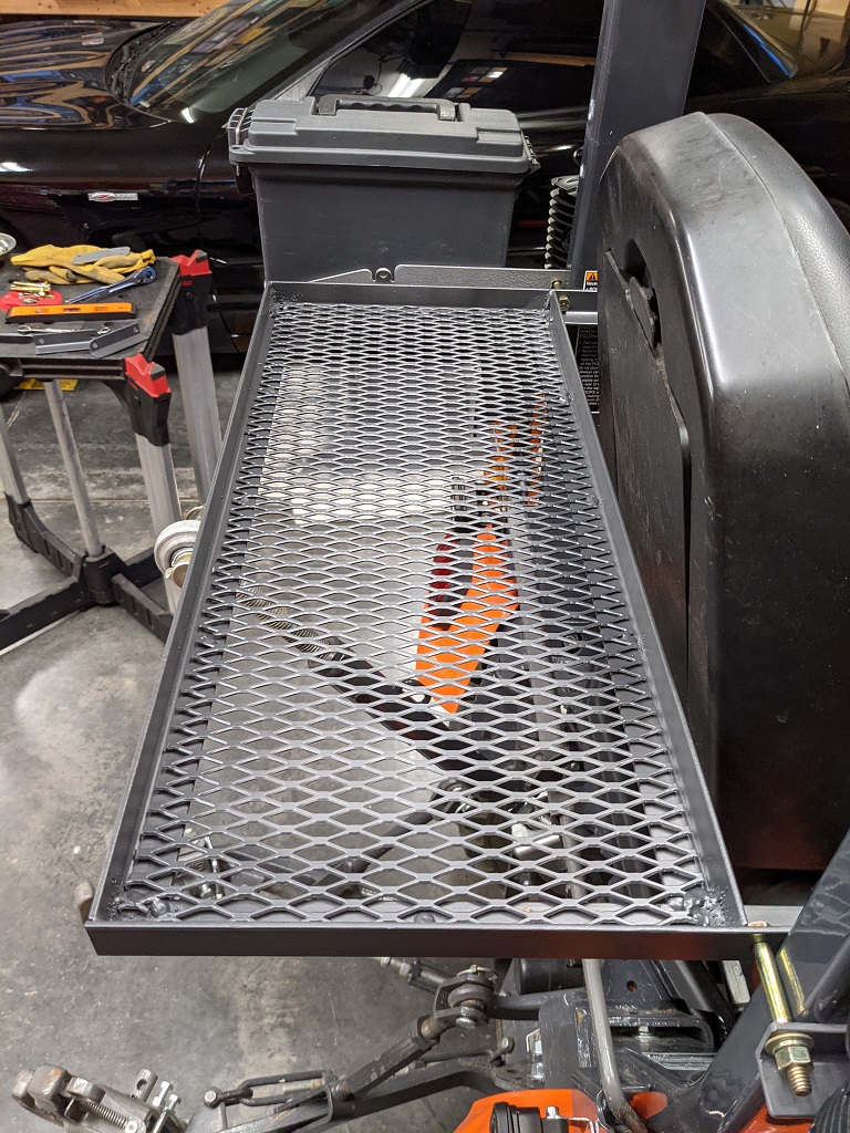

Nothing fancy - just some 1" x 1" angle, some expanded mesh, some Grade 8 hardware and a rattle can of Kubota grey paint.
Finally have a good place to carry stuff. I am going to add a few tie down hooks for bungees, ratchet straps, etc.

Looks good!
BUT are you sure the top link will not hit it when you have an implement on the back and raise the 3PH up?
On my BX the top link will go up much higher than where yours is at when I raise an implement like a rear blade or landscape rake all the way up...
Edit: But I did modify my lift rods by drilling a hole higher up, to get more lift out of the 3PH arms, so I could swing a 6' blade and rake around without hitting the ground, so maybe in your case what I questioned is a non issue.

Well, I have three attachments I use - a tiller, a bush hog and a chipper. On all three the top link is usually close to horizontal while in use. When I raise them up it is about 3 inches from where it is at rest so I guess in my scenario I'm good.

Finished her off the other day - I added the tie downs and a 1/4" thick rubber mat.
