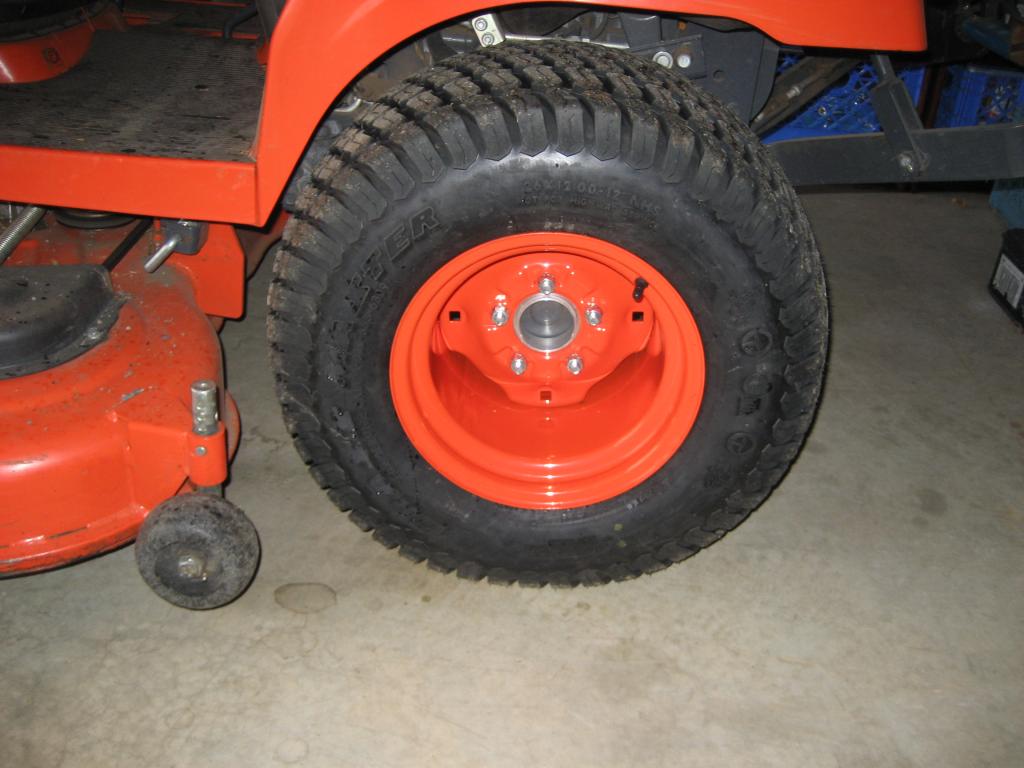

If you take a close look at the attached photo you will see that the lip on the center of the wheel spacer is slightly smaller than the center hole on the tractor wheel rim. That is okay. That lip on the center of the spacer does not interfere with the tractor wheel fitting on it. If that lip on the center of the spacer were larger than the center hole of the tractor wheel then you would have a problem. I looked at the spacer in the link that you provided, and in my opinion you should not have a problem with those spacers.

I just measured mine. The lip is 2 3/4" across measuring the outside diameter.

BXHoosier posted a picture above of a spacer that is not hub centric on his BX. Since BX wheels are lug centric seems like this should work fine.
The other spacers mentioned are hub centric, but this has no effect in the mounting of the spacer to the hub, which is not hub centric. And the lip that enters the wheel is actually a bit smaller than the wheel hole (by a couple mm in my case) so it really has no affect when the wheel is mounted normally.
