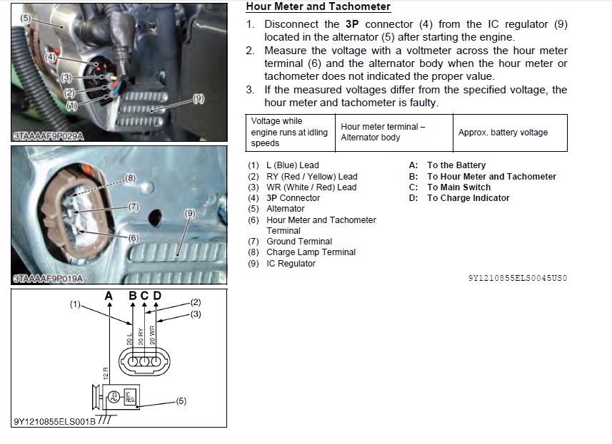

Your BX gets its tach signal from the alternator, the BLUE wire from a 3 pin connector plugged into the back. It controls RPM and HOURS.
5,724
3,037
If you can put a voltmeter on your battery to see if it makes about 13+ volts after engine-start you’ll know if it’s the alternator or the tach-sense wiring. ;)

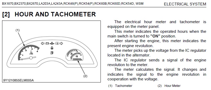

See descriptor and diagnostic pages from WSM
Dave
