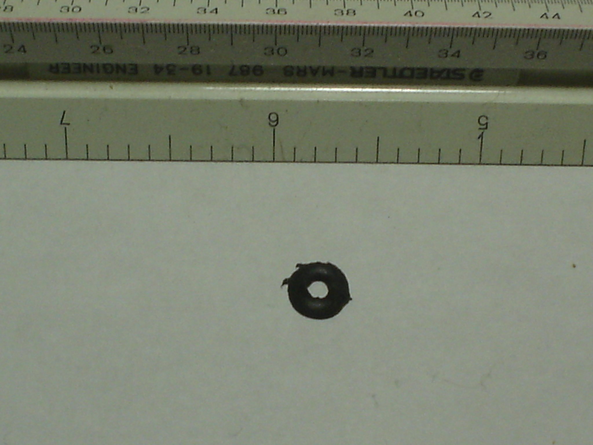

I'd bet it's the tank, but hard to tell.
I'd start with the less-messy stuff first. Seems like someone used a modified little fish net type thing....was a good idea as I recall.
Greensvillejay from Canada will show up.
He found a small rubber gasket/grommet type thing that was plugging his tank.
