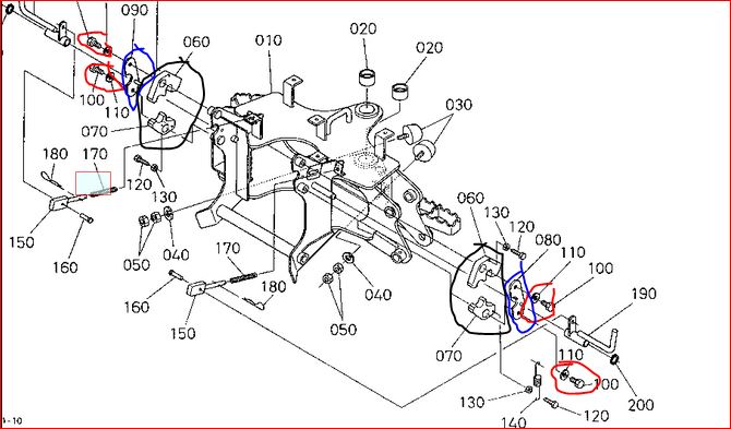

Completely support the BH.
Unbolt the bolts (in red) remove the latch covers (in Blue) and clean and or help open cams (in Black)

Can't unbolt those while the backhoe is on the tractor. I was wondering if I could get the snap rings off and drive out the pins the clamps clamp onto. Looks like you could if support the backhoe.
