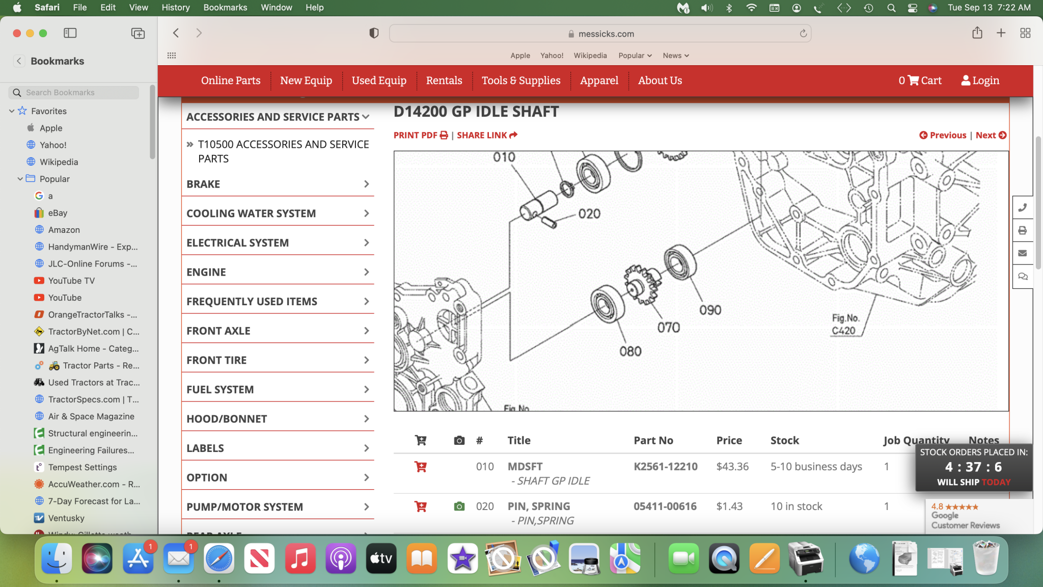

Do you have a pressure gauge capable of 2000 psi? Ideally we would check pressure and flow at the top port just to the right of the "A" in the parts diagram you posted. We should get pressure there with the lever in the raise position.

The slot in gear "070" drives the pump. Did you get a look at that slot when you had it apart? Does the drive tang on the old pump show any signs of having spun in the gear slot? I have read here of other brands with that drive set up having issues with the tang drive slot wearing out to the point the pump shaft slips.
