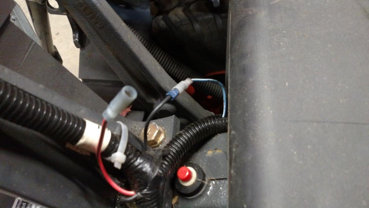

Thanks for the info. I know I saw the work light wire under the seat and close to it where the harness tees there were a male and female wire outside the harness plugged together. It seems like one of them was black or red.
It wasn't really a big concern since I new it wasn't overheating, I was just curious why sometimes it was off, and other times was on.
A bit more investigation will be done.
I'll post what I figure out.

Well, I found the reason the HST light was on. The blue/white wire under the seat was connected to a black wire that was connected to ground. Once I disconnected them, the HST light went out. Why someone would connect it to make the light on all the time is a mystery, but now I know what that the cause was.
