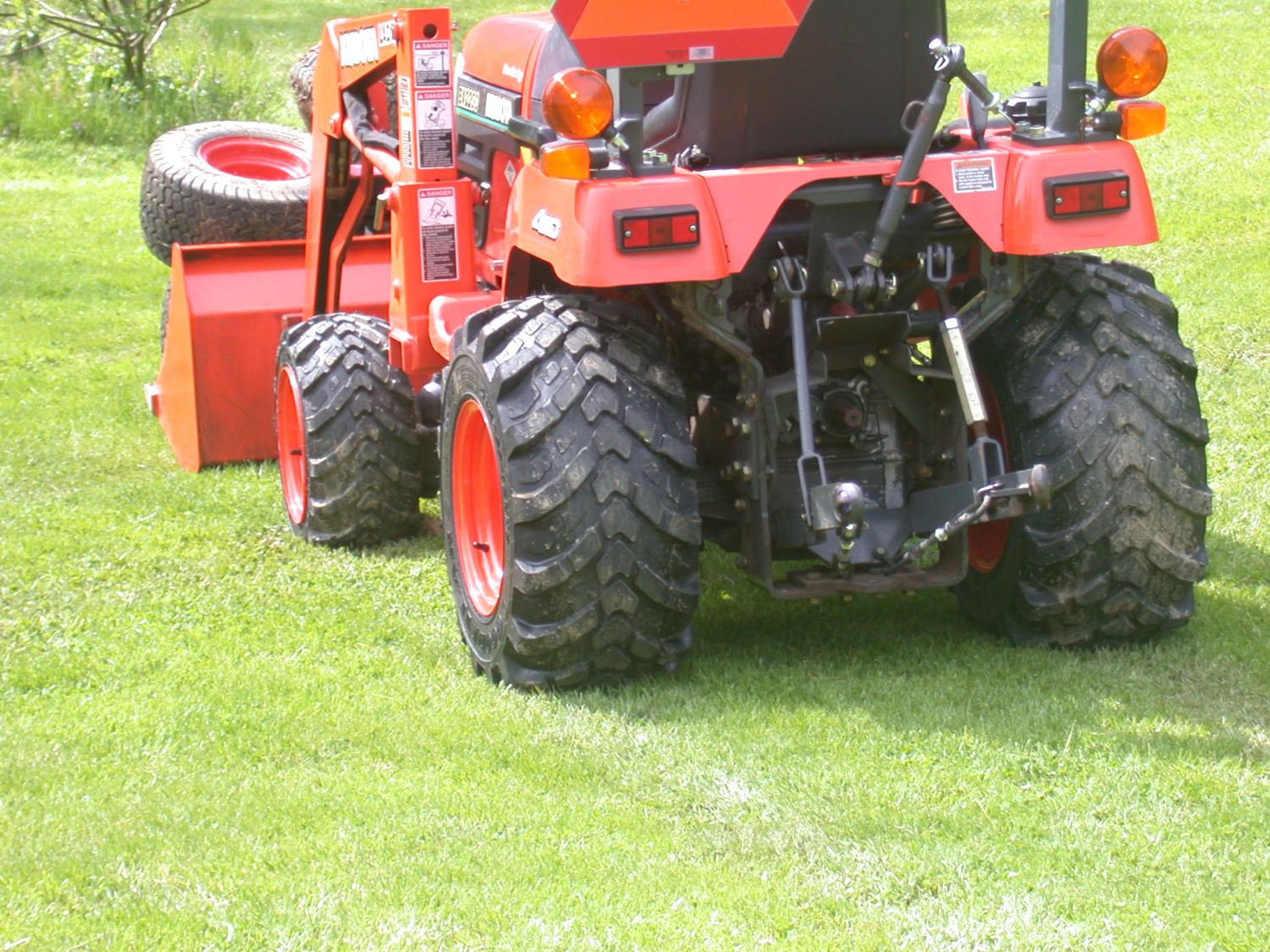

I really appreciate all the replies, checked all the obvious no problems found, then it dawned on me, I use a factory ballast bucket with 300lbs of sand bags in it, used that setup with no problems using original turf tires. Recently I changed over to R14 tires, great traction....however, they have a very high crown (peaked) I just wonder if this could be the cause of the problem I am encountering now...if so, then the turf tires are going back on.

What is the inflation of the tires, and what is the size of the tires? It appears that they might be over-inflated. Tires should sit flat across the entire tread when they are properly inflated. On the sidewall of the tire is the max inflation for the tire.

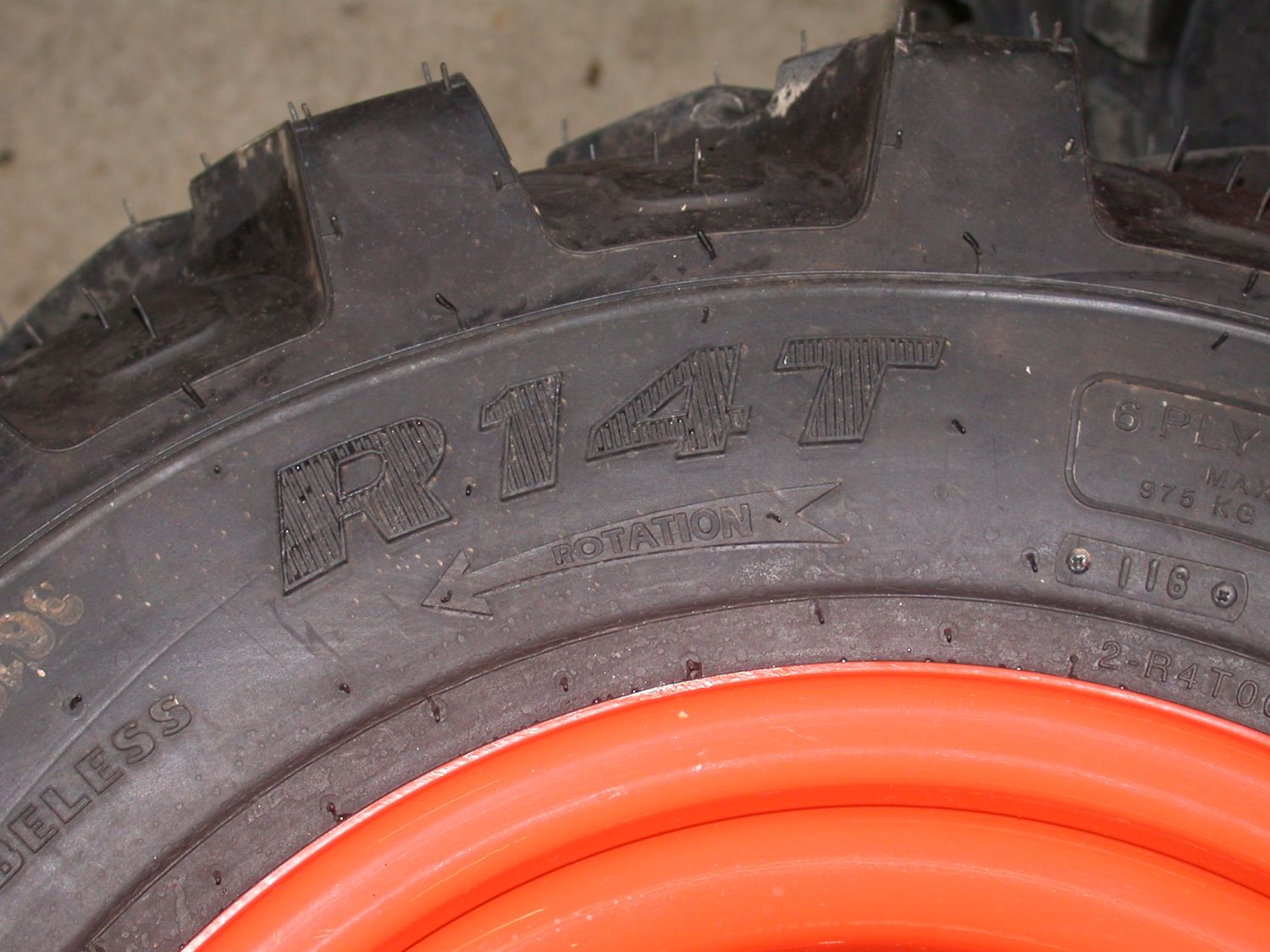

26x12.00-12 rear 20 psi, 18x8:50-8 front 22 psi 'that is the recommended spec for this new style R-14 T tire. That shape is normal for them.
About that 300 lb ballast on the back - how is your 3 point adjusted? It wouldn't take much in the way those lower link turnbuckles are adjusted to throw the ballast a few inches to one side or the other. Maybe just enough to change the center of gravity a little to the side.
