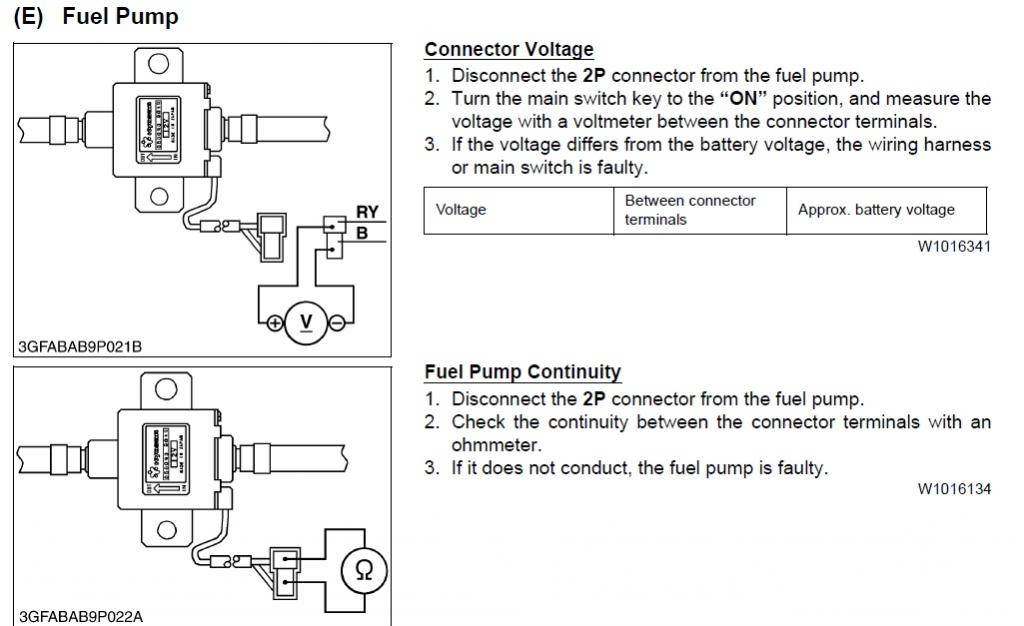

I do not have acccess to the Owners Manual. The WSM shows two fuses.
I expect they will be around the lower part of the dash.
However, I have attached the test procedure for the fuel pump.
First step is to verify power to the pump which would also tell if the fuse were blown.
Dave

I checked all four fuses (it seems only one actually does anything, the other three are for lights?) and all were fine. Which means I suppose I'm going to have to locate and dig into the fuel pump next? It lost power a little today mowing with a full tank this time.

Do you hear the lift pump when you turn the key to the on position?
Sent from my XT1710-02 using Tapatalk
10,016
6,819
When you turn the key, I think you should hear a “clatter” sound about under your seat. That’s the lift pump.
It’s located underneath, after the “first” fuel filter, kind of near the hydraulic filter (on my BX2360....don’t believe they changed much).
It’s a silver cylindrical pump with a mounting bracket, fuel line in/out, and electrical connection.
It’s smaller than a tomato soup can, and is just removed and replaced. No tearing into anything.
Cglaza
L2500DT, BX2380, G6200H
Aug 30, 2015
176
Freeland, mi
Yes you should. I'm wondering if he can hear the pump run and if he can then he should disconnect the fuel line and see if he has a good flow up by the engine. If not then he should determine if he has poor flow right out of the pump and if so if there could be a clogged prefilter. If the flow is still poor, then he should look into the fuel tank to see if he has rust flakes blocking the fuel outlet in the tank. He said his sender is not working correctly and does not keep his fuel tank full all the time which could cause the sender to rust and flake off. When he has these issues he should try blowing air into the fuel line to clear the blocked like to see if it temporarily brings back his performance. If it does then he will need to tend to that fuel sender I would think.
