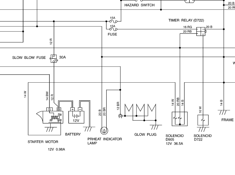

Here is what you need:

That schematic is confusing. Kubota attempted to show two schemes on one drawing. The BX2200 has the D905 engine, 3-wire solenoid, no timer, and power-to-run. The BX1800 has the D722 engine, 1-wire solenoid, stop timer relay, and power-to-stop.
As you say, there may be other schemes

Thanks for the diagram , I have seen it ,as he has a factory manual ,what is odd he got all these parts thru serial numbered order ,they sent the wrong solenoid , and he got a starter ,this starter looks nearly identical mounts perfectly, it came with a short white Jumper ? wire that is about 5 in. long and was connected to where the white wire is on the block side of Starter solenoid ?and loops to terminal where the black/White wire is supposed to go , It makes me wonder if the starter is different somehow ?, Or maybe that white jumper ties into the white harness connection ...its kind of hard to decipher as the white wire on the old harness had a complete meltdown ,and took out a lot of other wires

The white is out to the stop solenoid
The black white is starter solenoid in, it goes to a different terminal on the starter.
Disconnect the white wire from the connection on the starter, and connect the black white to that terminal.
Then connect the white white to the pull in coil on the stop solenoid.
It's just been done like that for shipping.
