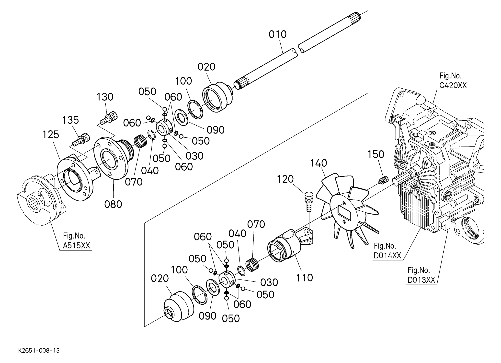

this is the BX2660 transmission drawing, The fan is #140, about $13 CDN. It's been said you have a PITA job ahead as driveshaft #010 has to come out, to get #110 off ? Others WILL know. I see that if #130 come off,then #080 should come down and forward and off ??
If you want a million bucks, design/make/sell a 'two piece- easily installed' replacement fan......
When you buy the fan, ask about a 'fan guard'. My 2018 BX23s came with it. While some use 'under armour', that has to come off when you mount the midmountmower....

You read my mind I was going to ask if there was an guard that would protect the fan from branches when the mid mower was off, or I could make one with some expanded metal. Yes hopefully it looks like I might be able to unbolt the front coupling and drop the drive shaft down

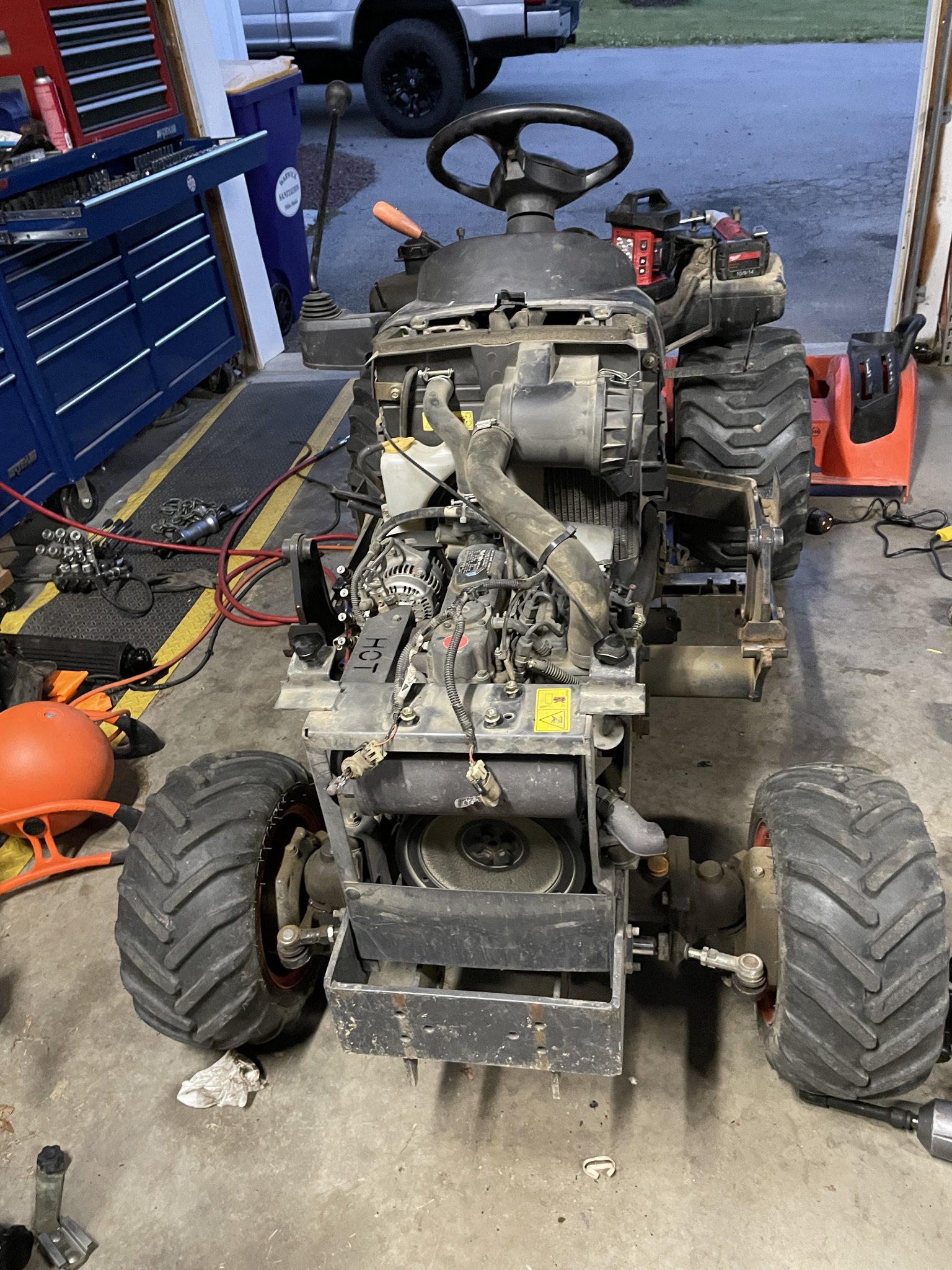

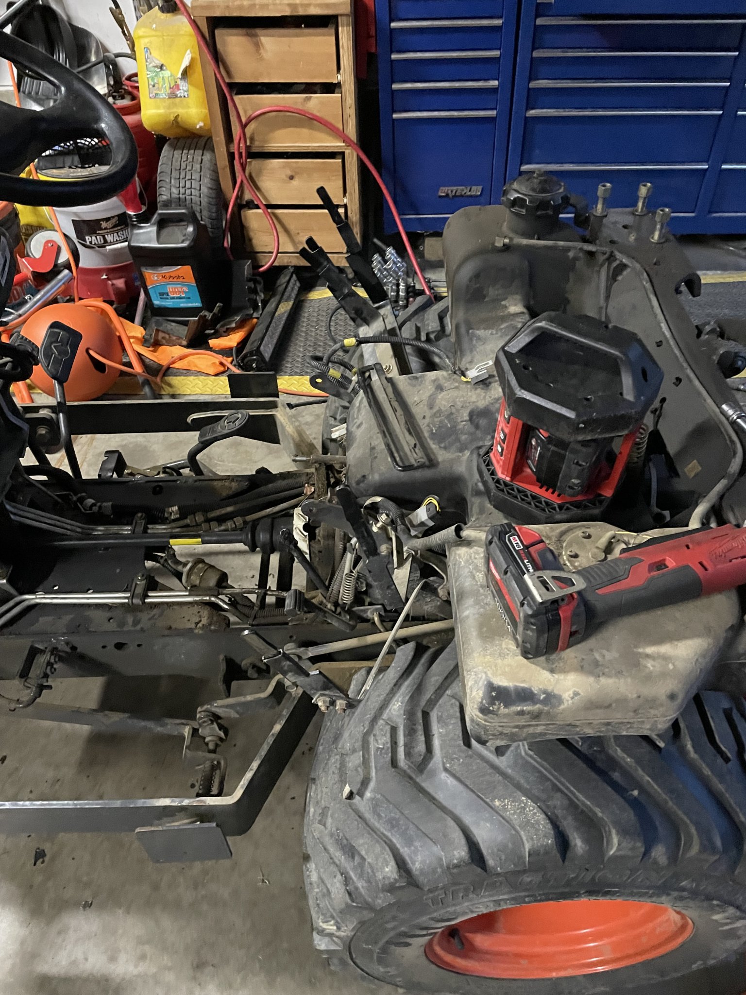

Did that repair myself...
Fan was 8.99USD and I had to take the tractor completely apart. ROPS, seat, floor pan, engine cowling. I even had to raise and move the engine 3 inches to get the driveshaft enough room to move...Here are some before and after pictures...
WAS BANNED FOR NSFW PICS
6,518
5,149
On my BX22 all I had to do was remove the floor pan and I was able to get the shaft to the right and upward.
