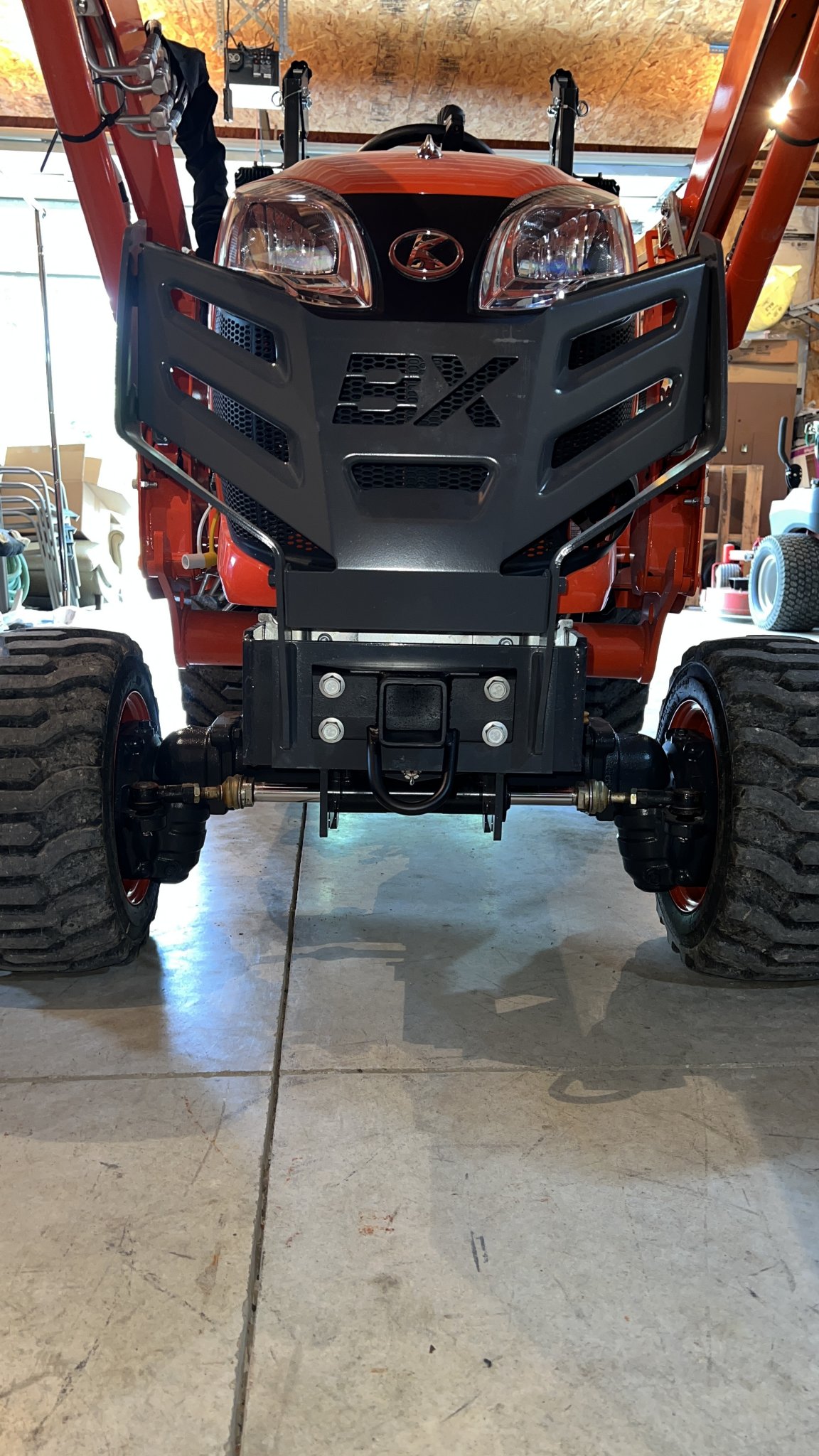

Have a BX2350 need to put weights on the front end , I also have a grill guard. Do I need to remove the grill guard to put the weight bracket on or is there a work around ?

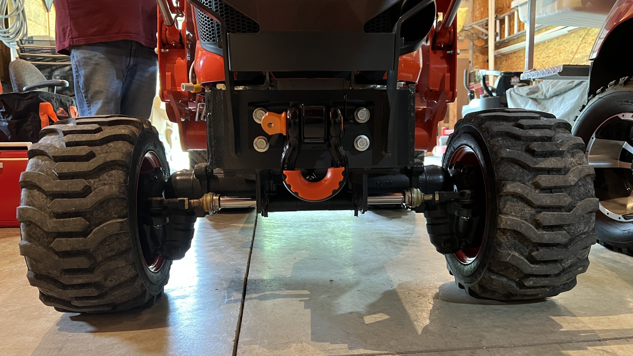

Just got one off an eBay seller.. nice product.Excellent work around. Mount one of these then get the weight hitch bracket. Then add weights. Pricey but EASY.
Front Receiver Hitch for Kubota Sub-Compact Tractors | Heavy Hitch - Compact Tractor Attachments

I was able to use longer bolts and a couple of J bolts to secure the Kubota weight bracket in front of my grill guard.Just got one off an eBay seller.. nice product. View attachment 82589 View attachment 82590
I really like that set up.. looks like a really well thought out design.
Nice work!the brush guard is from "Earth & Turf" in New Holland PA, and the little bracket I just made from a steel scraps, its just a box that gives the 40lb weights something to grab onto. It was compact and worked well
Where did you get the weights? They are a lot nicer the front kubota weight I have, and look like they are shorter then the suitcase weights I currently have.
Best part about it!But they are not green!
I'm getting a BX next week and would love setup these. weights. They are very plentius on E-bay as well.they are the standard 42 pound weights from deere, they keep them in stock, so you dont have to pay for shipping.
