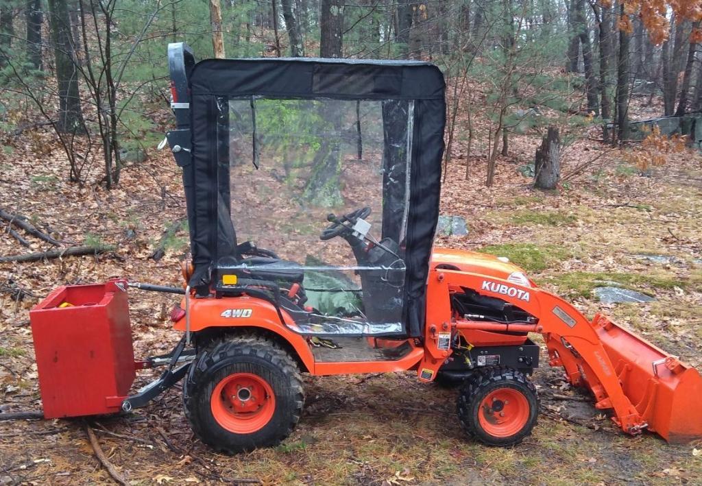

Even a cheap vinyl cab would do more to keep you warm in the winter then trying to reverse the fan blade.
Keeps the wind and blowing snow off you.
