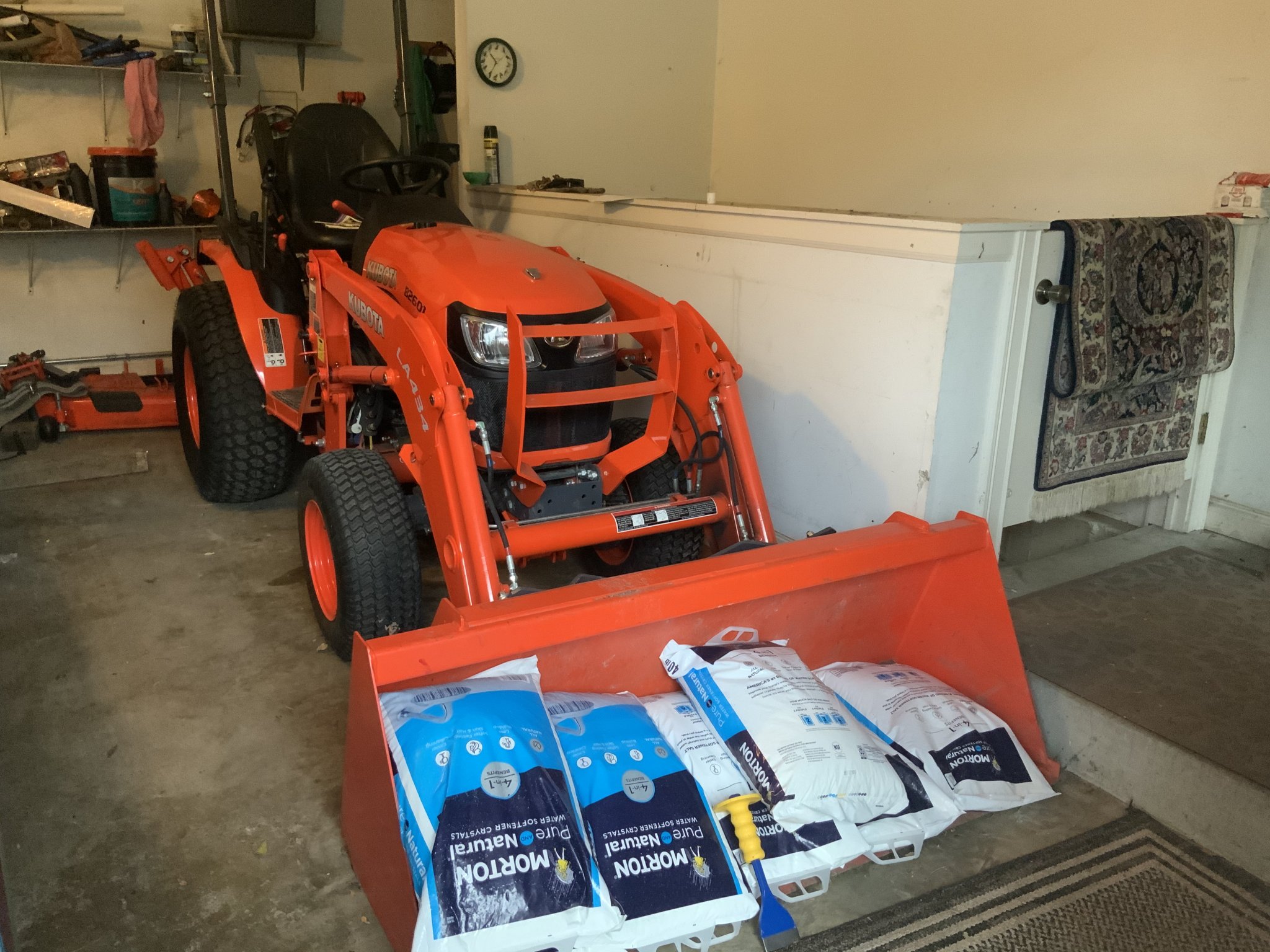

I have the SSQA material bucket on it now. Backhoe with 12“ bucket and a 60 inch deck. Takes up a spot in the garage, buckles the flag stone paths around home. The 54 inch deck would fit around obstacles better.
want diesel for safety and longevity.
Haven’t used it to mow since we moved here. Moved snow a couple times and move bags of stuff here to there. Old dive way was 1300 feet, new one 80. 5+ acres then, 2/3s now with many more tight places. Not gonna be running anything off the pto, sold box scraper, grader blade, snow blower, log splitter, post driver and rear pallet lift with L2250 when moving. I think I’m leaning 1880.
