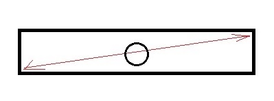

Also, the blade length is measured "diagonally" (like a TV screen) so that might explain the 1/4" difference you noted.

'Bumpkin" can you explain how to diagonally measure a straight piece of metal? I take your word for it but visually I can't figure it out.
15,122
4,258
From out side edge to out side edge,,, like you would if you were going to square up a drawer or posts for a build go from one corner to the opposed corner

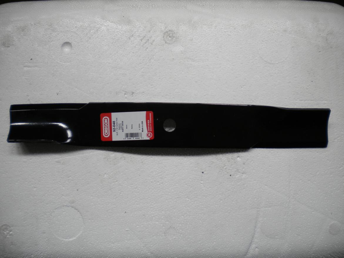

The new Oregon blades that I got are not a straight cut at the ends of the blades. They are cut with a slight diagonal cut. This is the reason that they have to be measured from end to end. This is the first set of blades that I have ever seen like that. I'll take a picture and edit this post with the picture when I go out to the shop a little later.
The new blades I got are not measured like the old blades I just got. Even though the new blades and the old blades have the same part number, the new ones are measured from the tip of the left cutting edge diagonally to the tip of the right cutting edge. The measurement is 18 9/16th inches. If you measure from the tip of the left curled end to the tip of the right curled end, the measurement is exactly 18 inches on the new blades. The old blades are measured straight across the center hole from left to right and the measurement is 18 9/16th inches. The old, straight cut blades should not be measured diagonally.
This means that the new blades will get progressively shorter each time they are sharpened. This will result in lines of grass that will not be cut between the blades. This is a crappy deal for us because we will have to buy new blades more often. Especially for those of us that have rocks growing in our yards.
