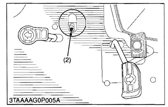

There is a zerk fitting that is accessed through the floor. A small flap of the rubber mat is cut out to allow access, but it's not obvious at all. Can't hurt to check that.
It's to the right of center, and just forward of center. This is for a BX25. Other BX models should be similar.
Thanks Mark_bx25D I'll check with him to see if there's one there and if he greased it.
