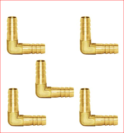

I used the RACOR method - during the spring last year I decided to take the "diesel bath."
It was not too bad - I had all my goodies ready to go too.
New 5/16" - 8mm fuel line - ordered a ten foot section - used about 5 feet as I recall.
Bought some
5/16 barbed elbows - got a 5 pack cheaper than I could buy a single one -almost!
Bought some fuel line hose clamps - did not want to use the "normal" clamps
Bought some 1/4 - 5/16
barbed adaptors too.

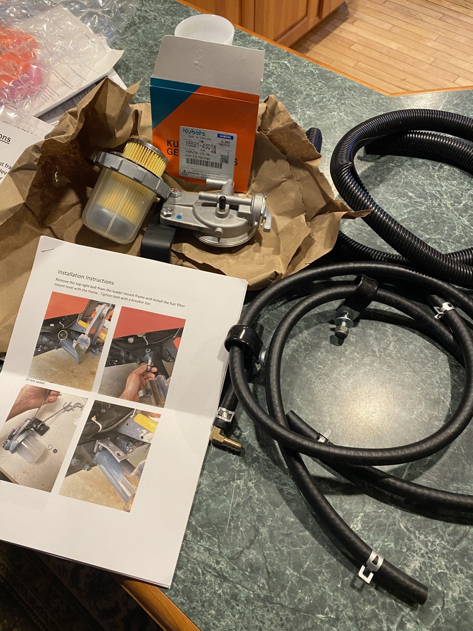

Just an update.
I ordered the Kubota BX Fuel Filter Relocation Kit (bxtractorparts.com) offering and it was delivered today. Gosh, only took a couple days to show at my door.
It has the one filter and mount to replace the rear filter.
It's a neat kit, and the instructions are a bunch of detailed clear, color photos with annotations of a BX23S.
It's essentially a Racor-like program, but uses a Kubota mount and filter.
The kit has all hose pre-cut with fittings and clamps ready to go. Also has loom to run everything in, as well as well zip ties as needed.
The kit came with the Kubota filter box for reference when it's time for a new filter.
Could I have done this without the kit?? Sure I could have.
For me to figure out the routing, fittings, etc., and then out-source all the parts, takes time. I don't have a lot of free time.
I think it's a good option for $200. So far, I'm pretty happy with it...pretty good kit.
I hope to put it on between snow and mowing seasons this spring.....sometimes that's only 2 weeks.. so we'll see.
I will likely add a shut-off in the line before the lift pump, as well as fabricate some kind of "shield" in front of the filter as others have done.
The Kubota filter assembly you have in the picture has a shut-off built into it.
What do the instructions show to do with the small bleed-off port?
